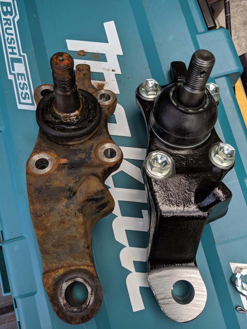

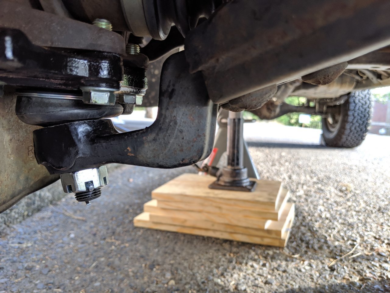

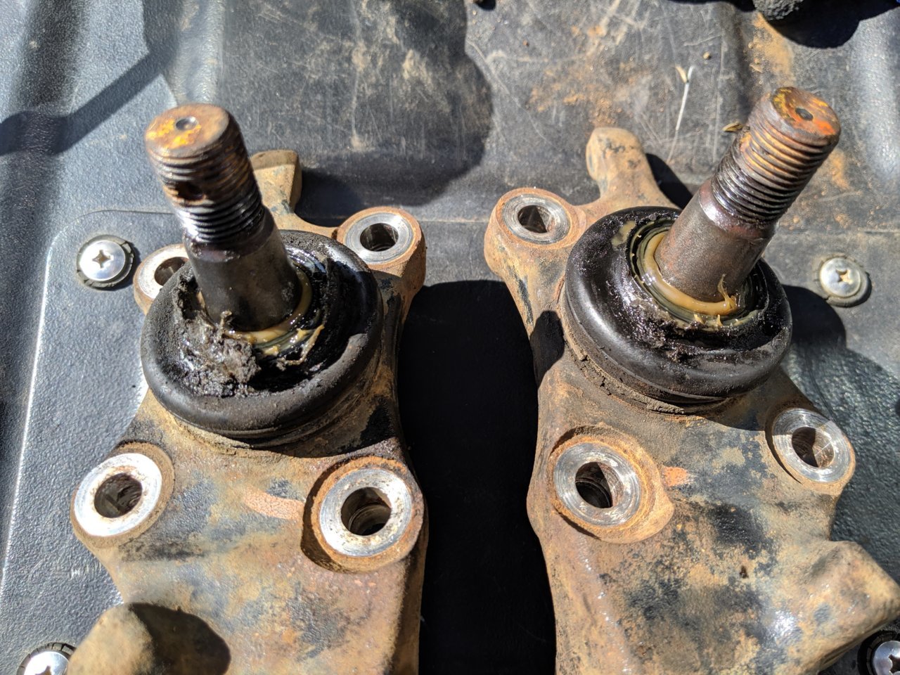

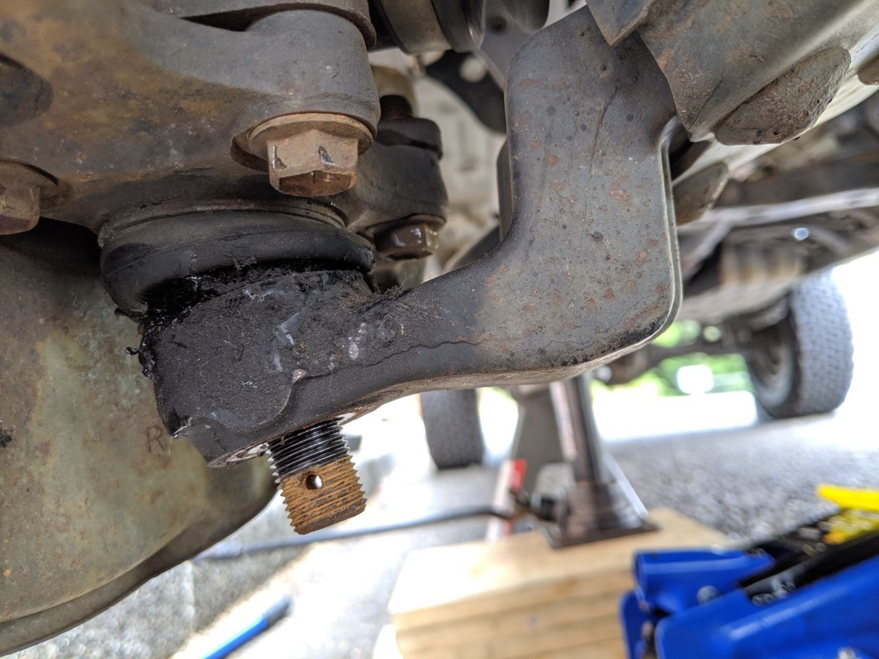

    Follow up for posterity: the boots were shredded and pissing grease but there isn't much play that I can detect by hand. Either way, the piece of mind sure is nice. Thanks for the advice y'all!

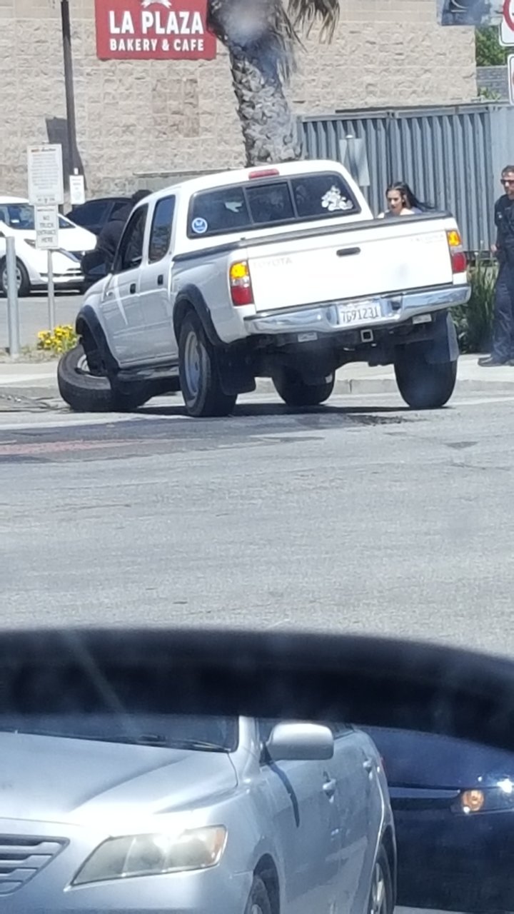

    Not arguing but where did you see this?
    Running Board Man likes this.
  13. Jul 29, 2019 at 8:50 AM
    #73
    Kwikvette
    Feb 27, 2019
    #284735
    80,433
    Fresno County
    4 run, 2 don't
    Here's one I took back in April; was wondering why there was a hold up at the intersection -
    Jimmyrace and GQ7227 like this.

    Google it and you’ll find a zillion photos of 1st gen Tacomas and 3rd gen 4Runners with broken LBJs.
