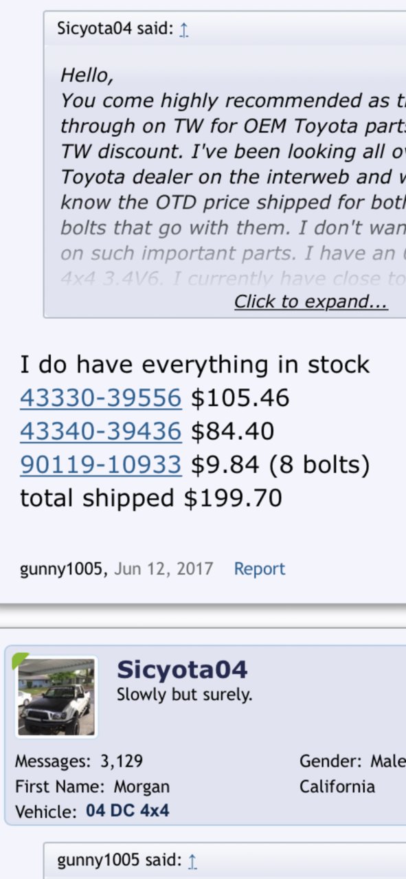

    Here are the ones Gunny from Camelback provided me. But he had a separate number for the bolts. Maybe that’s the difference? The other numbers come with bolts

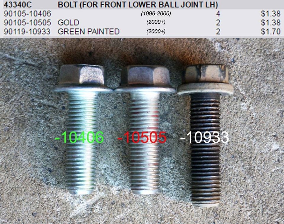

    The rubber boot you refer to is a LBJ Protector 43346-60011, often referred to as a dust boot. It is a separate part from the LBJ. If it is in good shape, it can be reused if you want. And when using the LBJ Protector, you need to use the longer black bolt w washer 90119-10933. That is the reason I specified the 90080-10066 part number of the flanged bolts included with my LBJs above. 90080-10066 is simply the superseded p/n for the 90105-10406 flanged LBJ bolt. Those flanged bolts are not designed to be used with the LBJ protector which was factory installed on TACOs starting in or around Sept 2000 IIRC. The 2 LBJs I show in my post are correct for my '97 TACO because it did not come from the factory with the LBJ Protectors and I have not retrofitted them to my LBJs. But the LBJs I show are not exactly correct for your 2001 because of the flanged bolts included. That is probably why the camelback website flagged them on you. If you want to eliminate the LBJ Protectors, then you can use the flanged bolts supplied with the LBJs I show in my post. Everything I read indicates that the LBJ attachment is stronger with those shorter flanged bolts torqued to 59 FT./lbs. If you want to retain the LBJ Protectors as installed by the factory on your 01 TACO, it appears that you need to order the LBJs without the bolts and purchase the 90119-10933 longer black bolts with washers separately. Look at Sicyota4's post above. That looks to be the exact parts you need for your 01 TACO. Check it out with camelback, toyotapartsdeal, or whoever you buy your parts from so you get it right the first time. HTH.
    Info on different LBJ bolts: The different LBJ bolts and why it's important, Prado 90 Series — Mighty 90s Forum

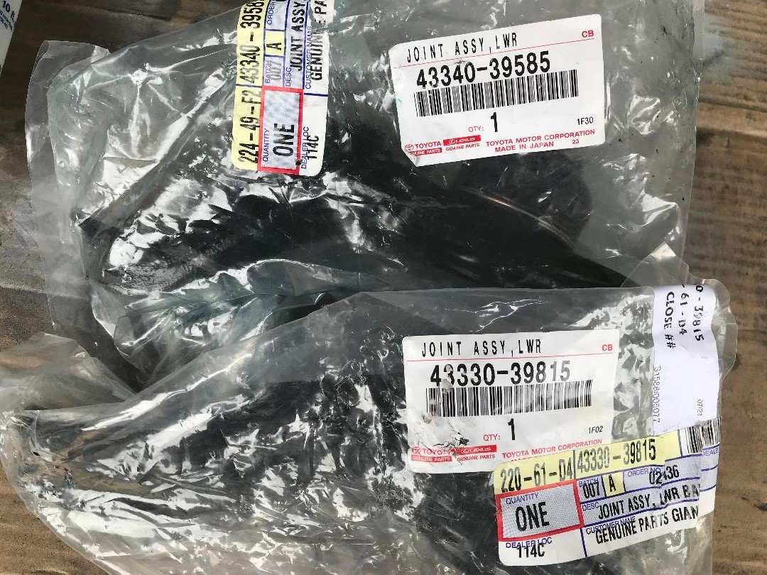

    OK, the links really helped. I was misunderstanding what the dust boot / lbj protector was. I do NOT have these on my current ball joints and have the flanged bolts. So I am going to order the 43330-39815 (left) & 43340-39585 (right) that come with the flange bolts, castle nut, and cotter pin. Install them with a dab of blue loctite and torque them to 59 ft/lbs.

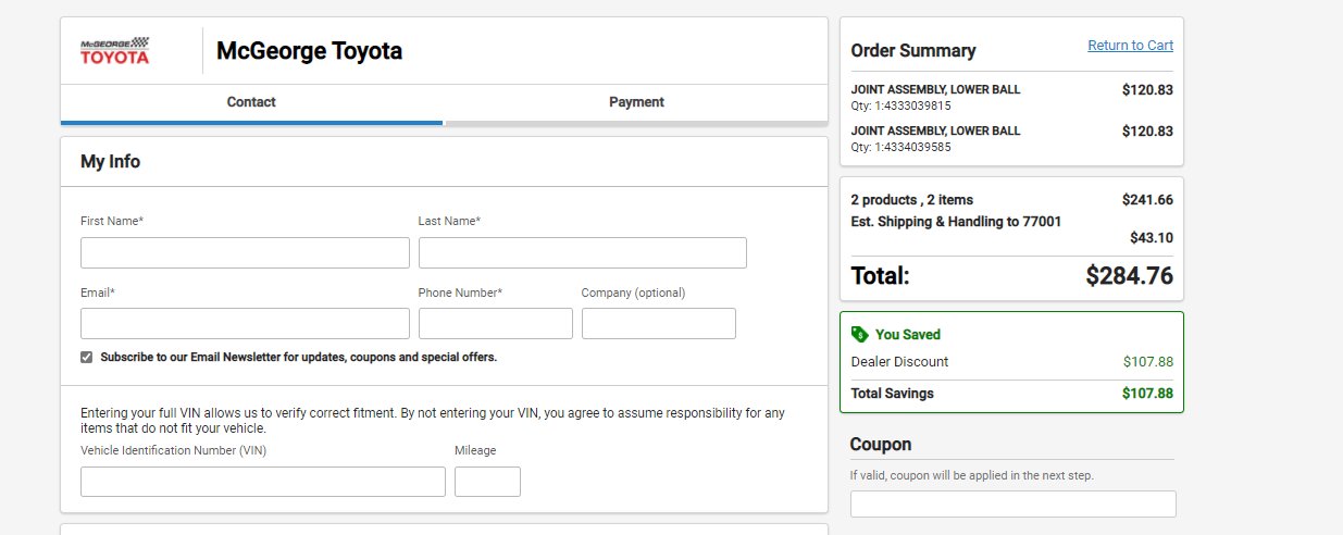

    Not sure if it helps any, but McGeorge Toyota's online website has better pricing than most and free shipping:
    https://toyotaonlineparts.mcgeorgetoyota.com/
    (May not be as good as Camelback...not sure)

    Thanks for the tip on McGeorge. If it helps anyone in the future, price at Camelback was $126 plus shipping.

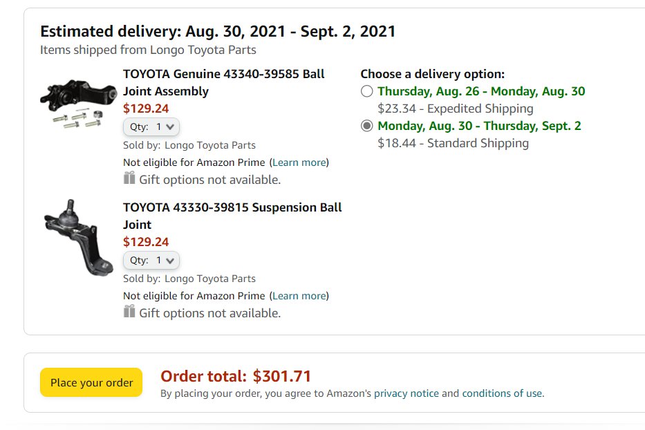

    I'm doing my homework and comparing my options. Shipping seems pretty high.
