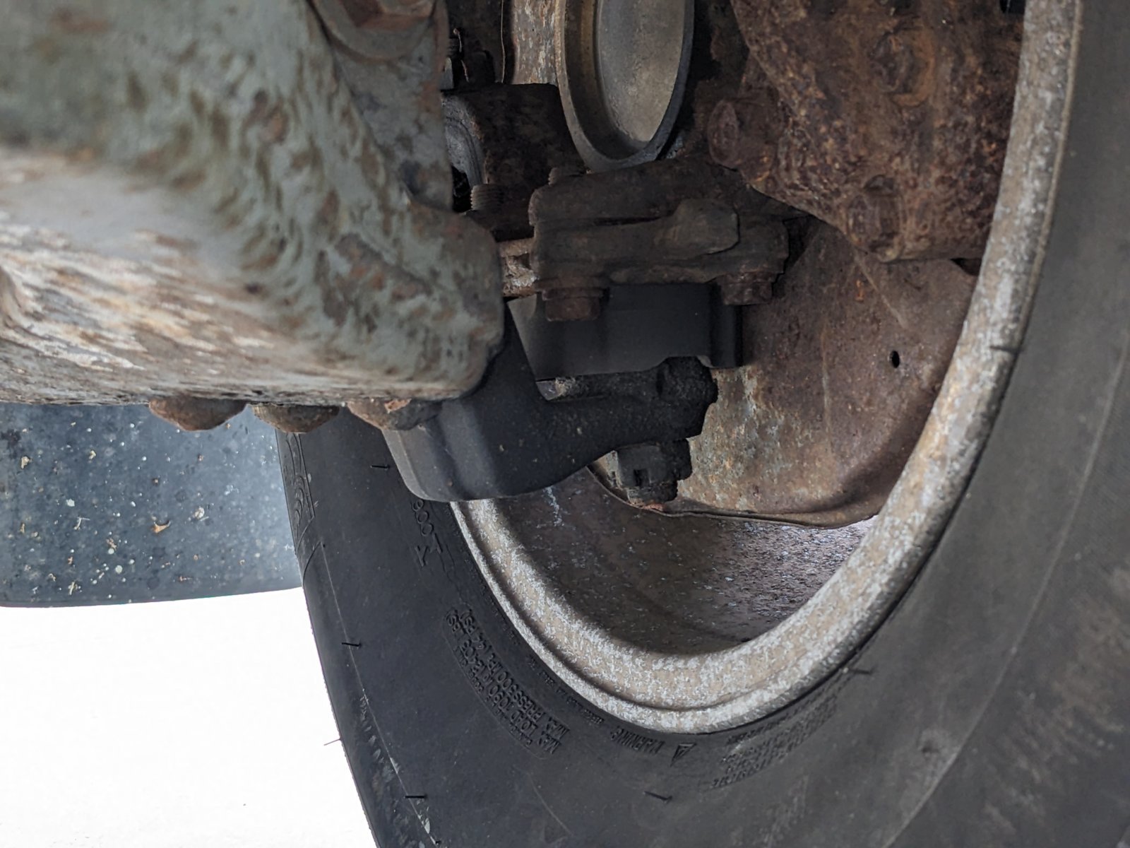

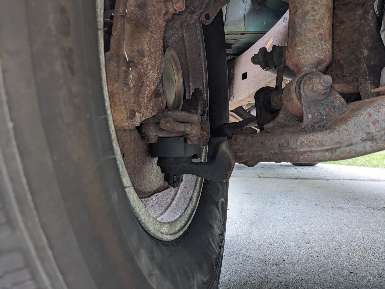

    Took a couple pics of the existing LBJs, yeah those calipers and struts look crusty but they work, a fix for another time...
    Am I crazy or are there no cotter pins on those castle nuts?
    What in the wild wild world of sports? :eek:
    Also the OEM parts I've priced only come with new castle nut and cotter pin. Not the 4 mounting bolts per LBJ.
    Are the original mounting bolts generally re-usable?
    If not, where can these be found?

    One Might?? Have a cotter key pin, other one does not
    And that is dangerous, those castle nuts can work themselves loose off the torque spec

    I just spotted your LBJs do not look like mine
    You have a spacer like looking cup that I do not
    Is it for the tacos with 16" wheels? I have 15s
    Perhaps those with a spacer are not as long lasting as those LBJs without that?

    Not a spacer- just a rubber dust shield. Can be installed with or without them.

    The flanged head biots do not use a washer. The boots require a bolt with a washer which your original bolts have.
