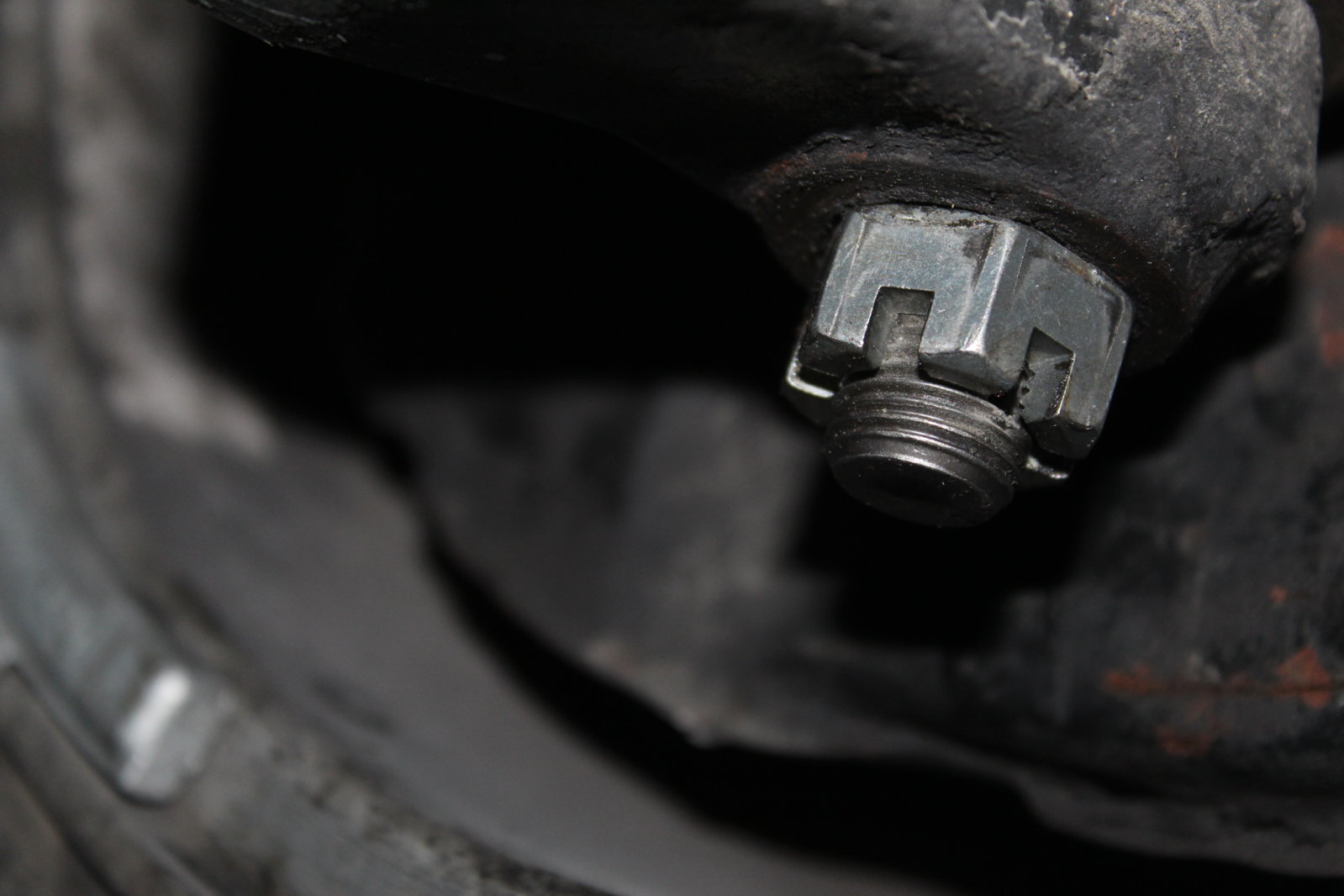

    does This look safe?

    nope unless its using Bluetooth cotter pin :)

    that is hand-me-the-F-quality-job-done-right from ASE certified Firestone techs when i needed emergency CV axle replacement from a severe boot rip
    it took me awhile to fix their FckUp after i got back home to inspect
    the castle nut they failed to re-cotter key on the driver side actually walked back the proper torque by several inch turn of my torque wrench after picking up new pins
