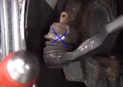

    If you do have to hit it @Monkeyman - hit it here
    If you can, snap a pic with your phone and share it. Let's see what you're dealing with.

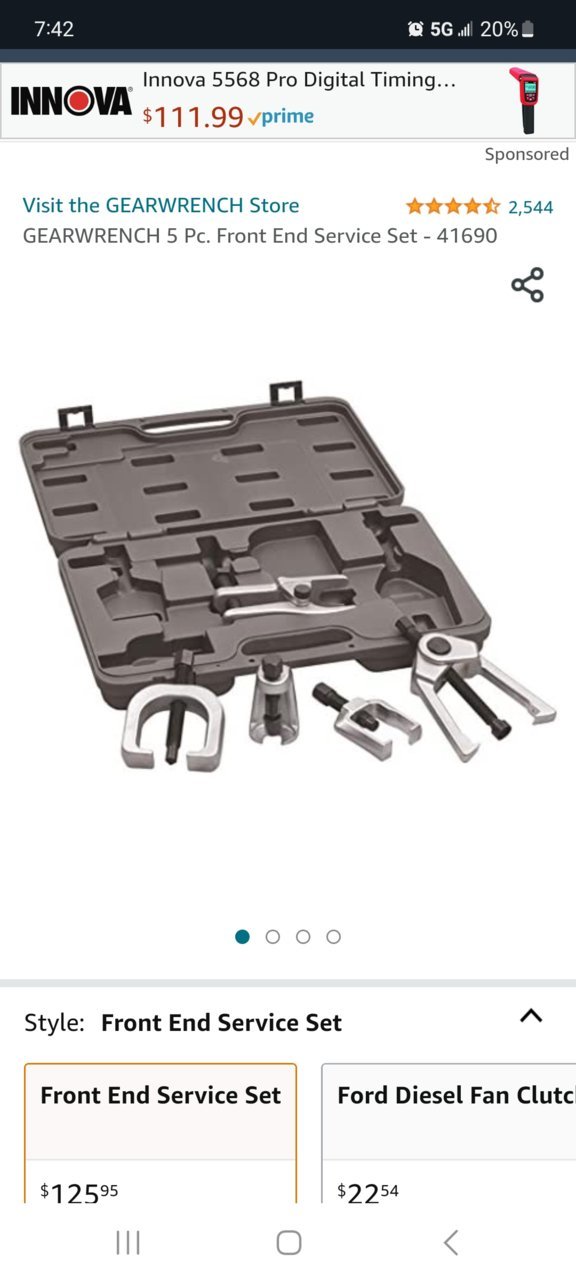

    Buy this

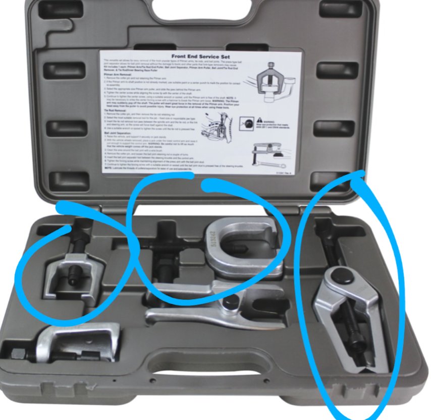

    @Monkeyman
    Any of the ones circled in blue will do the job. I usually use the one on the left. This last go-around, I used the one on the right. As long as you're careful to not damage the boot, these will work.
