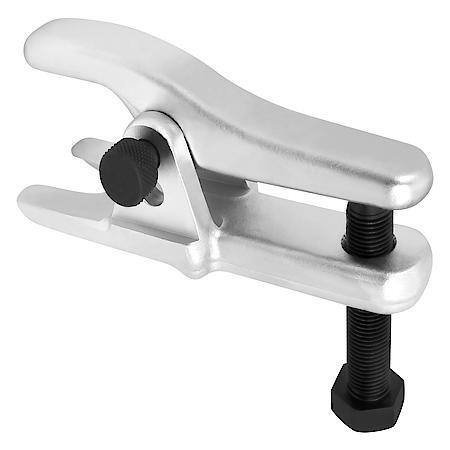

    Here's the easy way to do it.....everybody sells this tool now....

    If you've got that tool....I'd just shoot some penetrant....
    pull pressure on it with the tool and then tap with a hammer...
    it'll pop loose.....with a bang.....careful......

    That tool didn't work worth a shit for me. It chipped off a piece of the threaded material and did something else that made the tie rod unusable but I can't remember exactly what. Took all my strength too. It was the one from Harbor Freight. Cost me another $45 to buy a new tie rod.

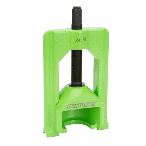

    I got the silver one from advance and its been a champion for me....best $27 ever spent....
    Probably got couple doz successful kills on mine....
    I'd put it right up there with one of these......made life so much freakin easier.....
