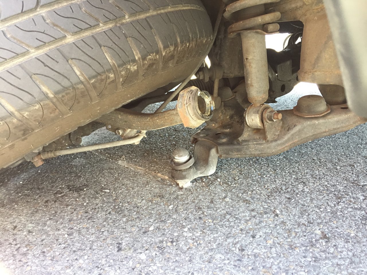

    This shit was crazy. I'm just glad I was going slow while it happened and that I narrowly avoided any body damage due to the tire slipping under and cushioning the frame. I've checked and my vin isn't covered under the recall due to it having been made a month late...
    I'm going to raise hell at toyota though and see if any luck.
    Happened at 125k on a 2001

    That sucks, you need to replace these ball joint every 100,,000 just like the timing belt to be safe with OEM parts, better to be safe then sorry,

    Did you mean kilometers? Because 150K miles is too many miles even for OEM ball joints. And don't cheap out on this item when you replace. Only use OEM ball joints and replace them every 90-100K miles.
    It might make you feel better yo yell at someone right now because what you just experienced is scary shit. But I don't think it'll get you anywhere with Toyota. The underlying issue is the design of that part of the suspension. You just gotta know that the LBJs are a wear item that you change out regularly. It is no different from wearing out tires in a way. You would not blame Toyota for that would you?
