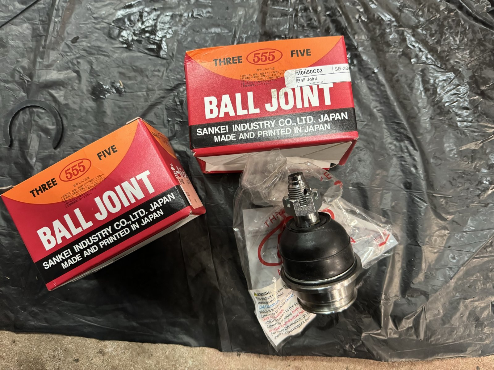

    Not sure if they are fake or not (seem legit) but I sourced sankei 555 (claimed OEM) LBJs for my 4Runner off of partsgeek, not sure if people have had problems but I had no issues with my experience.. they may have yours as well..
    also I’ve yet to swap them so no feedback in that sense..
    GingerSasquatch and Rob MacRuger like this.

    Little bit of a side question but does anyone know how to find the OEM upper ball joint model number? I'd like to get a set of Sankei 555 replacements but can't find them online anywhere. Oh, and this is for a 2005 base model 2wd regular 5-lug.

    Yeah, that's possible for the 1st gen. Unfortunately for the 2nd gen and up they only off complete upper and lower control arms pre-fitted with the ball joints. They are not available for sale separately in the US or even listed on the parts diagrams.
