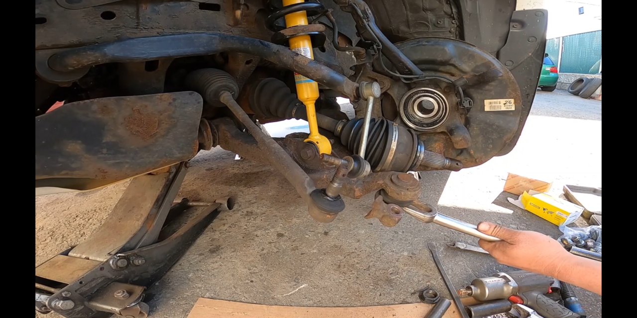

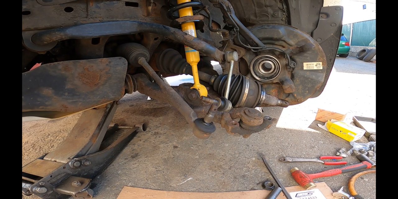

    Hey all,
    I went to do my lower ball joints today, and I could not for the life of me get the steering stop bracket to separate from the ball joint end, first I used a pickle fork with a hammer and it would not budge, I went down to AutoZone and try to use their ball joint separator tool but it kept slipping off. I hammered and hammered and hammered away at different parts of the bracket but it still would not budge.
    Can someone recommend a good way to get the bracket separated from the lower ball joint? Perhaps a special tool I can rent from an auto parts store?
    I have the ball joint Master service kit from advance Auto parts which should get the ball joint now of the lower control arm but I'm stuck at getting the steering stop bracket off of the ball joint.
    Here's a picture of a video I found on YouTube not my truck but it's where I'm stuck.
    Unfortunately I had to put everything back together, I'll need to try next weekend any suggestions thanks in advance.

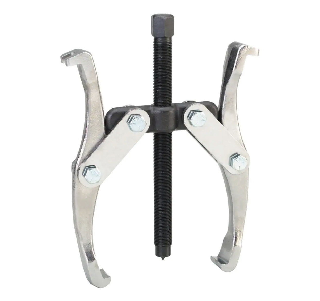

    If that doesn’t work, maybe a 2 jaw puller upside down with the forcing screw pressing into the ball joint

    Leave the bracket attached (bolted) to the knuckle. Then hammer on the ball joint with your pickle fork. The way you have it (free floating), the ball joint flexes (moves away from the impact) when you hit it. It takes several really good wacks to break it free. Got a 3 lb hammer?

    When I did mine, I did not have to disassemble as much as in the pics.
    Try this. When you start over again … after removing the wheel, back off the BJ castle nut about half way. Bolt up the rotor and use the jack to lift it upward, about an inch, using a 2x4 under the rotor. This puts some tension in favor of separating the BJ. Strike the side of the BJ with progressive force; this should separate it and the castle nut will prevent the LCA from swinging down too hard. After that remove two bottom bolts and the tie rod to swing away the knuckle. You don't have to remove the CV shaft. PM when you plan on re-attempting this and I’ll see if I can swing by.
    The one issue I had was separating the BJ from the LCA. My BJ Chinese-made C-clamp could not remove the BJ. I had to use the C-clamp in conjunction with an air hammer to push it out. A couble sledgehammer blows on top of the BJ should do it also.

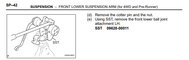

    Here's the FSM recommended method, I now recall helping a friend when I did one, I took the whole LCA off, put it upside down on a vice with the steering stop resting on both jaws, and then smacked the ball joint threaded portion until it separated

    You need to keep trying various pullers like the one 6 gear posted
