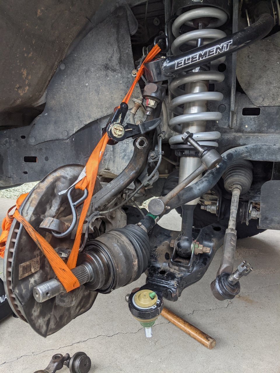

    The steering stop can be tricky because it's asymmetric, wider on one side of the hole than the other. Many pullers will slip off. I ended up using a wiper arm puller with another C-clamp to prevent the jaws from spreading. Put the castle nut on backwards a few threads to give the puller tool's forcing screw more surface area to push against.

    As mentioned. Re-install the 2 bolts that hold the steering stop into the knuckle/spindle. Put on a ball joint separator or the pickle fork you have, so there is pressure on the joint. Then hammer on the stop and/or knuckle with a 3lb sledge or bigger. It will separate. Have done a dozen of these or more.

    ****Update****Thanks for all the suggestions and support. I took another crack at it today and the ball joint replacement was successful.
    Lessons learned, Big hammer is needed, used a 40oz hammer and pickle fork and it came right off.
    Swapped the ball joint and I'm back in action.

    For potential future use, I ended up just hammering it with a sledge from the side. Kept it all bolted together, but loose. Hammered it off from where the steering stop hits, the unbolted the rest of the way.
