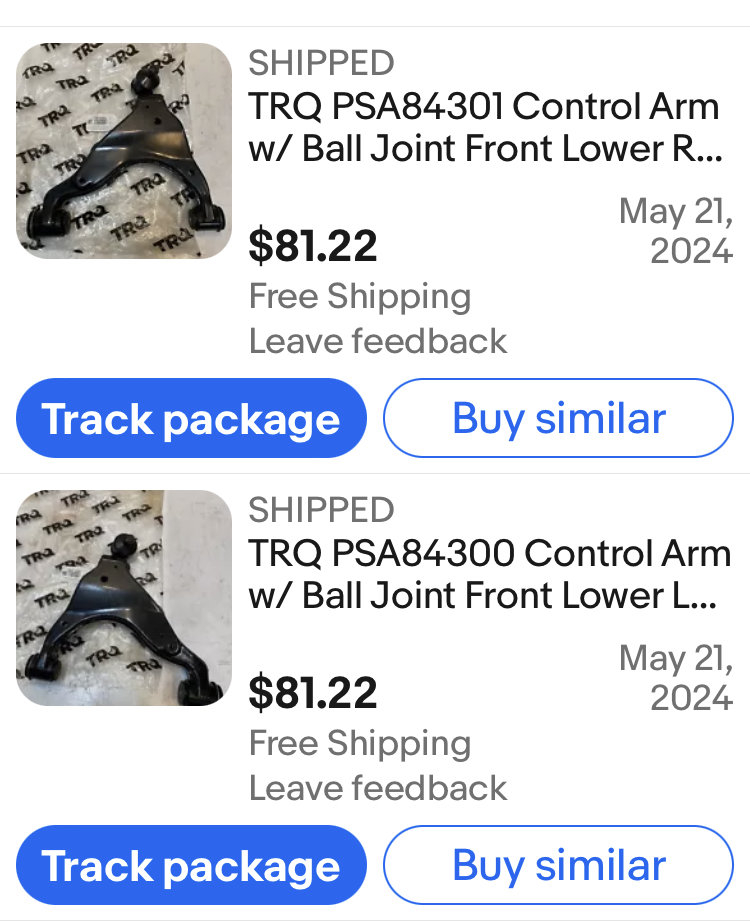

    IMG_7851.jpg That’s insane. I got these TQR off EBay and swapped them in 3hrs.
