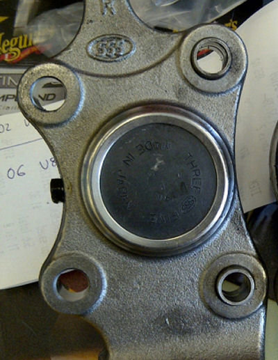

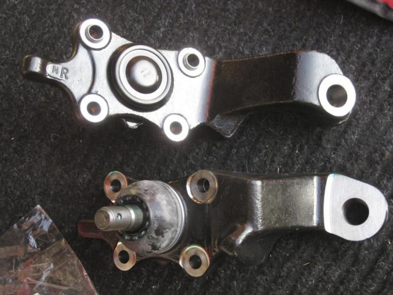

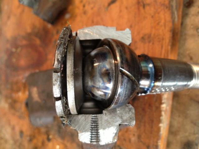

    Moog outsources their 1st gen joints from Sankei "555" the manufacturer of Toyota OEM joints. The issue is, the 555 aftermarket parts are a cut rate, significantly inferior part compared to OEM. Thanks to deceptive advertising from companies like Lowrange Offroad many folks think they are the same.
    Edit, Sankei likely is not the OE manufacturer. However that's merely trivia. The important take away is OE joints are the only joints made to Toyota specs/design regardless of aftermarket "claims".
    There is OEM, 555 aftermarket and Chinese no name "bastard joints". All the big name aftermarket companies like Moog are selling the relabeled 555 parts as their "premium" grade and the Chinese bastard joints as "economy".
    What's the difference?

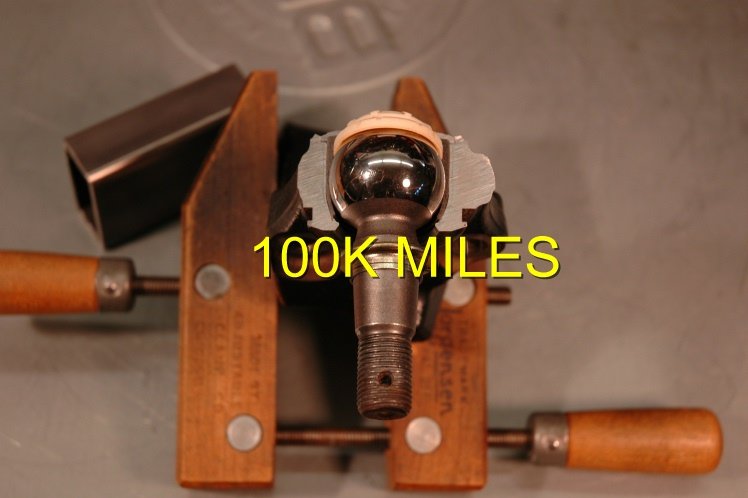

    OEM and aftermarket 555 joints are nearly identical on the outside but are totally different technologies on the inside.
    OEM uses a mirror polished ball running in a PTFE liner (or something like it). The initial lube at the time of manufacture "conditions" the liner and no further lubrication is needed for the life of the joint which averages around 100K (safe) miles. Additionally the mounting surfaces are machined contributing to a solid "bolt up".
    Below is an OEM joint after 100k miles. It is worn out by the Toyota spec of .020" max play, yet it is no where near wearing thru the liner.
    Machined mounting surfaces.
    The aftermarket 555 joint uses less costly old technology metal on metal that requires frequent lubrication and the mount surfaces are not finished.
    Facts and tid bits
    First off it must be understood that the 1st gen joints are in "tension", a constant state of trying to "pull apart". This is not an ideal design but it is what it is.
    The OEM joints are far from the weak link in the IFS, they are plenty strong enough.
    There are 2 types of catastrophic failures, separation of the ball from the socket and loosening of the 4 mount bolts.
    Separation of the ball comes only after the joint has been pushed way past it's intended service life. This is usually the result of ignorance of the proper diagnostic method and/or negligence.
    The 4 mount bolts loosen then shear or fall out all together due to improper installation. Clean mount surfaces/threads, new bolts, thread locker and 59lbs torque are imperative. Particular attention must be given to the inner 2 threaded holes of the spindle. They have less than the ideal amount of threads and can easily strip or be compromised by corrosion.
    Grease seeping from the boot does not mean the joint is bad, it's normal.
    You can not check the joint by shaking the tire.
    4Runners do not use the same joints. They come from the factory with lighter duty joints using a lower torque value for the 4 mount bolts (source of the torque value confusion). They are interchangeable with Tacoma joints and it's considered a routine upgrade.
    How to correctly check the joints should be a thread in itself.
