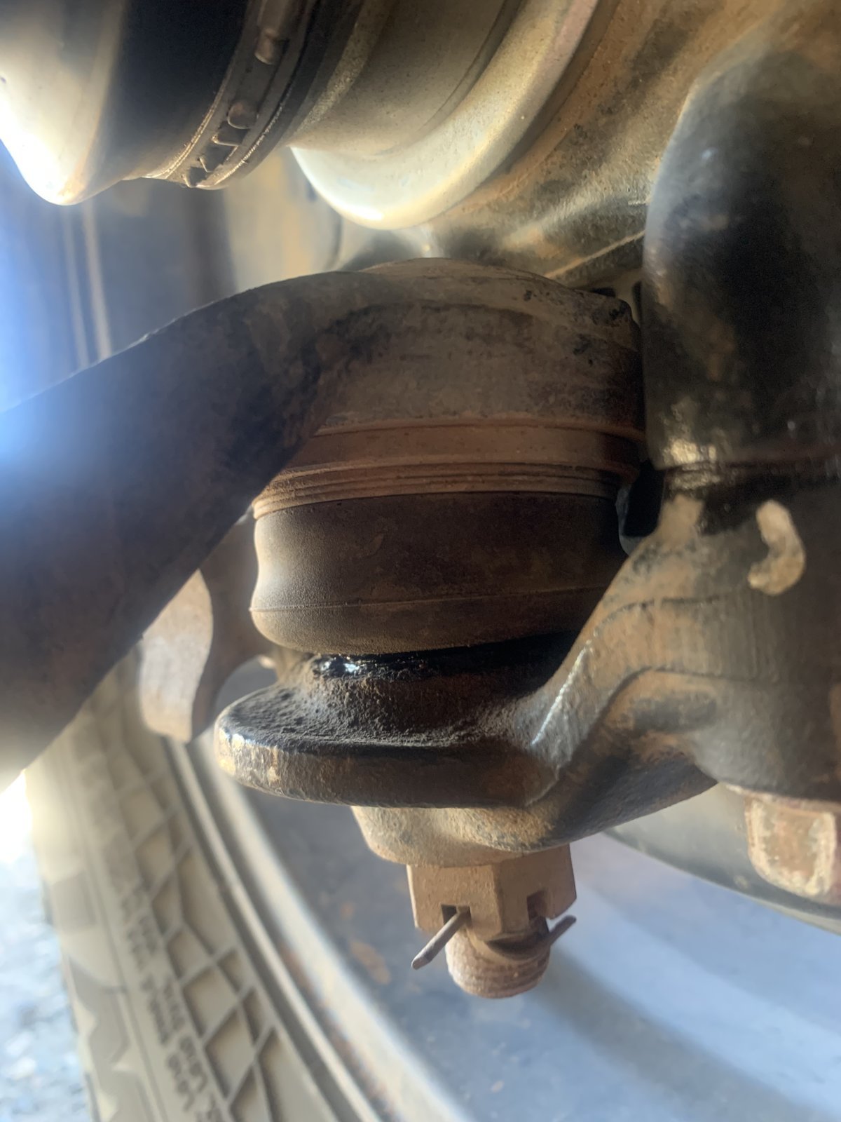

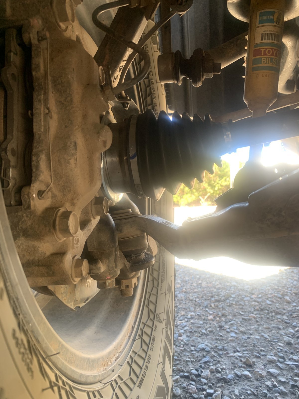

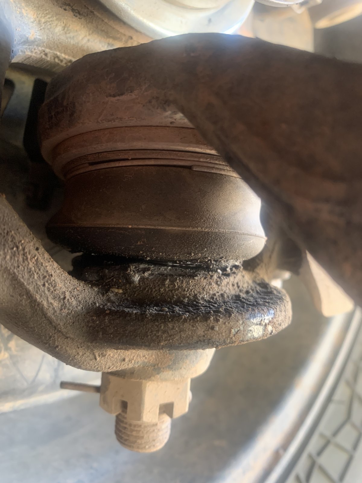

    Complete novice here. OEM lift on my 2018 TRD Off Road 4x4. Looks like I have a bit of exposed grease on my lower ball joints. Is this normal?
    Also, is the angle the ball joint is bending at normal?
    Thank you!

    Its very typical for Toyota trucks after 5 years or so. I'd document it and check it on a customers truck, but I certainly wouldnt sell ball joints based on appearances.
    Exposed joints I will, but grease sweat, no.

    Makes sense to me. I’ll get the truck jacked up and run some tests this weekend. Thank you!
