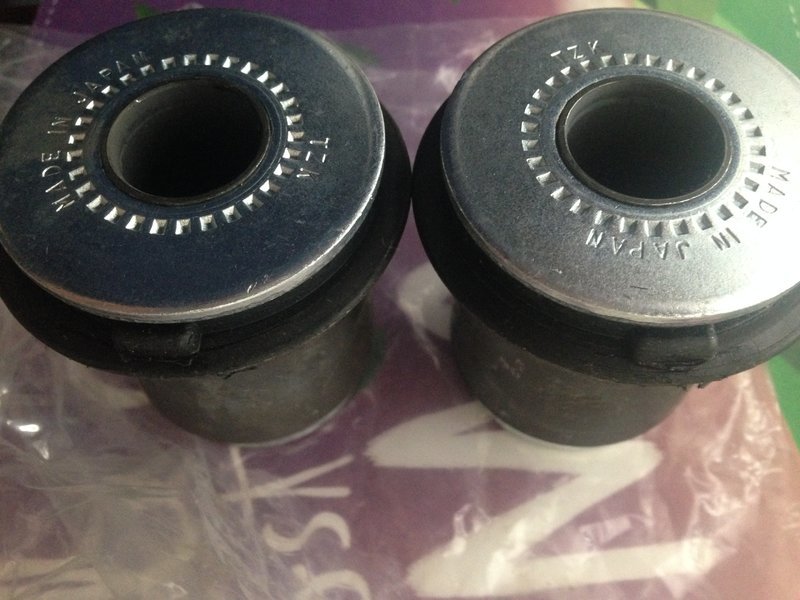

    I finished upper and lower control arm bushings this weekend. I went with poly bushings instead of the rubber factory style.

    What's rubber about the factory ones besides the boot?
  14. Mar 26, 2017 at 7:23 PM
    #34
    01GreenTacoma
    01GreenTacoma Well-Known Member
    Jan 9, 2017
    #207086
    849
    Factory style control arm bushings are rubber while the energy suspension I went with are polyurethane.
    This is a factory style bushing.
