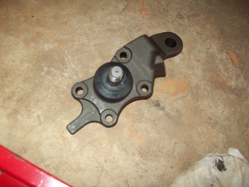

    For those who didn't know, Toyota had recalls on the lower ball joints around 2002 through 2004. Mine recently broke on my '99 and gave me a scare, I would urge everyone to check them out for safety.
    Heres a link to some recalls throughout the years if you wanna take a look at some.
    http://www.dealerrater.com/recalls/Toyota/TACOMA/
    On with the tread! Share your pictures and stories!

    What is the torque spec on the 4 bolts that hold the ball joint on?
  17. Sep 30, 2011 at 5:41 AM
    #17
    98tacoma27
    98tacoma27 is going full "SANDWICH" Moderator
    Dec 18, 2008
    #11714
    67,723
    Ben
    Not Beech Creek
    05 Tundra SR5 (+295k AND COUNTING), 2006 F350 King Ranch 6.0L
    Some stuff. Not a lot, just some.
    59 ft/lbs
    The bottom nut is 103 ft/lbs

    X2....and don't confuse the inspection turning torque of 17-34 ft lbs on the ball stud like I did lol...noticed luckily on the second side so I just had to take off the cotter pin and retorque...
    It's actually odd that for a nut that has to line up on a cotter pin hole won't have a torque range...I think that's why I confused it because I was expecting should
