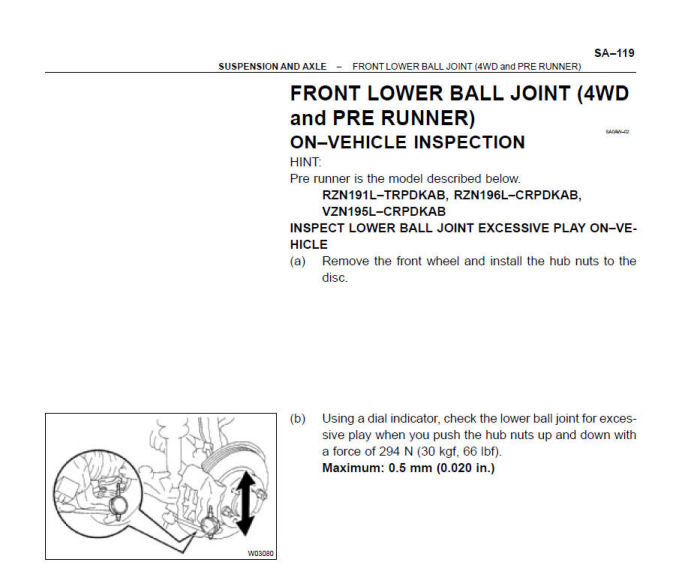

    The OEM does not use a "spring loaded gusher bearing" and will last 100k miles before going out of spec. Out of spec is a very very small .020"/0.5mm (thick as a matchbook cover) of "up and down" play measured with a very specific procedure. This amount of "play" can not be felt with the traditional "grab the tire and shake" or "pry the tire with a 2x4" methods. Because of this, many folks end up pushing them way longer than they should and the ball finally pops out all together with disastrous results.
    Below is from the FSM. They forgot to mention that the lower arm should be pushed up with a jack to "near" ride height. This eases tension on the joint from the upper control arm bushings.

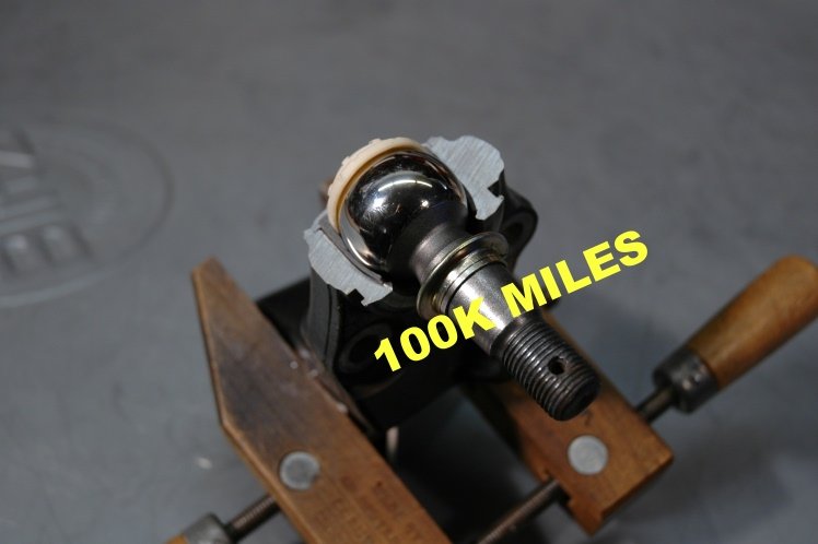

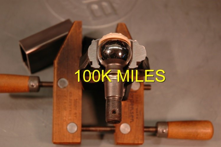

    This is a sectioned OEM with 100K. It is "out of spec" yet not even close wearing through the PTFE liner.
    That's my share, someone else will have to dissect the other brands.

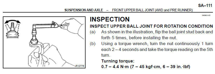

    so i know you jack up the LCA to test the LBJs but does this also work for the UBJs?
  17. May 2, 2013 at 3:03 PM
    #17
    Dirty Pool
    Dirty Pool HOUSE OF BLUE LIGHTS
    Mar 24, 2013
    #100471
    1,584
    59.4 Miles, 56.67*NE Of Moab
    99 XCAB V6 MT TRD
    Dirty Pool rear bumper/air tank with integrated spare CV shaft storage, DP customized TJM front bumper, 8000 lb Ramsey/Technora rope, E-locked, Extended breathers with front diff catch can, SAWs with DP heim joint seals, DP custom 6 leaf rear springs/Billies, DP custom skids, 2lo, Gray wire, Cap, Bed Rug, Black steelies, Both 31" MTZ's and 33" Toyo's, 01 Center console, Map lights, Disraeli gears
    Toyota only has an "off vehicle" inspection procedure for uppers.
    I use the "lower" procedure as a general on vehicle check for the uppers. I don't get too carried away with the "60 lbs of force" or any sort of measuring means. They are so cheap that if I am going to remove it for a further check due to some suspicions, chances are I will just replace it.
