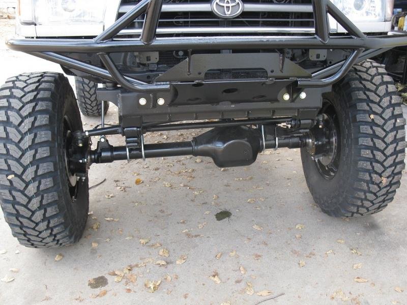

    I see only one solution to this debate
    706231d1352324082-addicteds-96-4runner-u_146ed9dd8a439e64e9d61369527dcf40d79f2ba3.jpg

    What's "555"? The part number or something like that?
  11. Jan 9, 2017 at 1:07 PM
    #51
    mechanicjon
    mechanicjon They call me "Jonny Stubs"
    Dec 2, 2016
    #203828
    10,149
    Jon
    Scottsdale Arizona
    04 Taco SC 4dr SR5 TRD Prerunner
    Supercharged, AEM FIC/6, Meth Inj, ION Alloy's, Radio & Phone steering Wheel controls,Fabtech AAL, Billie's wrapped with 880's , Tundra big brake conversion, bully bars and Pioneer DDin Stereo/dvd with exterrnal usb ports. 290K and going strong.
    It's a brand. It's stamped on bottom of ball joint.
