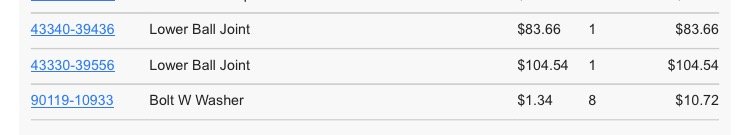

    The cheapest I could find the bolts were a $1.28. Anybody find the OEM bolts any cheaper?

    Where did you find the bolts at? I mite as well replace them since everything on my lbj is going to be new.

    Thanks man, I found this part number #9008010066 not sure if it's for the bolts for our trucks. I checked on one link and it said it won't fit my truck. On the other it said it will so not sure.

    The Part# I have is 90119-10933
