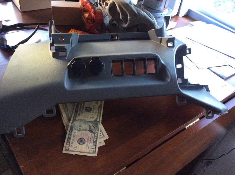

    i am searching some switches that will fit in the lower center console factory spaces where the heated seat switches would go. I purchased the console with the factory switch holes, and now I want to put some switches for bed lighting and rear lighting and other cool stuff! Can anyone help?

    They look like they would work would like to see if anyone has installed those in the lower center console

    I have a 2015. These fit the center console under HVAC. Judging by you pic it looks to be the same size opening for the switches. Maybe post in the lighting thread for a definitive answer.

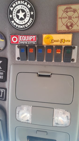

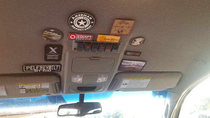

    Here is another option if you can't find small switches. I have a 2011 TRD 6 speed. This particular model does not have any slots open for Aux switches for my S-pod. I designed a plate and had it cut at a local water jet. I then mounted it in my head liner (I use my sun glass holder too much!).

    They fit perfect. I have them installed on mine. For constant 12V I tapped into the cigarette lighter. For the illumination 12V, I tapped into the heated seat wiring circuit.

    I have both air on board and ch4x4 as well as some from Amazon. They all fit. Air on board are the best quality though.

    You want the size to be 1.3” x 0.9” for the switch to fit perfectly in with no trimming.
