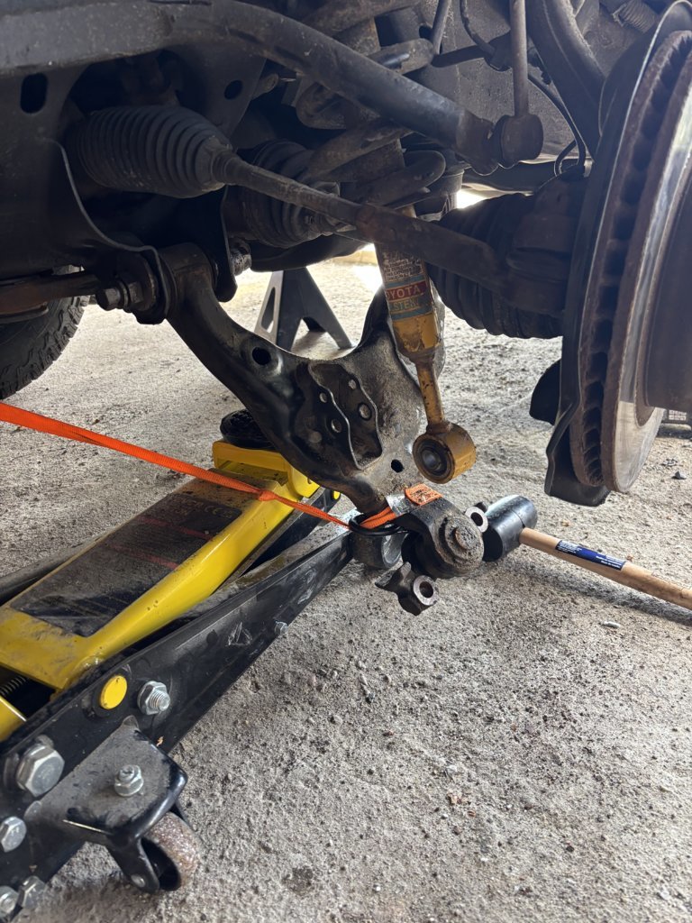

    I installed 5100 shocks on the front today using this method from @Soft Taco : https://www.youtube.com/watch?v=a9N1fvbGAEw&list=PLrbHj-V7O2tj1Ojtlh7vaOy0UAJkSHEZi&index=37 of applying pressure to the lower control arm with a jack. This is on the driver side (the first side I did). When I reached the step where you pull the shock and spring out, the lower control didn't drop, even with the bolts totally loose—I ended up pulling the control arm down and away with a ratchet strap. After that, I was able to install the new shock. No issue on the passenger side.
    Any issues that I should look for? It's going in for an alignment on Tuesday.

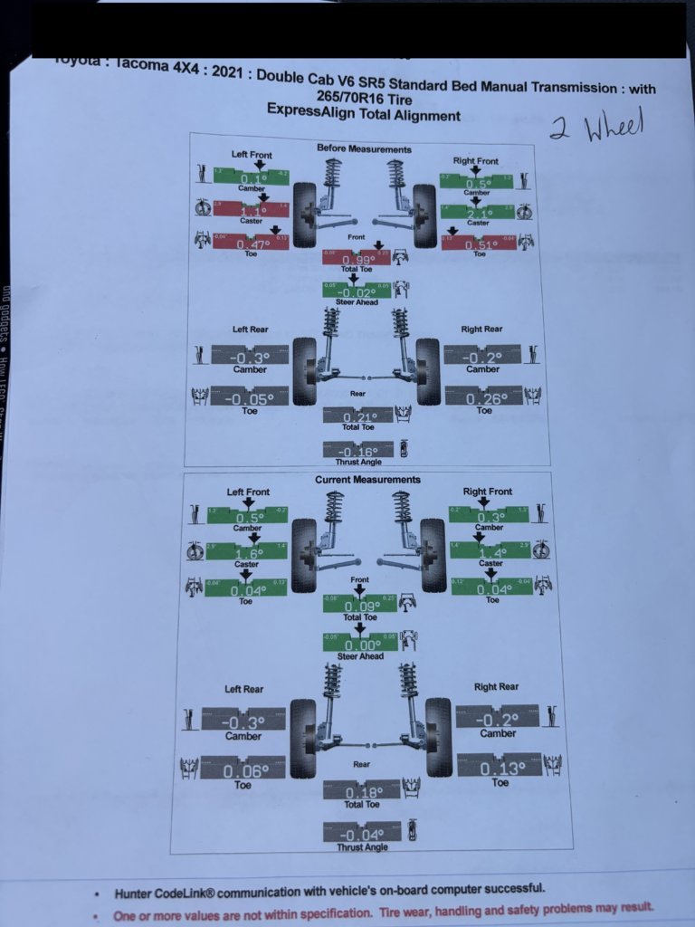

    They said it took them four hours to fix the alignment, but it's aligned now and drives well.

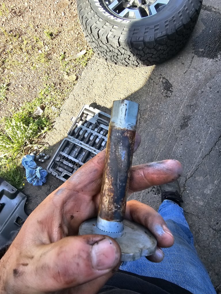

    heres my 2023 right from the dealer brand new. cam bolts were factory rusted in. one was almost siezed and had to be hammered out. owning tacomas before i knew to pull every bolt off i could and antisiezed when new.

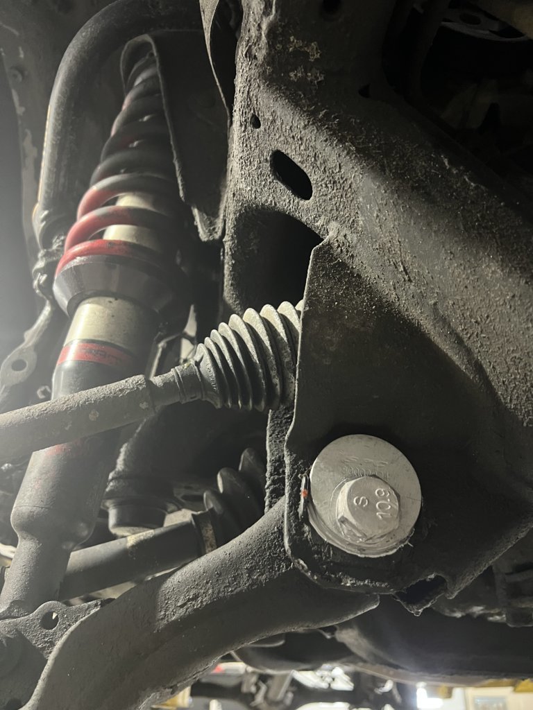

    I installed the front Bilstiens yesterday. No problem with the control arms binding. PB Blaster did the trick.
    I had my iPad in the garage and referred to the Team oil drip video as I went.
    The first side was the learning curve. The second side went a lot easier.
    My truck rides so much better. I had already installed the rear shocks @ 12k.
