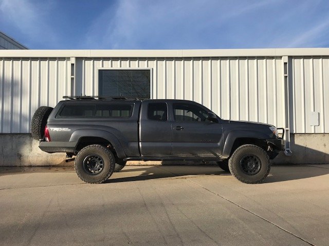

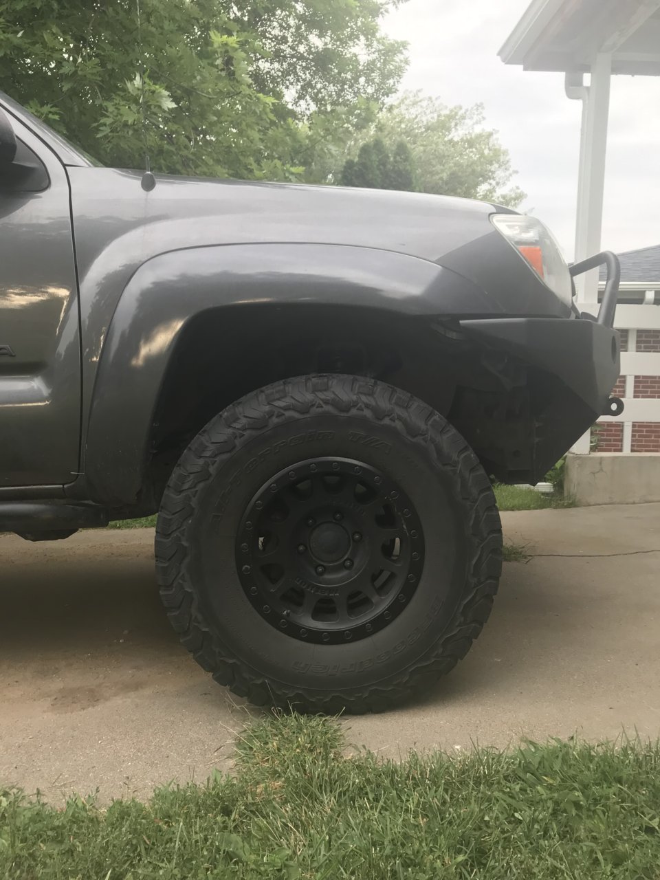

    I have TC UCA's and want to push my caster forward to clear 295's next. I don't know exactly what my caster numbers are but the LCA is as far back as it can be. I took it to a shop hoping for an alignment and caster upgrade, only to be told the bolts are seized. They estimate 3-4 hours of labor + parts, so I might be looking at $400 or more.
    Is it worth it or should I just live with how it is? Part of me is worried it's going to lead to additional issues/costs.
    For reference, here's two photos that show where the wheels sits:

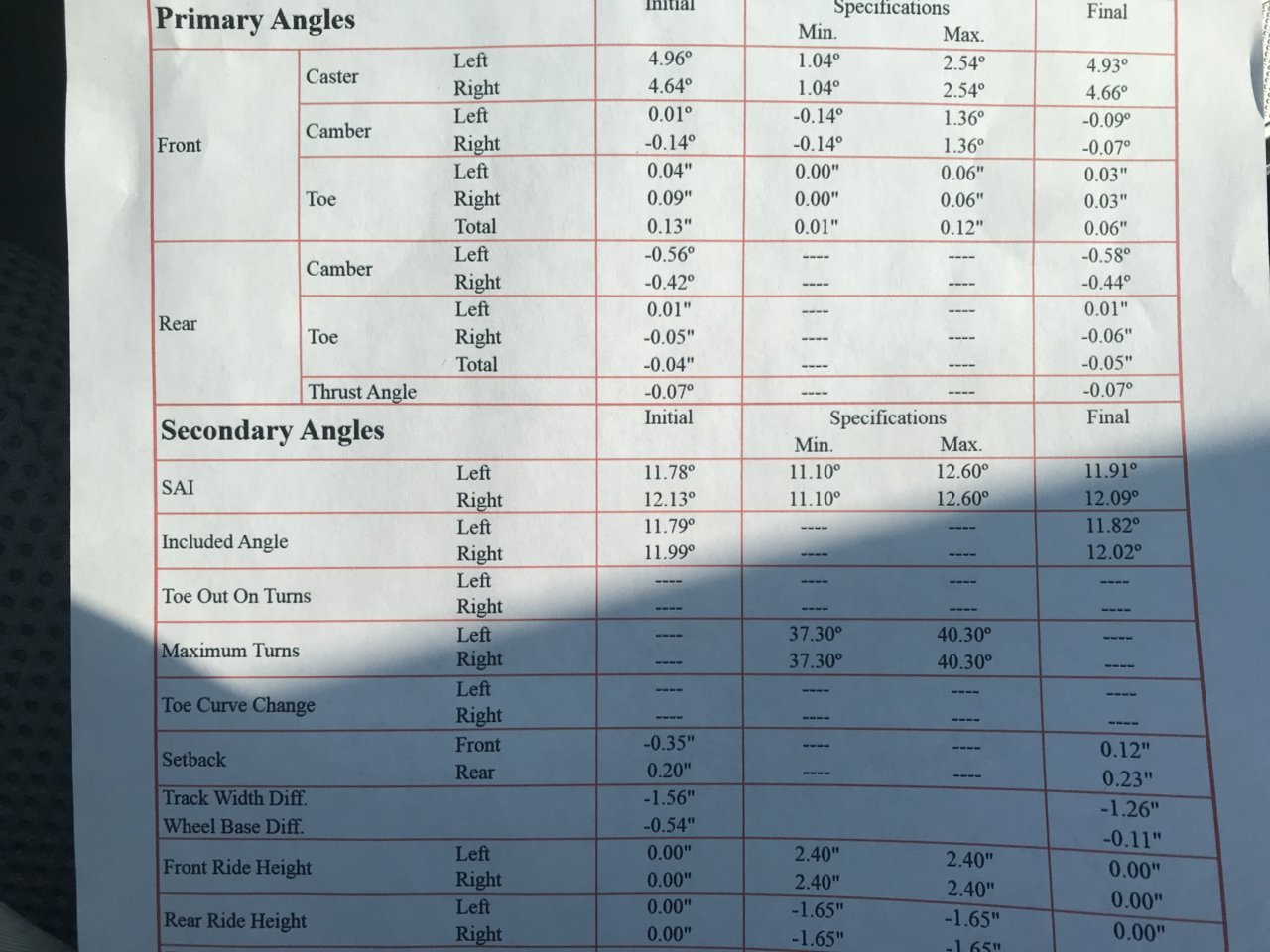

    Here are my numbers. Little surprised about caster as that seems higher than recommended here. He said to disregard the initial numbers since he already tweaked it.
    The over all cost was worse than anticipated. Never want to do that again!

    2,682
    Corydon, IN
    2014 Spruce Mica, TRD Off-Road, 6 Spd Manual
    Sliders, Tailgate Liner
    Mine were seized too after my lift. After wearing tires prematurely, I decided to replace them. The front ones are sleeves and the back ones are just bolts through the bushing. My back ones were fine so I just did the front. I greased the bolts and sleeves good when I reinstalled them but now mine keep loosening up.
    I'll be back in for my third alignment in the next couple of weeks.
    I just can't stand only getting 30,000 miles out of a set of Michelin Defenders.
    My problem was camber. My tires were noticeably out at the top and some things moved around so my toe was in way too much.
    After your alignment, make some marks on your alignment cams with a paint pen and keep an eye on them for several months.
    I'd bite the bullet now.

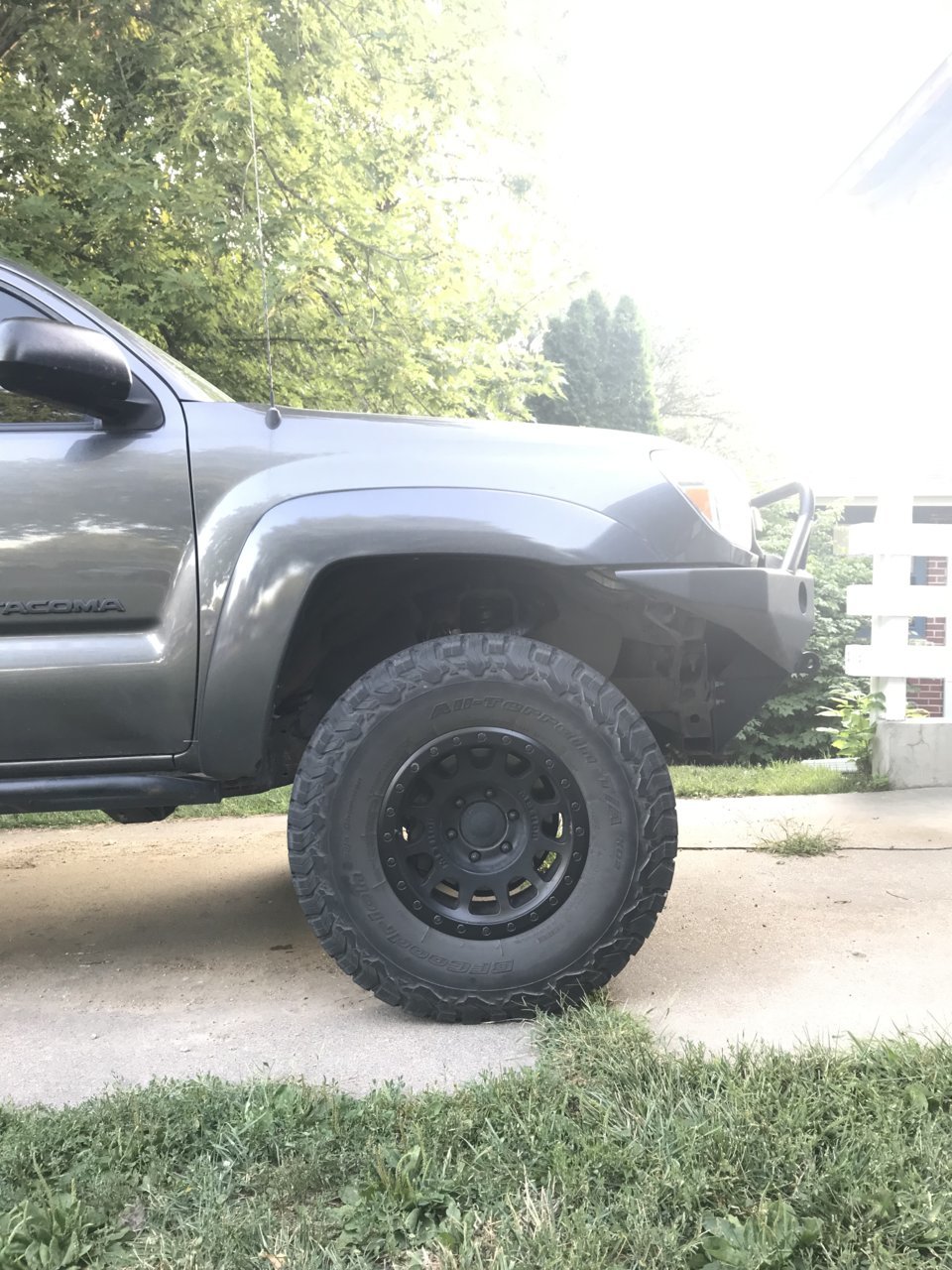

    After visual:

    Not sure man i run 255/80/17 so i dont Have the probs. Are you mid travel with those TC lowers? Who installed them? I thought They were supposed to help with this. Caster seems high but if it rides nice i dunno. Do you have premature tire wear?

    Looks similar to mine but my skinny don’t rub and i have Rebuilt reinforced stock LCA not aftermarket yet.
