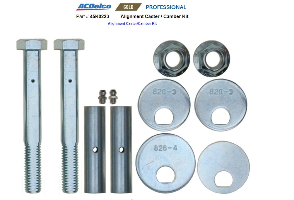

    Are the assemblies with the grease nipple on them worth it? ACDelco makes a kit that seems like a decent idea...but it isn't the cheapest thing in the world.

    No, for a couple of reasons. Rubber bonded bushings don't need grease and the bolts will be inherently weaker due to being partially hollow for the grease channel.

    Makes sense. Thanks for the quick answer.
    I also just saw that they are aluminum. Not for nothing but I really don't want aluminum bolting that together.

    I completely agree. I wouldn't want an aluminum bolt holding anything remotely vital together, let alone a critical suspension component.

    Im betting thats a typo. No way they would make something like that out of Al, and it looks like coated steel in the pics. But I do agree with the above, OEM is best in this application

    These are crap. The D-shaped holes in the cam washers round out. Same parts also packaged as Moog K100128, Mevotech MS86043, and other brands: https://www.tacomaworld.com/threads...lem-solver-caster-camber-cam-bolt-kit.317057/
    If you go off-road, it's better to get cam eliminators from Bison, Poly Performance, or 333 Fabrication, but IMO they need to be used in conjunction with upper control arms with fine camber adjustment.

    Agree. I have the Bison, but their limited adjustment is also a hinderance when trying to get a good alignment.
