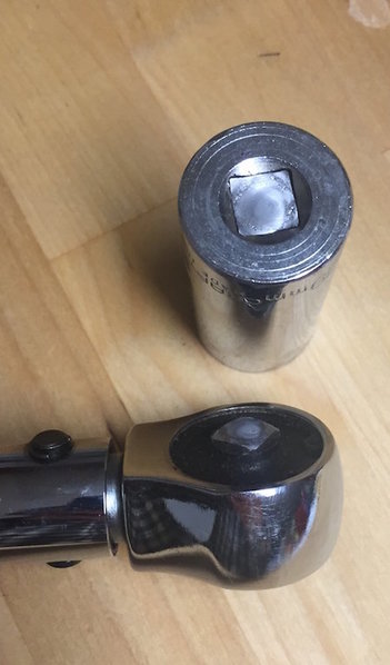

    My suspension install is stalled. Shouldn't have used the 3/8" torque wrench but it was the longest I had for the 6-pt 19mm I had.
    Off to Sears to see about that lifetime Craftsman warranty ... and buy a 1/2" 19mm socket.
    But If I can't loosen the LCA bolts I may have do this with the spring compressor method instead.

    Using a new socket on the inside of one of them (with breaker bar this time) I felt as if I'd either bust the breaker bar OR shove the truck off the jack stands. Now what? No rust or visible corrosion on the bolts.
    It then occurred to me that I should probably be trying to loosen the outer bolts instead? I can't reach the front outer one until I figure out the stupid skid plate (7 bolts removed, it won't budge). The rear outer LCA bolt is right next to the steering rack boot or whatever and socket won't fit on there.
