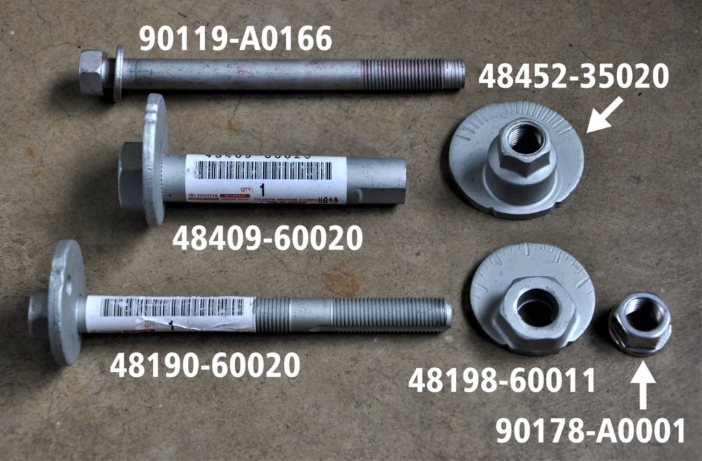

    Does anyone have all the part numbers?

    Don’t cut them without trying to unbolt them — you may get lucky. But also be prepared with new hardware on hand, a reciprocating saw, and a couple carbide blades profiled for cutting thick metal.
    If you want to avoid having to peel the stickers off the new hardware, you can check out the SPC bolts for the lower control arms. There are plenty of other third party manufacturers too.
    Anti-seize is also a good suggestion for the bolts that run through the lower shock eyes. If you find out these are seized and need to be cut, you can replace them with grade 10.9 M14 80mm fine thread bolts from any good hardware store, but if those bolts are seized you will also need to have newer lower shock bushings on hand (assuming the entire shocks aren’t due for replacement). You can borrow a jaw puller from an auto parts store to press out the old bushings and install the new ones.
    Also, knock the lower ball joint out while the control arms are still on the truck. It’s a lot easier that way. Then the little piece that connects the LBJ to the spindle comes off with two bolts that have 19mm heads — Toyota puts thread locker on those, so have some blue thread locker on hand. (Getting those bolt holes to line back up for install is a joy. :D)
    The thread locked spindle bolts tighten to 118 ft lbs., the lower shock eye to 61, and the alignment hardware to 100. I think the sway bar bolts tighten to 51. (?)

    Can confirm. I have used that exact pic to order those bolts for my 2nd gen. You don't need all of them though unless it's rusted to all hell down there. Just the 3 that end in xxx020 are the ones that are usually seized. Not a bad idea to just do all of them though if you can afford the little extra.
    Use the "thick metal" blades with carbide teeth from Diablo. You can usually do all the cuts with 1-2 of those blades. Anything else you will need like 4-5 blades. https://www.diablotools.com/products/DS0608CF
