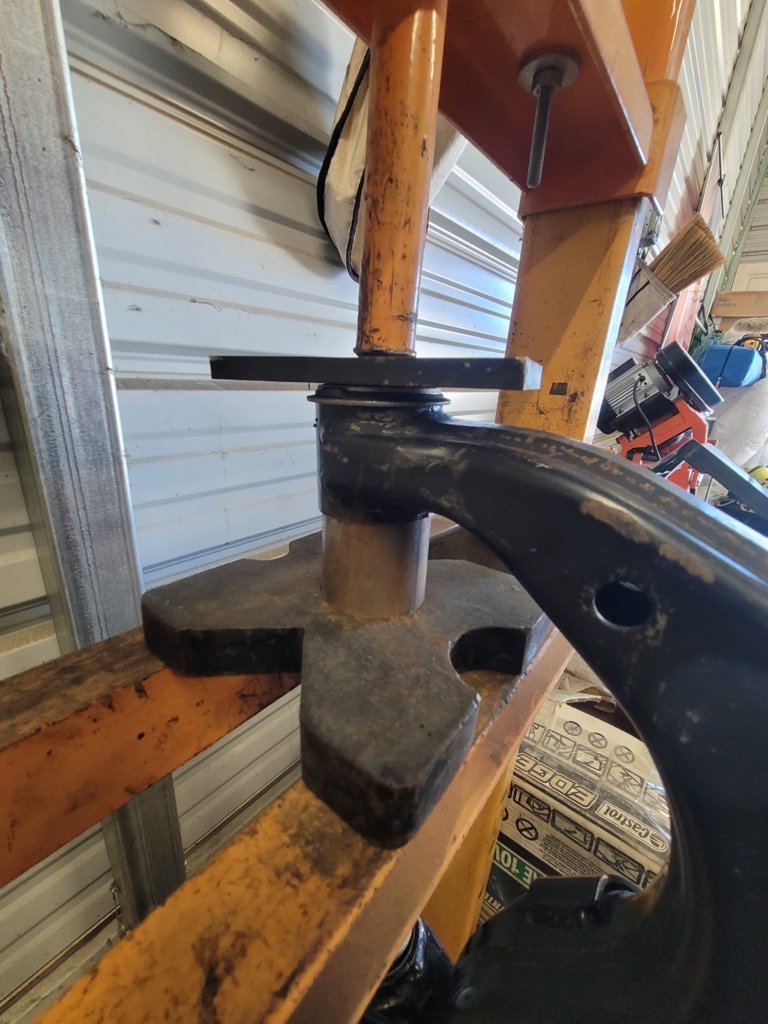

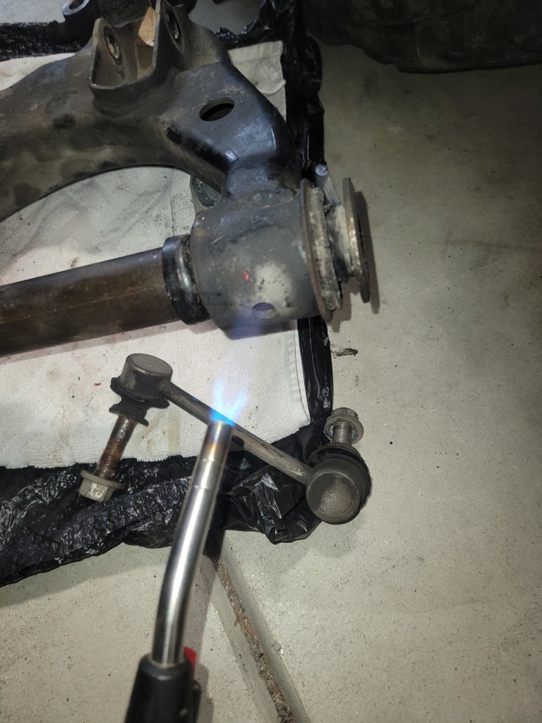

    Toyota bottle jack and a heat gun for persuasion. A press and HREW tube to installed new bushing.
