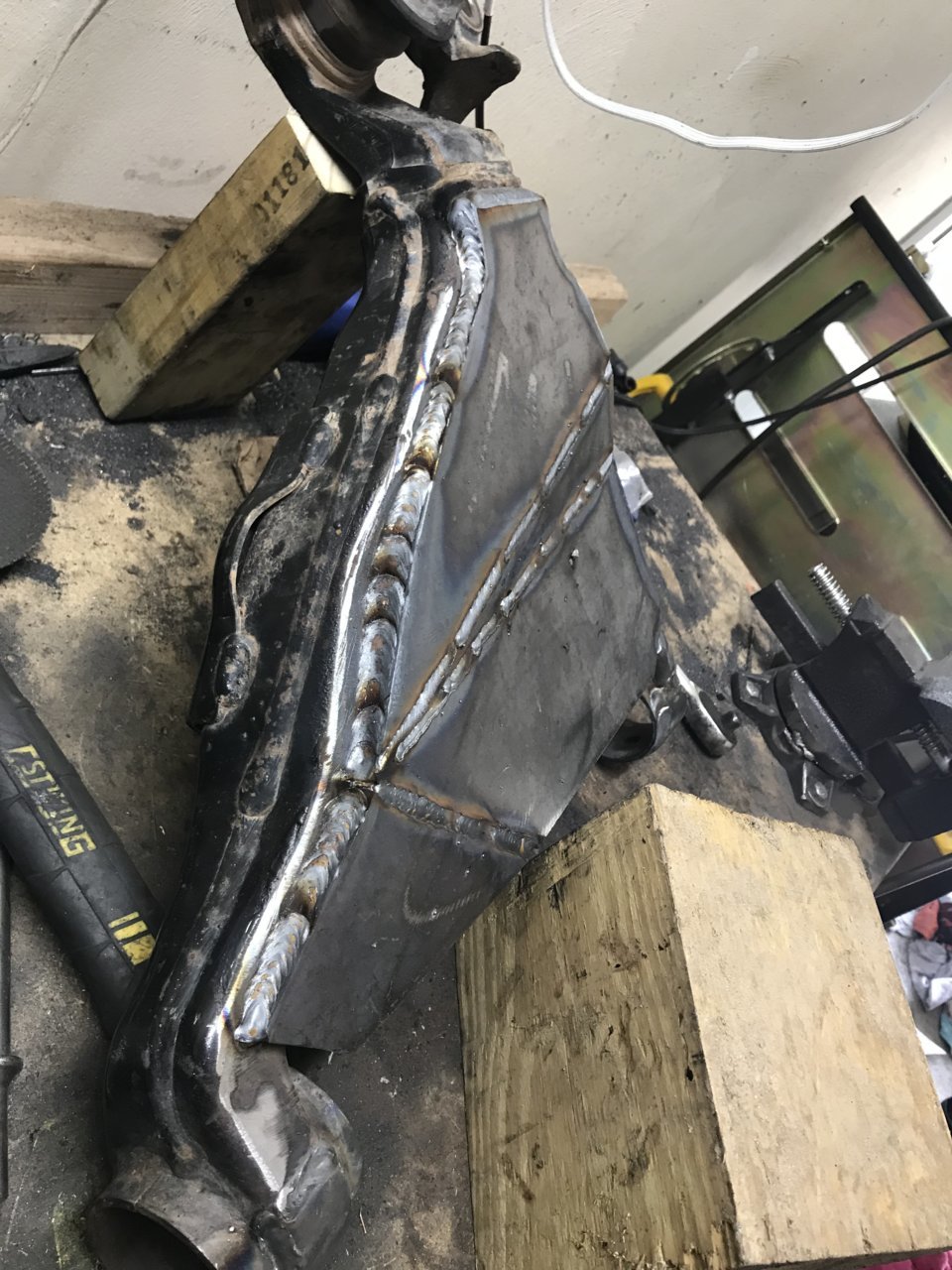

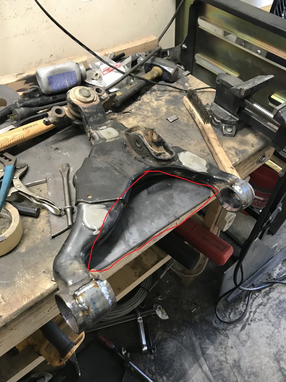

    Color me impressed, that's a failure I haven't seen before. I will parrot others and suggest some new OEM arms and chalk it up to a freak incident.
    If you really want to go beefy without breaking the bank, you can get some old oem arms, reinforce the bottom and bushing eyelets, new bushings and new ball joints and you'll be all set. Maybe not like I did though because this acted like a shovel.....

    What do you mean? Curious, as this might be the route I go. It's hard trying to stomach $1600 for LCA's.

    This part here loved to hold mud. If I were to do it over I don't think I'd do it like this. I'd just reinforce the bushings since that's the most common place for them to fail and call it a day.
