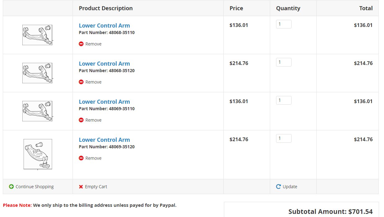

    What else do I need to order other than lower control arm assemblies? I cannot find the part numbers for the cam bolts and tabs and everything.. which I'm pretty sure I will also need to replace since the bolts are seized into the bushings and will need to be cut off

    The part numbers you seek are in the video description of both videos. Happy Wrenching!
