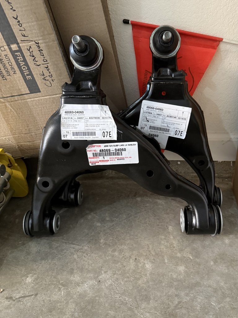

    At around 100,000 miles, my driver-side lower control arm ball joint started making noise, creaking and squeaking. Took it to a shop, they said they greased it and didn’t find any slop, so no need to replace. But the noise came back about a month later
    Originally, I was just going to buy new ball joints and have a shop press them in, but after doing a bunch of research on here, it seems like the smarter move is to just replace the whole arm, less hassle and a cleaner job overall
    OEM arms are pricey, around $550 for both sides plus $125 shipping from the online parts guys, and that’s before installation
    Looked into MOOG, but almost everyone says to stay away these days, quality’s just not what it used to be
    Then there’s Mevotech. Some say they’re great, others say they’re garbage. I do like that they have grease fittings, especially for a truck that sees off-road. Their TTX bushings (TXMS86527) seem to get a ton of praise, but of course, they don’t sell a complete control arm with those bushings already installed. Come on, Mevotech! So I’d have to buy the bushings ($65 per side) and pay to have them pressed into OEM arms. Not the end of the world, just adds another step and some labor
    So here’s my question:
    If this were your truck, and you planned to keep it long term, what would you do?
    This is my daily driver, I take it off-road, and I’m not exactly gentle with it. It’s also my favorite truck I’ve ever owned, so I want to do it right.
    Sprinkle me with wisdom, boys:
    For context, I’m running JBA uppers, which have been great, and ARB BP-51 coilovers (probably due for a rebuild soon too). Speaking of which.... does anyone know a good place in SoCal to get BP-51s rebuilt?

    Thank you everyone for the help. Might just go stock arms from Toyota and swap them out... they lasted 100K so the new OEM ones should last another 100K

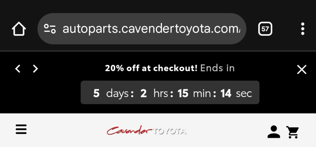

    Wait for a sale on oem parts. Toyota might have something for 4th of July. I bought both new oem lca's for around $500.
    I considered dirt king lca's, but most aftermarket options are $2k or more.
    TXpro4X4 and casper_sgv like this.

    Thank you sir! Found a deal on the OEM ones 500.00 for both sides complete lowers at the dealer... think I am just going to do it! Be good for another 100K Miles

    Toyota is running a 4th of July sale for 20% off if you order online
    TXpro4X4 likes this.

    Where do you find the sales advertisement, Toyota website?

    My local dealer told me about it when I went to pickup some parts. They let me order online and pick up locally but you can also get the deal if delivered. The discount only applies at checkout.

    At the top of the page here:
    https://autoparts.toyota.com/
    I order all my parts from Larry H Miller Toyota in Lemon Grove, CA. They seem to have the best deals. Norm Reeves Toyota in San Diego, CA is another good one. If you order parts from out of state you can usually avoid paying sales tax. Not sure if that's changed.
