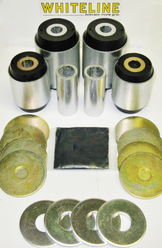

    Milowilli Milowilli
    Jan 17, 2012
    #70857
    362
    Miles
    Naples FL
    05/ 07,09/11Tacoma access cab 4x4
    Get new cams, install poly bushings with anti seize Bushings available on EBay from Autowarehouse
