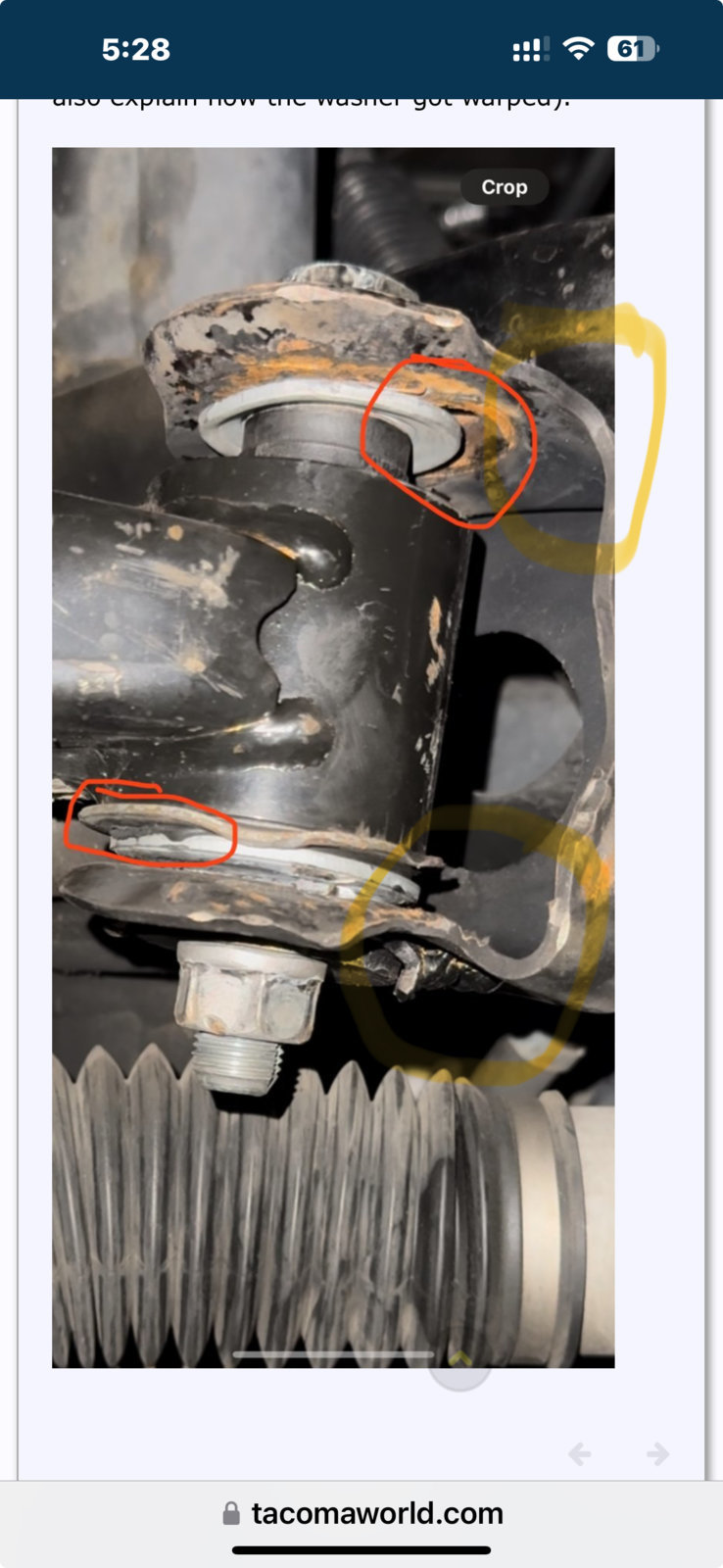

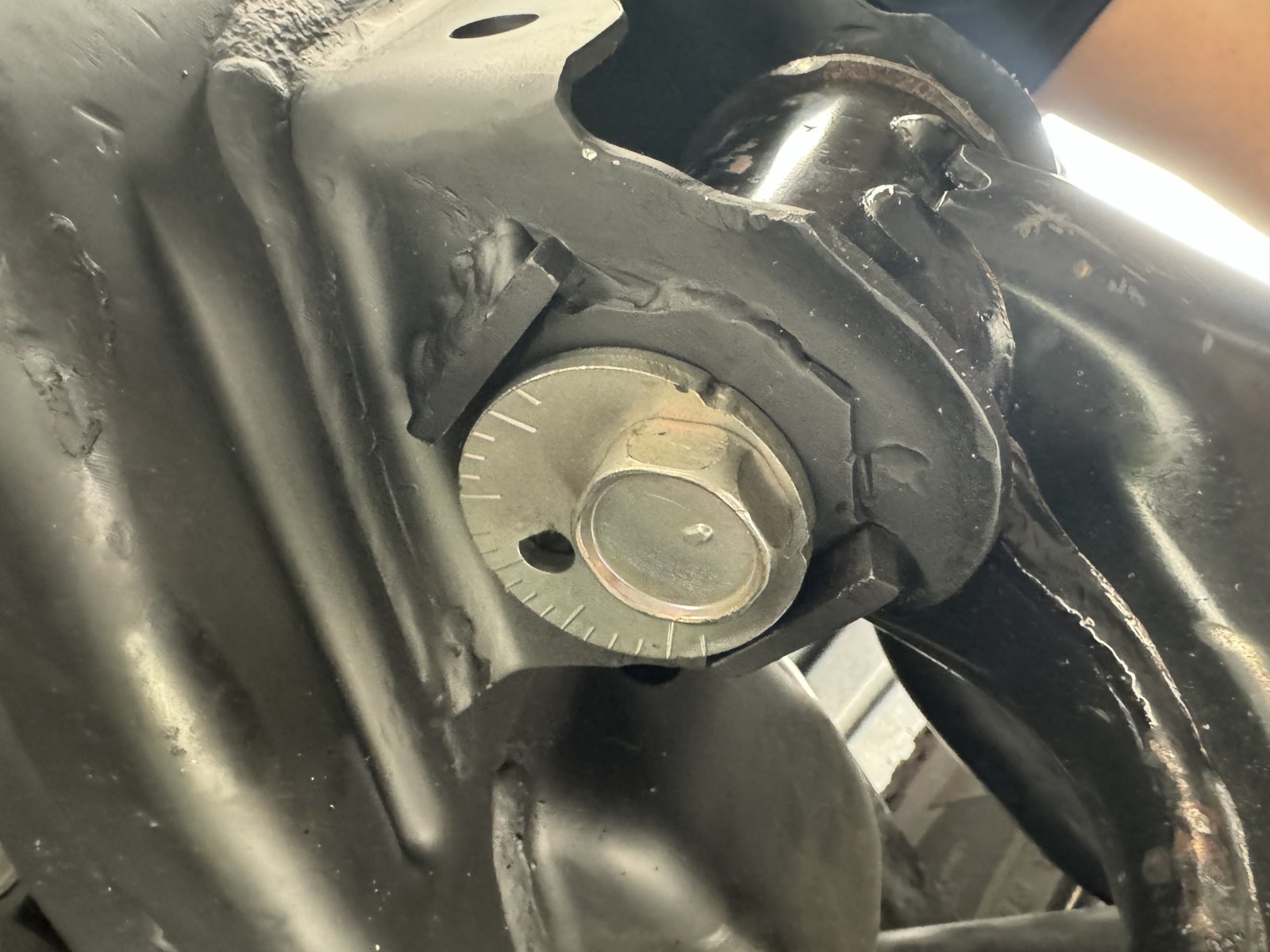

    This is what concerns me. How can the lcas be sitting correctly when this is all mucked up. Pic of mine and yours. IMG_1722.jpg IMG_1723.jpg

    Really tough to see for sure based on different angles so I've been trying not to speculate TOO much. But yeah, @gotoman1969 those pics really are starting to illustrate that the mount is F'd. I can really see now some obvious hammer marks too. I think all points are leading in the same direction now...
    Sure looks to me like this tech had NO idea how to deal with the seized bolts. While we're speculating... looks like they cut the outside ends of the bolts rather than the inside, which then didn't release the LCA (DUH!) At that point, they used a BFH and possibly pry bars to open up the mounting pocket. They then did a hack weld job on the damaged cam tabs and weren't able to reshape the pocket. Not like you want to be bending these pieces of metal anyway as thats a surefire way to stress and weaken the metal.
    Ugh, I'm sorry @C1397 but this just keeps looking worse and worse the more we look at it. Unfortunately, you can't just easily replace this part since it's literally just welded onto your frame. I still think you need to get under the truck with the service manager and show him how this mounting point is completed deformed and ruined. I'd want to hear what he suggests for a fix and I would be skeptical if they say they'll just bend it back into place. Sounds insane and I can't see a situation where they'd actually do it, but IMO the right way to fix this is to replace the frame. Maybe you could cut a good pocket from another frame and weld it to this one and there are some aftermarket solutions out there which may be helpful but thats not the kind of stuff the dealer should be doing and instead more the kind of thing you'd want a fab shop or autobody frame shop handling.

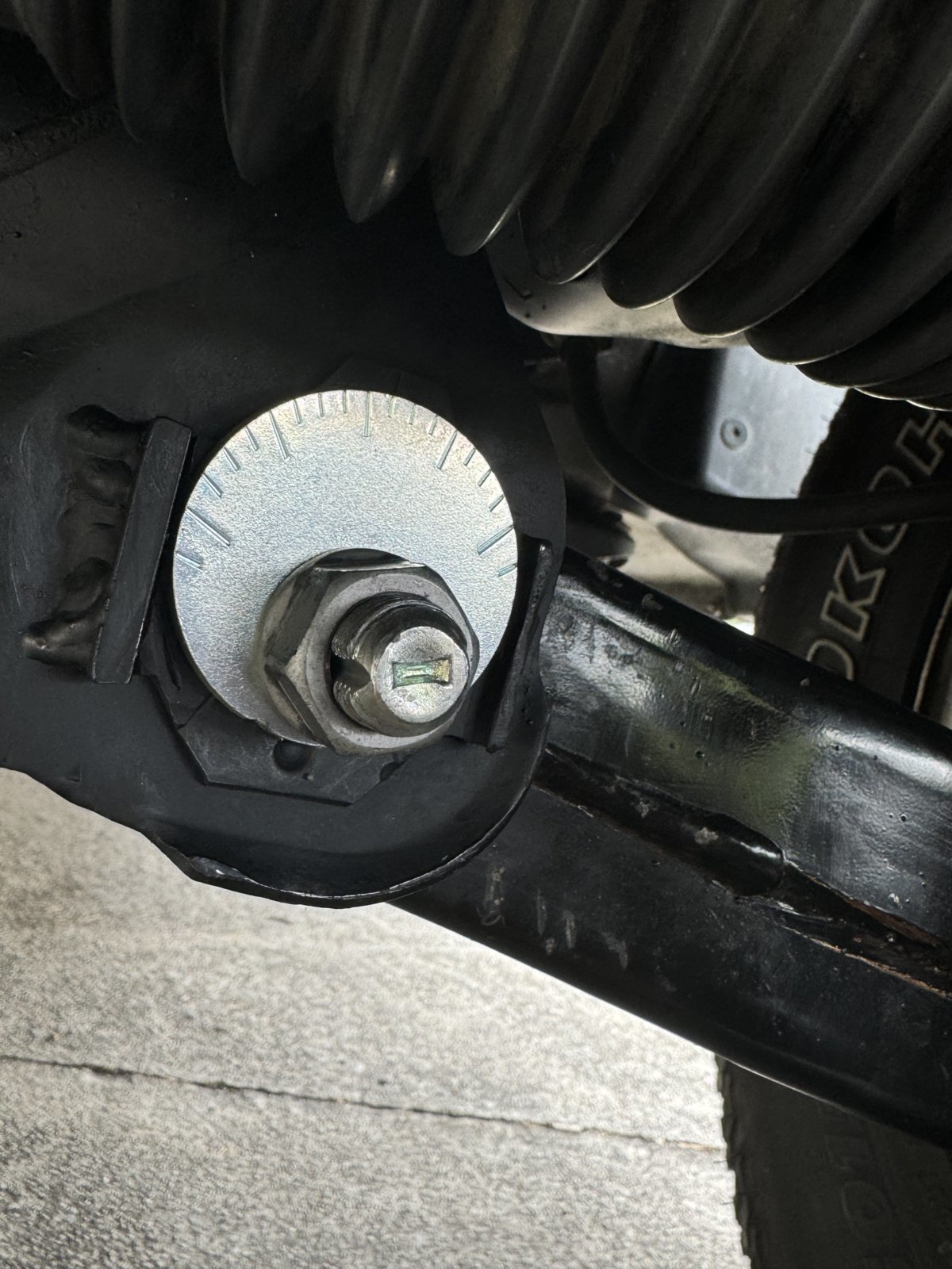

    Just got it back today. To me it looks like they did exactly what you said and re-welded a new mount. With my remote start it comes with GPS and the whole time they had it this time it wouldn’t ever update, and my battery jumper in the back was used (disconnected battery and took it somewhere else for it?). But here are the updated pics, it looks like a new mount to me:

    ^They definitely didn't weld in a new mounting point, you can see the old hammer damage. But, looks like they did some work to get it back into roughly the correct shape/location. And they did a better job re-repairing the cam tabs too.
    Is the squeak gone? Are the alignment specs as they should be? Hopefully all is well.

    Just looking at the pics. The lca does not appear to be sitting square in the mount imo. Also are those OE lcas?
