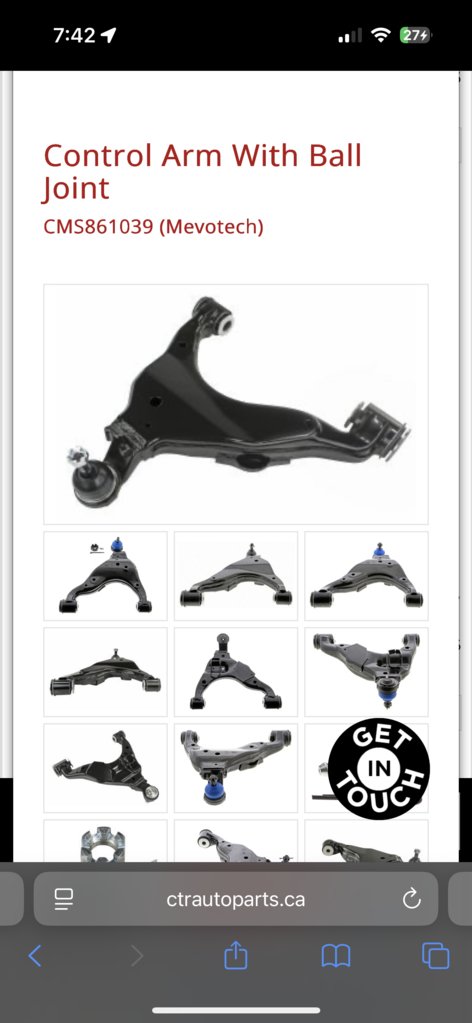

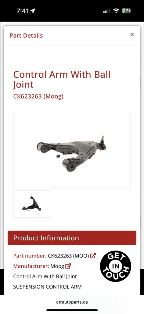

    I need to replace my lower control arms and the only options i really have are Moog, Mevotech or Napa just wondering what you guys think would be the best option, thanks.

    I have heard mevotech is alright, lots of bad reviews on here from Moog. None of those three options will last as long as OEM, but it depends on your needs. I went with some cheap arms from TRQ (1A auto) and no issues yet with 3k miles, but I don’t expect to get much more than 30-40k out of them. Which is Ok with me because I don’t drive my truck as much anymore.

    10 year old truck in Canada means the cam bolts are likely seized and would need to be cut out with a sawzall, so make sure you really need to replace the lower arms before you proceed, and budget an extra $500 or so for replacement cam bolts. Unlike the control arms, aftermarket cam bolts wallow out and fail quickly, so the pricey OEM cam bolts are the only viable option if you have stock-ish suspension.
    If the ball joint is failing, you can replace the ball joint in-situ with a C-clamp style press. Replacement ball joints are available from Moog, Mevotech, and OEM (through Japan-based sellers on eBay, not sold by dealers). If the bushings are torn, then replacing the whole arm makes sense, in which case either Mevotech or Moog are fine for the truck's remaining life expectancy. Mevotech is a Canadian company for what it's worth, though both are made in China.
