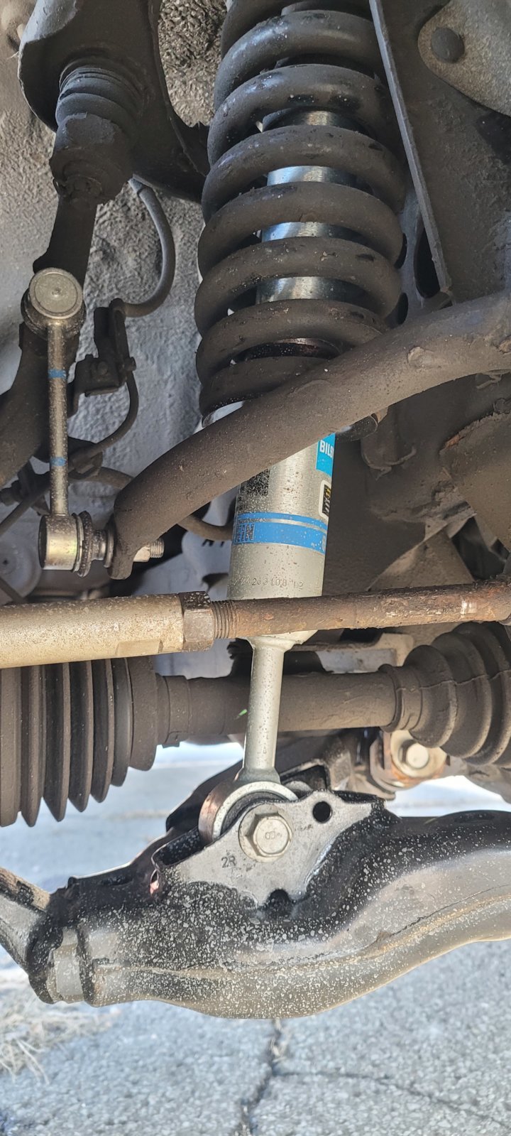

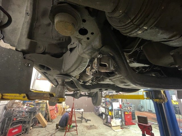

    Just did the ECGS bushing on my stock 2019 TRD off-road as a preventative measure last weekend. While I had everything apart I noticed that the driver's side lower ball joint, while not yet loose, was definitely at the tail end of what I would call reliable, fairly easy to move by hand, (the tie rod end was much stiffer), So I decided to look into replacing the Ball joints as cheap preventative maintenance.
    I would prefer a real upgrade, but every good aftermarket LCA is really only designed for use on lifted trucks with real coilovers, also they are quite expensive. For a straight up replacement, the consensus is that OEM lower control arms should be replaced entirely with OEM LCAs since the cost for the parts is nearly the same. So I placed the order with Ourismann, (Formerly mcgeorge), and received an email the next day stating the LCAs are backordered everywhere with no real ETA. So I cancelled that order and ordered a pair of Moog LCAs which were delivered today. I will rebuild the OEM LCAs sometime soonish once I can source a good balljoint and bushings.
    This brings me to the final boss: the Cam Bolts. Since it is a 2019 that I daily drive in upstate NY, although I stay on top of Fluid film and pressure washing the undercarriage year round, I full expect the cam bolts to be siezed in place. I skipped the Moog greasable bolts and most of the similar parts due to thoroughly mixed reviews on the internet.
    So now I am trying to decide on what to grab for Cam bolts, Greaseable or "regular"? OEM or Aftermarket improved design? Looks like KP Offroad has a good design with the octagonal washers, but I am concerned about losing the fine adjustability of the OEM design if that could cause an issue getting the alignment spot-on.
    What is the best approach for a stock set-up? I would like to avoid issues like seized cam bolts and alignment going out of spec due to the cams moving on their own in the future. The only suspension "mod" I have planned for the near future is installing a TRD pro suspension so i will use the stock tabs rather than welding on the KP offroad ones.. I have also seen SPC and Solo Motorsports have cam bolt kits and am open to other recommendations.
    Hindsight being 20/20: I would have just purchased a OME or FOX coilover set-up and aftermarket LCAs instead of buying 9 side-quests to complete.

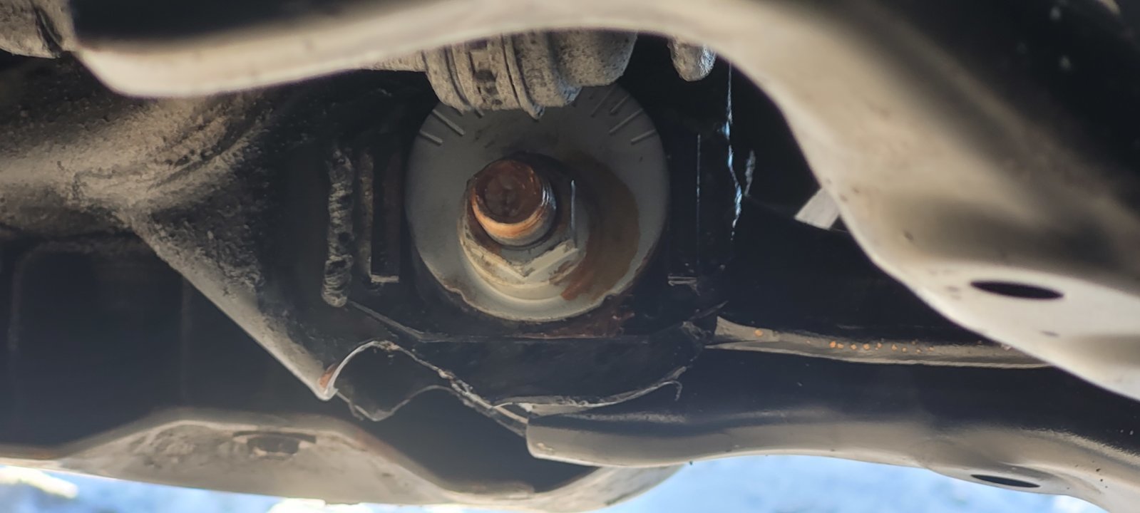

    That said, I put the Total Chaos cam tab plates on my truck, then made a rectangular plate to replace the alignment cam. After very carefully driving home from the alignment shop I drilled a hole in each plate and replaced the cam bolts with grade 8 hardware.
    I then proceeded to beat the snot out of the truck and never had alignment issues again. Until a civic committed suicide under my front bumper and bent the frame.
    You could do something similar by drilling a hole in the alignment cam and frame, then installing a grade 8, 1/4" bolt in the hole to prevent the cam from rotating. Then you can remove the bolt if the alignment ever needs adjustment.

    That was my question too when time came to refresh the front end and never found the answer so I just went with the most cost effective (imo) solution with the Total Chaos steel tabs and lots of anti seize.
    Not saying that's the perfect solution by any means tho
