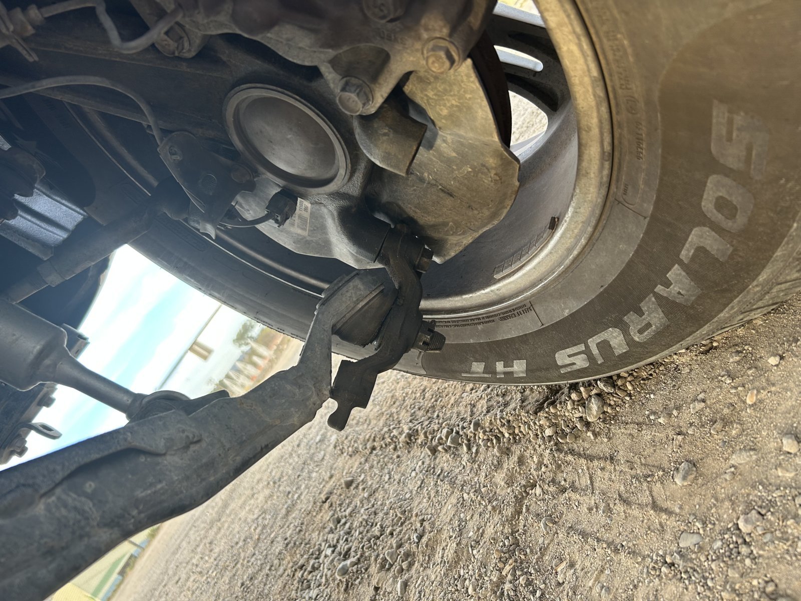

    I bought use 2020 Tacoma one control arm bolt came out. It is not stock. See picture. Anyone familiar with
    It was lifted
    the mounting bolt holes are vertical not horizontal and the wheel mounts are the 90 degree
    you can zoom in on pic and see control arm bolted towards back

    I found out this hub is for a 4x4. My truck is a RWD.

    What are you talking about? that’s the 2wd hub. Your bottom bolt sheared off. That’s it. Get a new one, slap it there and you’re solid.

    not sure what you're sayin, but
    your spindle is loose
    it appears gusseted
    you don't have a hub
    you have a spindle with a cap plug because it's not 4x4

    You sir are playing a dangerous game. You have the correct parts.
