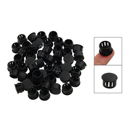

    2016 TRD Sport DCSB Inferno 4x4, loaded /JBL/Tonneau Cover/ Roof Rack
    17" Black TRD rims Tacoma Stainless Steel Rear Tailgate Letter Inserts Brake light flasher Center LED 110v and 2-3amp USB plugs mod in back seat center 400w on all the time mod SSR-610-40 SumoSprings 32 INCH 180W CREE LIGHT BAR (5D ) AUXBEAM BedStep and Pop & Lock Power Tailgate Lock Blue LED glove box light (fix no light) Bed light Blue LED's Wired to turn on when Gate is opened Tempered Glass Center Touch Screen Protector Rear Camera anytime Navigation Bypass ( a must) Rexing V1 3rd Generation Dash Cam hard wired in OXILAM 912 921 LED Reverse Light 2000 Lumens TRD Pro Grill TRD Skid plate
    just ordered
    9/16" Dia Head Plastic Locking Hole Plugs Black 50 Pcs $2.12 eBay
    i now will have a "few" spares to lose or give to a fellow Tacoma owner
    i may drill a few 1/16 holes in them just incase they hold water ... i do have some to mess with..
