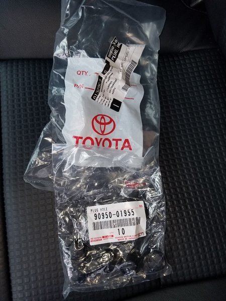

    I had it done. The Toyota Canada TSB is TCI-4418

    Mine did. I went up to my dealership, and my service advisor gave me the plugs. Took a total of about 45 seconds for "install" lol. It worked though!

    Was unsure if mine was making this noise, but seeing as how the fix was so cheap ran up to Lowe's and bought the plugs and installed. Final conclusion was yea it was.

    During my 20k service, i handed over the tsb as i am experiencing the same issue as the rest of you. They test drove it to hear for the sound (even though i showed them videos of how mine sounded). Despite not able to replicate it, they went ahead and ordered for the plugs.

    It is so ridiculous that they don't just keep those in stock and install them when a customer comes in and complains. My dealer would not order mine because they couldn't "REPLICATE" the problem. I was washing my truck at home on a very windy day....it howled while the truck was sitting still! So I went to Lowe's and bought my plugs for about $10. The dealer wanted about $80 for me to purchase the plugs....can you believe?

    How many where installed? It calls for three each side. There are actually 4 or 5 holes. The tech may have plugged the wrong ones. Mine went away after I installed the plugs

    3 holes on each side get plugged, either a Google or Forum Search will show which ones, you can try some tape before bothering to run out for plugs to make sure that is the noise you are hearing.

    So easy... I just bought the OEM plugs at like $1.50 each... I know the same thing could have been accomplished from the hardware store for cheaper, but still cheap enough. I thought the whistling sound I heard was coming from my Prinsu (which I have spent a lot of time whittling out wind noise to where it's barely noticeable now in most conditions). Guess not, haven't heard a single whistle with the windows down since installing these plugs!
