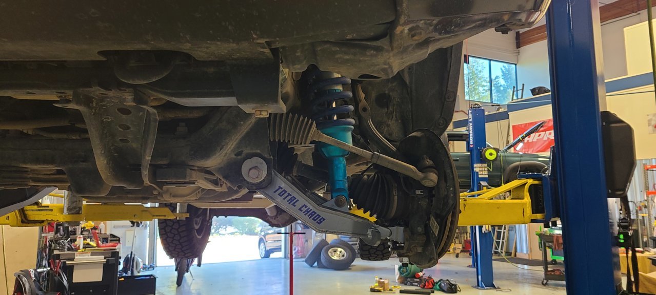

    I have the TC arms. A few points...
    • Stronger
    • Higher clearance
    • More droop
    • Less deflection (poly bushings)
    I'm very happy with them. Very expensive, and I'm not arguing that the minor improvements above justify the price, but I have no ragerts.

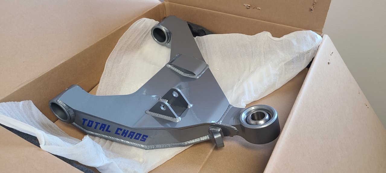

    Improved ground clearance, able to easily add a bypass shock (if you get an LCA with a secondary mount), able to keep KDSS with compatible LCA, going from ball joint to uniball, eliminating that stock bushing flex and allowing much easier maintenance of bushings, retaining stock steering angle, and keeping stock width when many don't want a L/T.
    Plenty of reasons for many to get a stock replacement but we understand it's not necessary for everyone. Always good to have options!

    as far as strength of the aftermarket LCA vs stock, ours are 4130 chromoly and entirely welded as well as having internal gussets. we've seen plenty of stock LCA's and UCA's get severely damaged in vehicle accidents that our arms survived and were used on people's new build after totaling vehicle. Yes it's not scientific testing but proof of real world testing backs it up.
