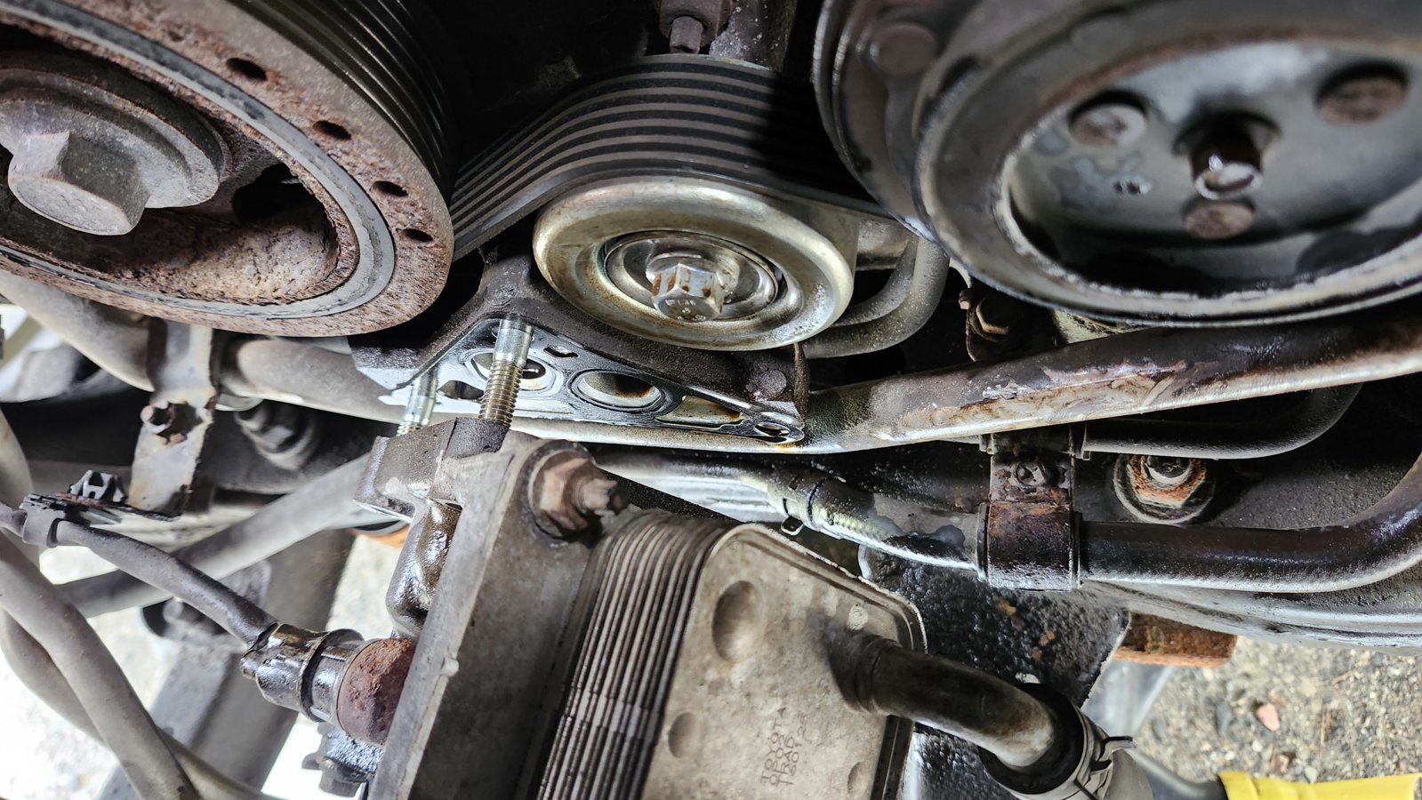

    Has anyone had to replace the lower idler pulley on a third gen Tacoma? It looks like the oil cooler needs to be removed in order to replace this pulley.17222722944612265553685613349797.jpg

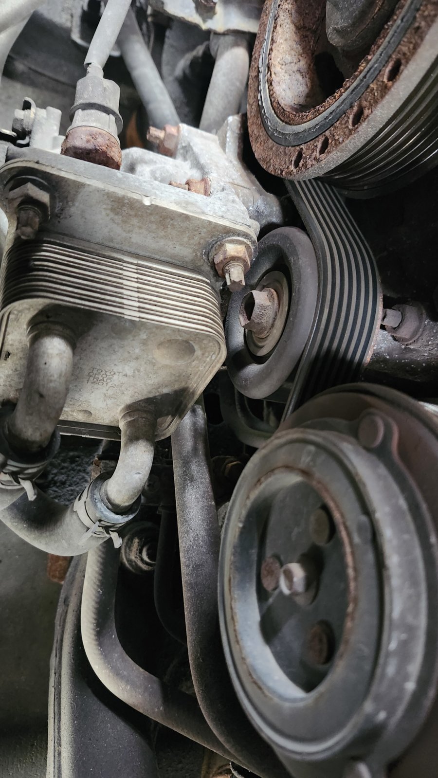

    I think I got it sorted. Just had to loosen the oil cooler off. Had just enough room to remove the pulley. Only lost a tiny bit of oil. Going to clean around the mating surfaces the best I can and hope it doesn't leak! 17222775545795446757299384942540.jpg

    Thanks. There was one long bolt that went right through the cooler and it was a real bugger to get out. Squeaking almost all the way. I thought it might break but managed to get it out. Ran a die over the threads afterwards and it went back in like butter. Otherwise the job was pretty straight forward. Just very awkward.
