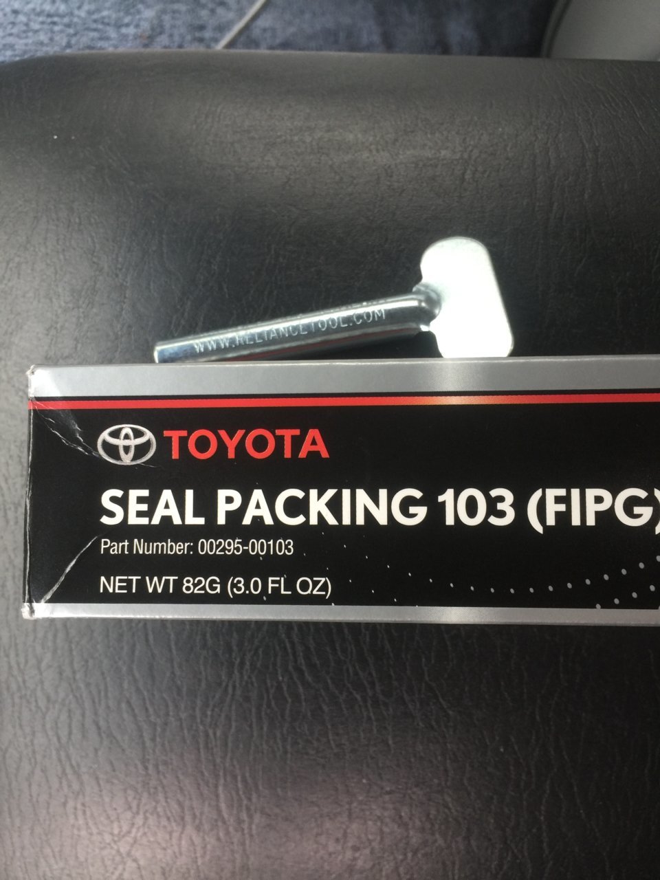

    Too many to list, and I've probably forgotten a bunch.
    What's the P/N for the Toyota FIPG? I've found a couple, not sure which the lower oil pan uses.
    Capespencer68[OP] likes this.

    Says for Oil Pan/Camshaft Housing.

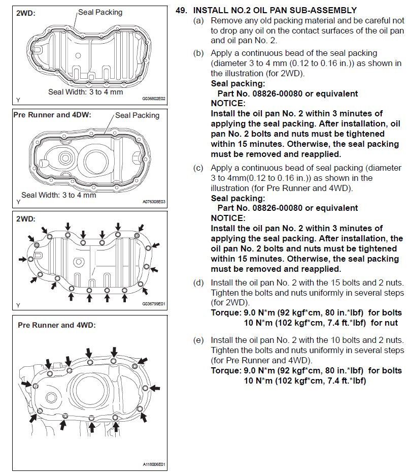

  14. Nov 14, 2020 at 6:19 PM

  15. Nov 14, 2020 at 6:44 PM
    TnShooter
    TnShooter The TacomaWorld Stray
    Sep 2, 2010
    #42625
    21,280
    Deogee
    07' TRD Off-Road, Auto
    STOCK
    Those TQ specs have always been confusing.
    I believe it’s 80 INCH for bolts.
    And 7.4 Ft/lbs for nuts?
    Capespencer68[OP] and Jimmyh like this.

    #16
    caribe makaira
    caribe makaira Well-Known Member
    Feb 13, 2011
    #51121
    11,786
    Caribbean, Puerto Rico
    05 PreRunner TRD Offroad AutoTrans
    Hood Struts, My version Fogs always ON, Map & Overhead Light Mod,
    I think it's a typo in the manual.
    1 N m = 0.74 (0.73756)
