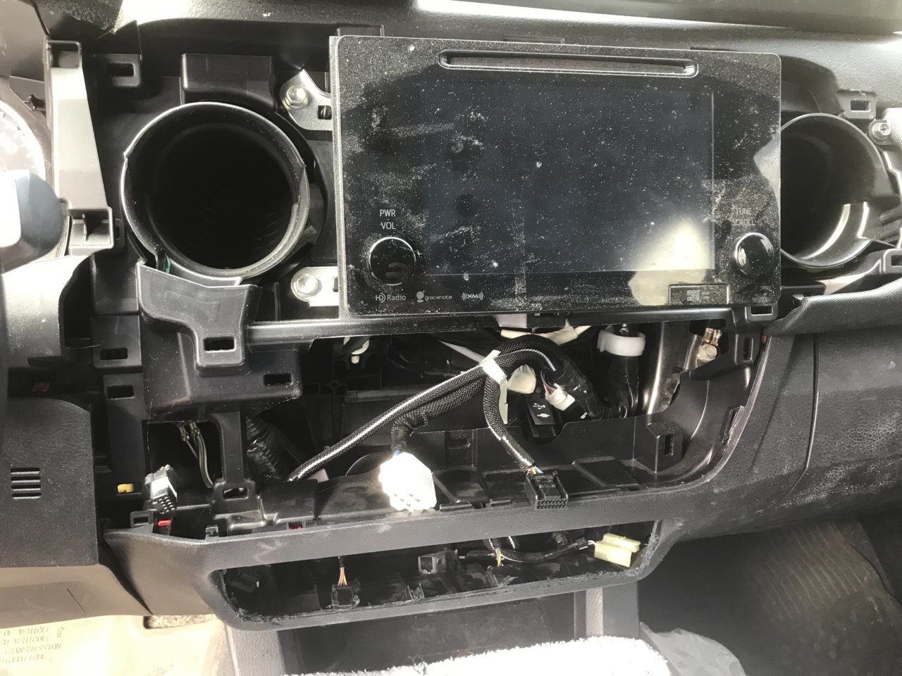

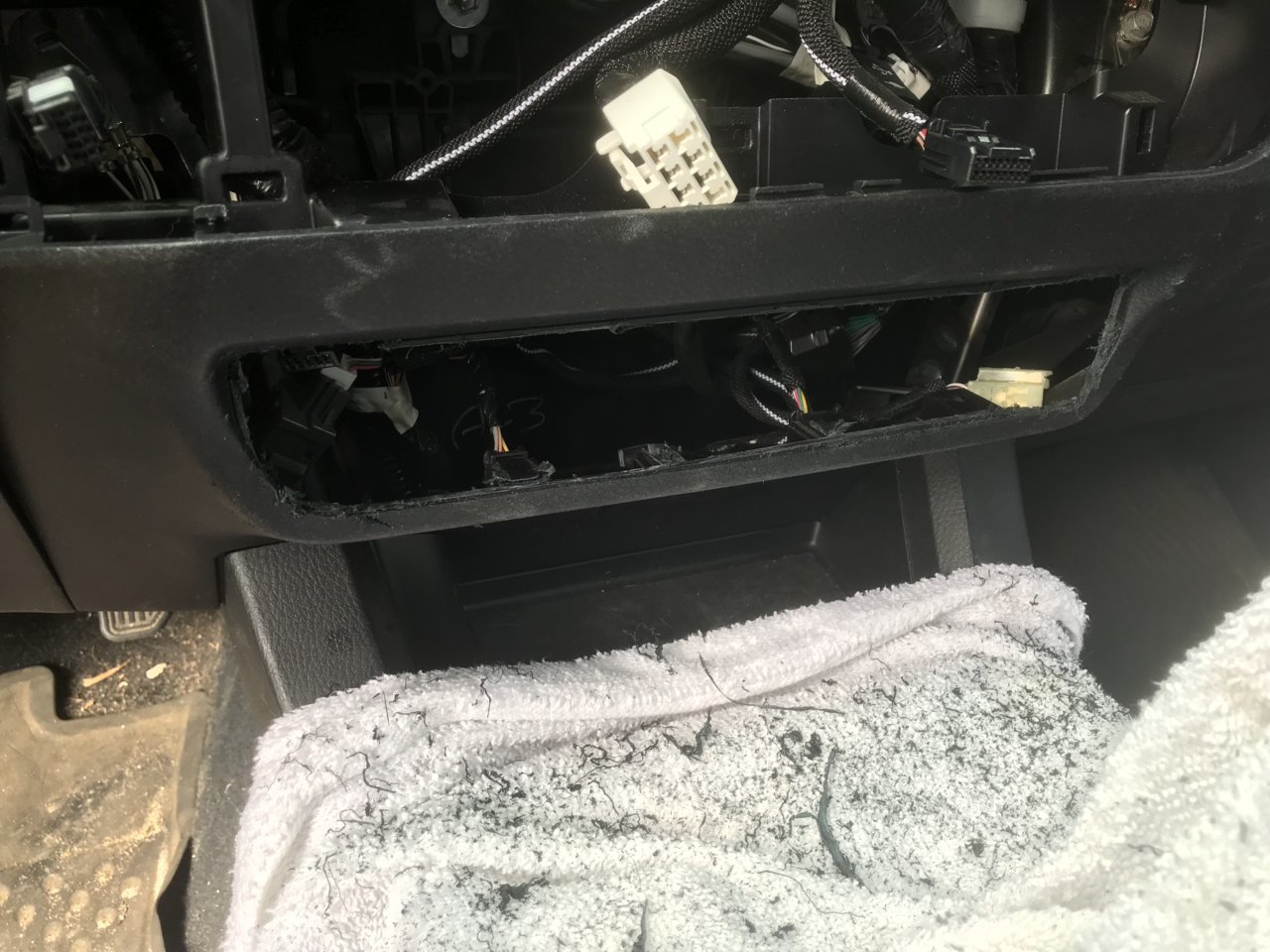

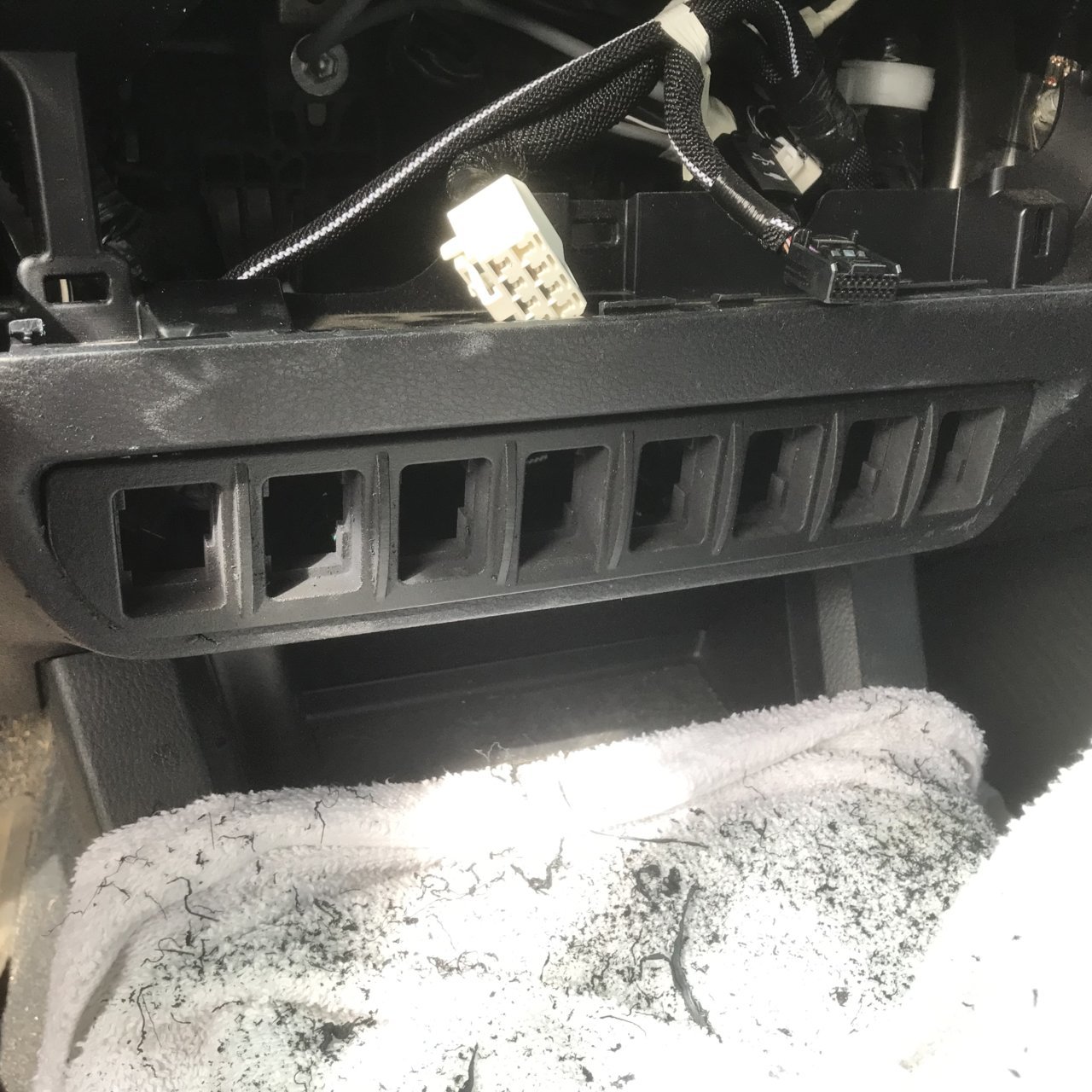

    Replaced the Lower switch bezel under the AC knobs. I install a 8 switch Meso Customs bezel
    I was able to use my an oscillating tool to cut out the area needed without disassembling many parts of the dash, just had removed the bezel around the radio, the ac control panel, and disconnect all the harness and switches on the panel that i was cutting out. Then hot glued the new switch bezel in place. I can access the back of the switch by just removing the radio bezel and ac controls.

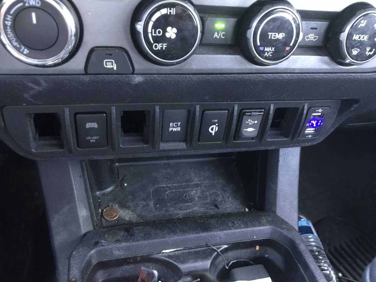

    I did it the same way using a utility knife. I also screwed up a bit since I was installing the LSP7, I cut out the power outlet part also. It looked just like yours. That part should have remained for the LSP7. My bad, but it works great regardless.
