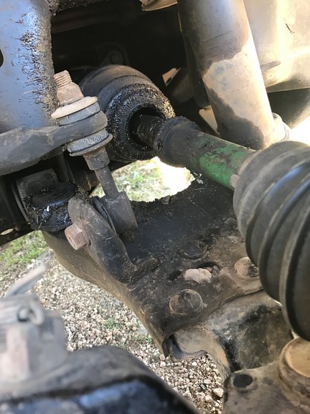

    I have a 1995 tocoma and the 3 of my bolts fell out of my right lower ball joint. The last one snapped And I need to know where to buy them. I can't find them and if I could have screwed up anything else.

    Were you driving when this happened? If so then yeah there's probably more broken than just the ball joint, got any pics?

    I parked because I was driving funny and as I got out to check the last bolt broke. My cv joint I think it what it's called came out of the boot.
