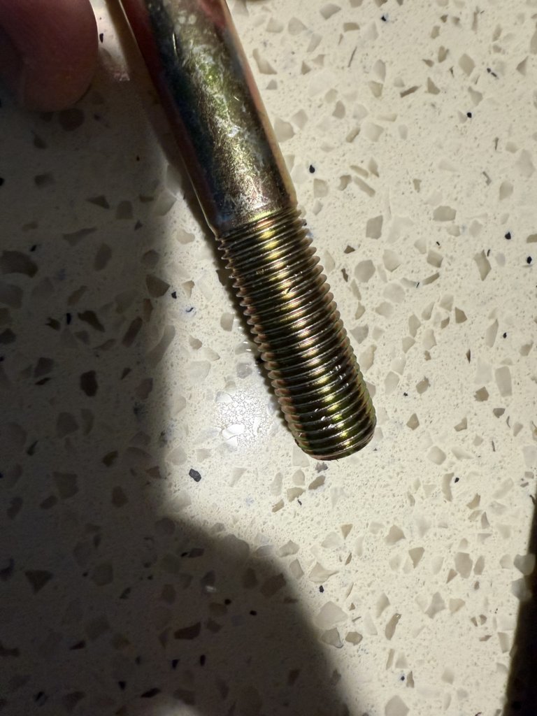

    Those don't look perfect, but they don't look terrible either. Did you try running a nut over them? If the nut goes on and off without too much force just using your fingers, I'd use them. I got mine from 303, but USPS didn't mess things up. I didn't look at them that closely, but they went on just fine.

    They're galled just enough that the nut doesn't thread. I'm going to try ace hardware. Maybe they'll have something large enough to chase the threads on the bolt.

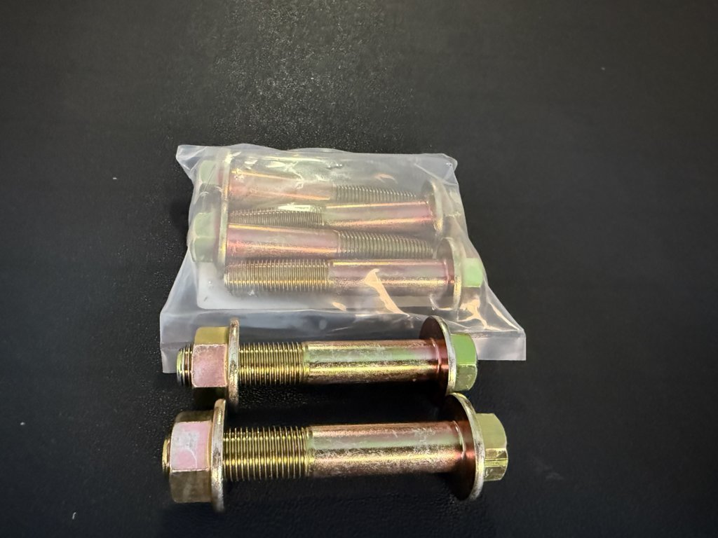

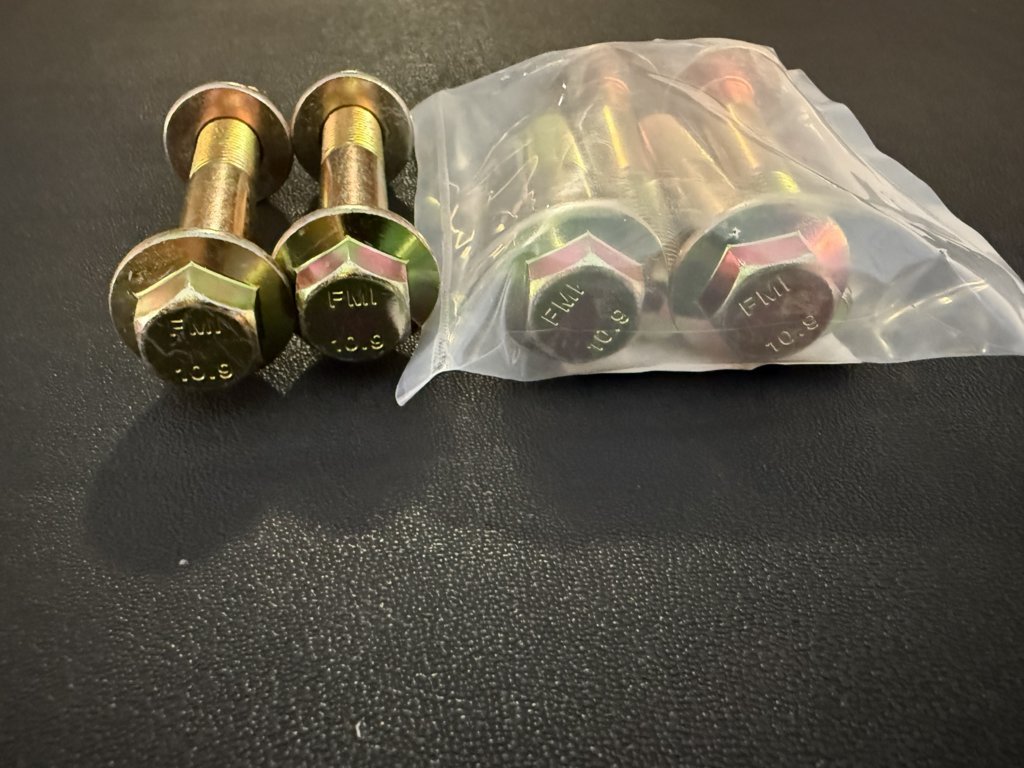

    4 fresh bolts from Belmetric arrived today. They're literally the exact same thing; same socket size, stamp marks, everything. I have spares now. :rolleyes:

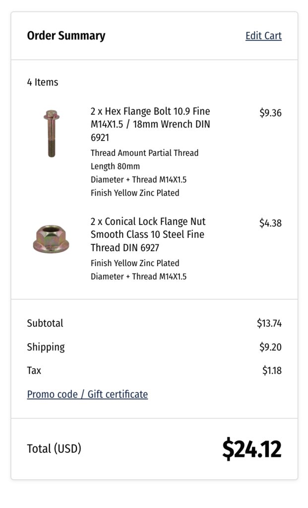

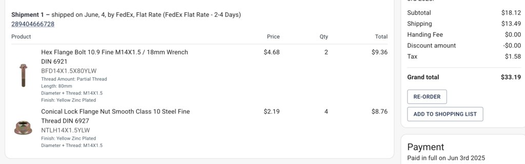

    I have a set of 2 bolts and 4 conical lock nuts that I can't use (YELLOW ZYNC). I paid $33.19 (screenshot) with 2-4 day shipping.
    $20 and I'll include standard USPS shipping to you in the lower 48 states. Looks like the cheapest shipping option for 2 bolts and 2 conical lock nuts is about $24 (screenshot).
