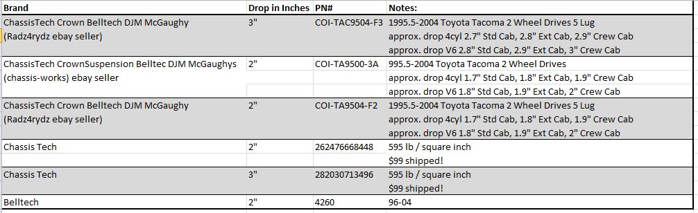

  3. Feb 22, 2020 at 12:37 PM
    #2603
    2Runner
    2Runner Well-Known Member
    Jan 20, 2020
    #316661
    1,042
    Scott
    So Cal
    2002 Regular Cab 2.4L MT 2WD
    I have not done my drop yet or I would have a bit more insight for different springs probably! There really is just Chassis Tech or Belltech, and maybe one more generic builder when searching for these coils on the bay. From what I heard, Belltech will give you the more compliant ride.
    However, stock length shocks will work though it may be a good time to replace shocks if you haven't in a while. Then again, if you change springs and shocks it may be more difficult to gauge which parts affect your ride. This all said, I plan to change springs first to see how they feel and likely will be adding shocks in the near future afterwards to smooth out the handling. I slapped together all I could find so you/and all can weighs the current options in both 2" and 3", see the notes where the give you the approximate drop based on your model (also see brand, the top 3 are the generic sellers listed every company that ever made drop springs just about!):
    And here is the links to parts above, in order. Wish I would have grabbed the prices for each above but they vary from $100-$170 roughly):
    https://www.ebay.com/itm/1995-5-200...-Kit/272346211408?fits=Year:2002|Model:Tacoma
    https://www.ebay.com/itm/1995-5-200...-Kit/261929272225?fits=Year:2002|Model:Tacoma
    https://www.ebay.com/itm/1995-5-200...-Kit/272346208778?fits=Year:2002|Model:Tacoma
    https://www.ebay.com/itm/D-Coil-Spr...?fits=Year:2002|Model:Tacoma&_trkparms=ispr=1
    https://www.ebay.com/itm/D-Coil-Spr...COMA/282030713496?fits=Year:2002|Model:Tacoma
    https://www.ebay.com/itm/Belltech-4...3?fits=Year:2002|Model:Tacoma&epid=1324201520

  9. Feb 25, 2020 at 11:04 PM
    #2609
    2Runner
    Jan 20, 2020
    #316661
    1,042
    Scott
    So Cal
    I took a closer look at some stock coils from a salvage yard today and found they are not really the type of coils you want to cut safely, and I like safety kinda. They have one pigtail end and one squared end. You really only want to cut coils if they are the tangential type from what I read, see below for reference.
    This is getting me to rethink my direction, I want close to a 3 inch drop up front but not sure if I want to do the ball joint flip hearing some stories of bump steer. Could be worth trying for myself though since it's cheap enough. Or maybe some one can lend their experience on the flip and how it drives here if they feel like BSing!
    I may be leaning towards getting some custom coils made by Deaver to improve the rate anyhow for better handling and get my exact desired drop.. and think I will give them another call to discuss a bit further since they are going to re-arch my leafs anyhow.

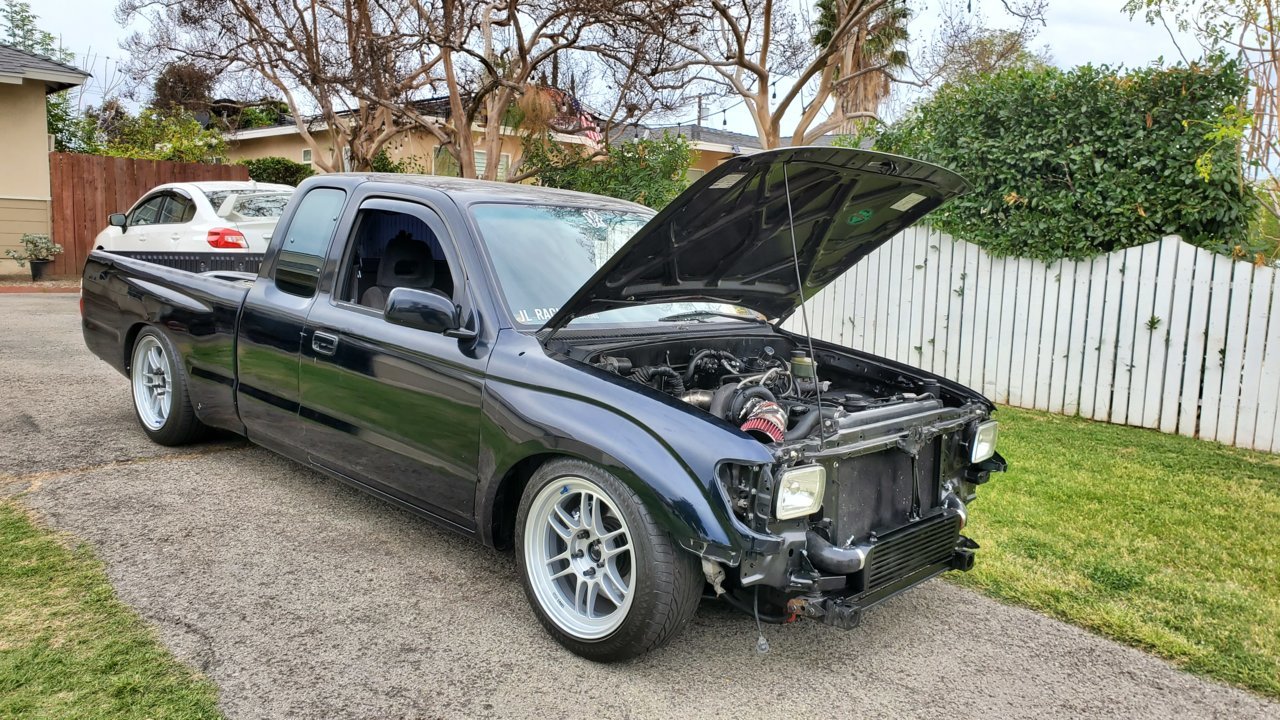

  19. Mar 10, 2020 at 12:09 AM
    #2619
    mjbtaco
    mjbtaco [OP] low and slow
    Mar 21, 2008
    #5423
    4,825
    Michael
    Montclair , so cal
    Turbo'd 95.5 extra cab and 2013 Silver DCSB TRD Sport
    PERFORMANCE Custom Turbo Setup FRONT SUSPENSION Drop Spindles by Aaron Carswell 01-04 Swaybar Endlinks Energy Suspension Endlink Bushings Cando Upper Control arms QA1 coilovers with 8" spring Custom 4 pot Brembo BBK Modified lower control arms with mjbfab qa1 mounting plates and Poly bushing sleeves REAR SUSPENSION Chasis Tech drop leafs QA1 adjustable shocks weld in drop notch Gas tank cross member bridge 3" angled blocks 2013 Double Cab Short Bed TRD Sport Eibach Pro Truck Shocks front and rear Lifted to the 3rd setting on the front shocks
    Got this thing out for a drive around the block yesterday.

  20. Mar 10, 2020 at 12:15 AM
    #2620
    2Runner
    Jan 20, 2020
    #316661
    1,042
    Scott
    So Cal
    Nice to see!
    So where do you get her smogged?!
    I want some power adders too and live in Ca...
