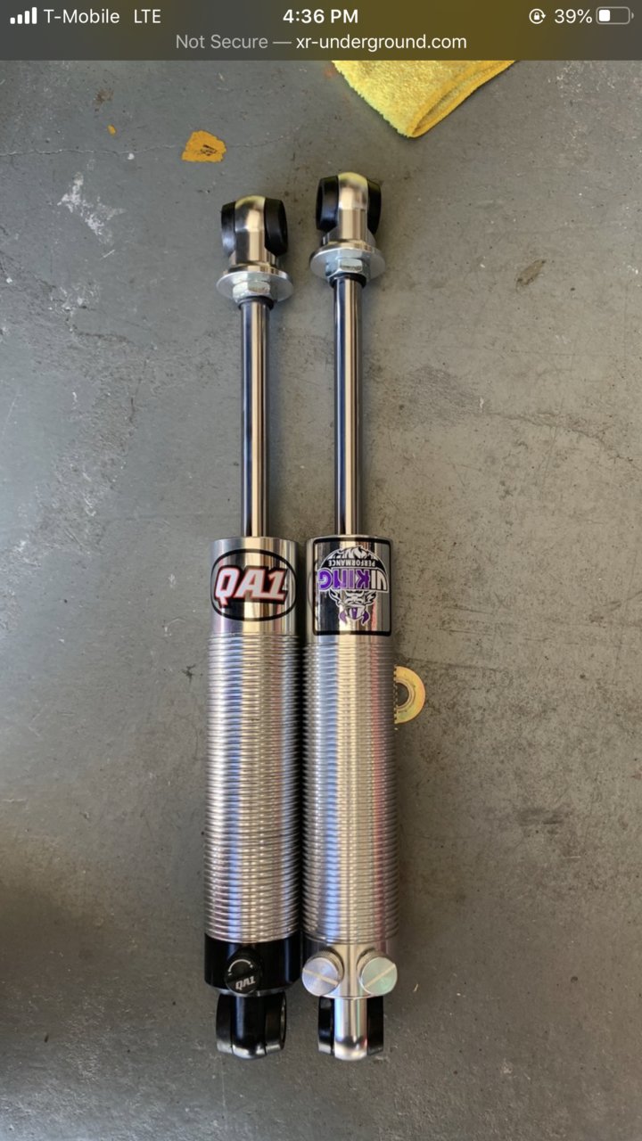

    Yup! So what would be our ideal length for coilovers? You have any specs on your ohlins? I’m guessing there will not be any physical fitment issues. Only need that bolt pattern which shouldn’t be that hard.

    So is anybody else interested in a set of viking coilovers if everything lines up right for us 6 luggers?

    What where XII Performance used for there coilovers, is what I first used. Then had the Ohlins built around those. I used the ProComp strut tower adapters. I wanted to upgrade to the King ones, but never got around to it.
    If the Viking ones are similar to the XII ones, then you're pretty close to being in business.
    The only problem though, is these coilovers don't have the standoff, like the OEM ones. The standoff at the bottom, which allows them to clear the axle shafts.
    That would have to be discussed.

    The main reason for shortening the knuckles is to provide better range on adjustable UCAs and more important the angle of the UCAs. You want the UCAs more parallel to the ground vs perpendicular.
    I think like @Torspd said... The stand off and clearance for the bottom is the main concern while the bolt pattern for the top should be the easy part. Where as these Viking adjustable shocks can be built to any length.

    Yea I understand the reasoning for shortening the spindle but wondering if they going to use little shorter coilover to make up for shorter spindle . Then again that 1 in might not make a difference in my case .
    Mines a prerunner so no problem with axle clearance . Will follow thread to see what you come up with . :thumbsup:

    So according to this from @arcenik 6lug is 3 1/2 in bolt pattern. He went from Qa1 to viking

    So bolt pattern for coilover mount bolt pattern 3 3/4 ? Can you guys make a mount with 3 1/2 bolt pattern ?
