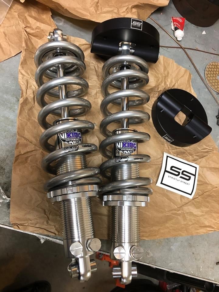

    I cant remember what they off hand. I have to look at my drawings.
    I can rotate them 180 degrees and add a second set of holes to make them compatible.

    As long as there is enough clearance through the control arms for a 4" diameter spring we should be good.
    I can configure the lower mount to any size we need

    So been in contact with @easts1d3 . Since prerunner is 2 in longer he said he can get strut 2in longer and redrill bolt pattern for mount . @TRON @Torspd you think xrunner spec strut would work. Extended length ? Will try to measure mine today . Soon as I, we find something :spending:
    @easts1d3 whats the thickness of mount ?

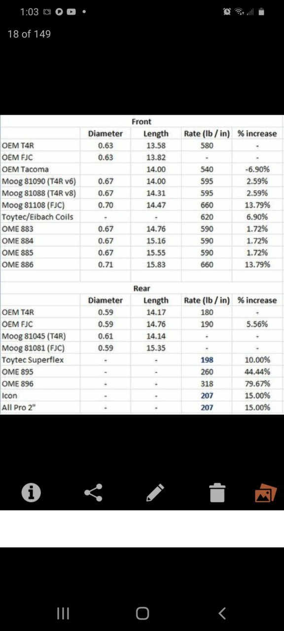

    Here is some information that will aid.
    My picture is too blurry for the springs, unfortunately.
