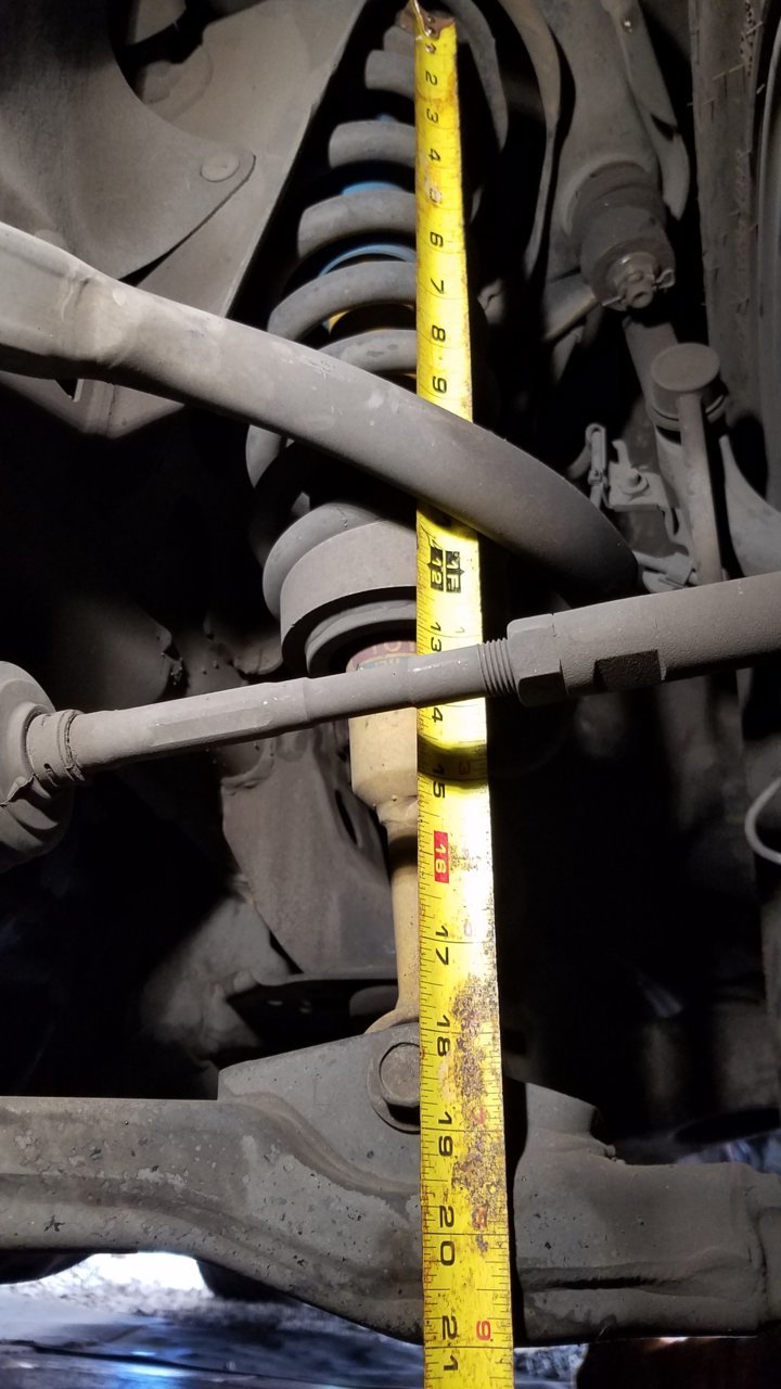

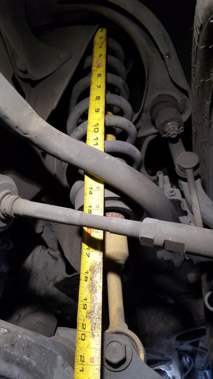

    So measured static height 18 3/16
    Extended 20 1/2 . Might be inch or so less depending on were center of eye sits on new coilover and mount So guess need to talk to @easts1d3 for custom lenght . Just need to take into consideration the mount thickess.

    Yup I got 18 3/16 as well. Are you on the TR lowering kit?
    Also @easts1d3 the stock springs are little over 4 inch diameter. And the trans axel from the stock stand off distance is about 1.25 inches. I’m not sure if this is same distance whether wheels straight vs turned?

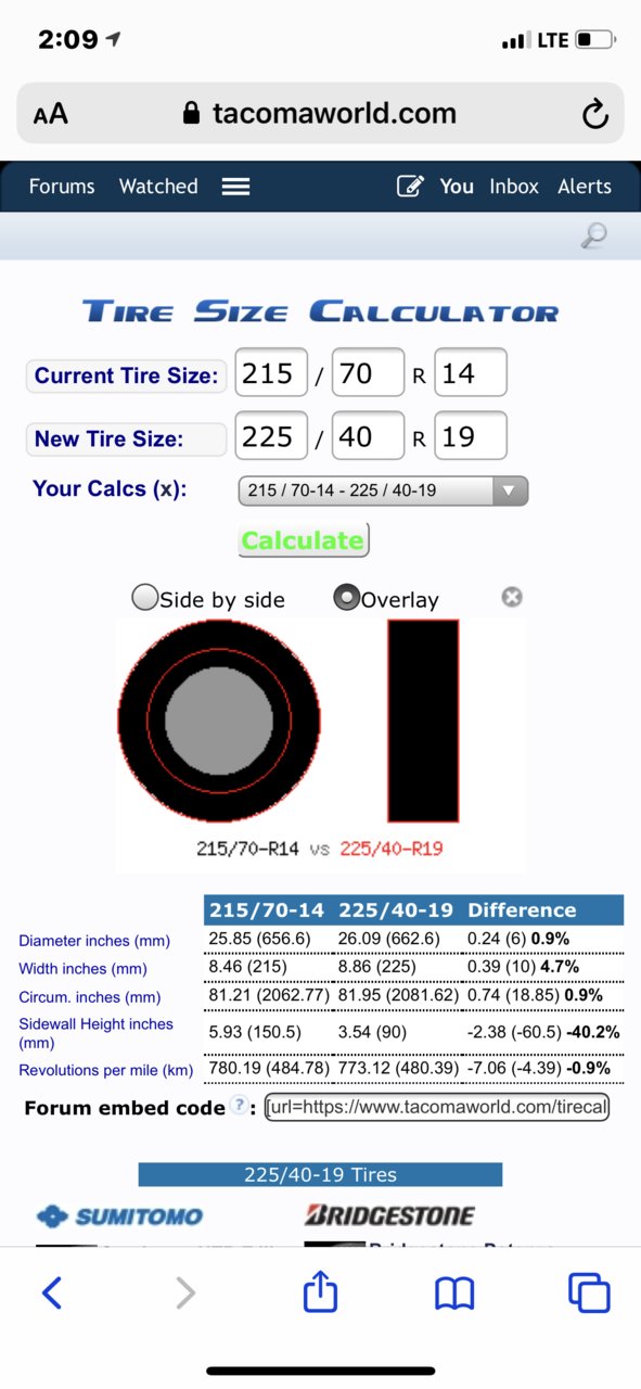

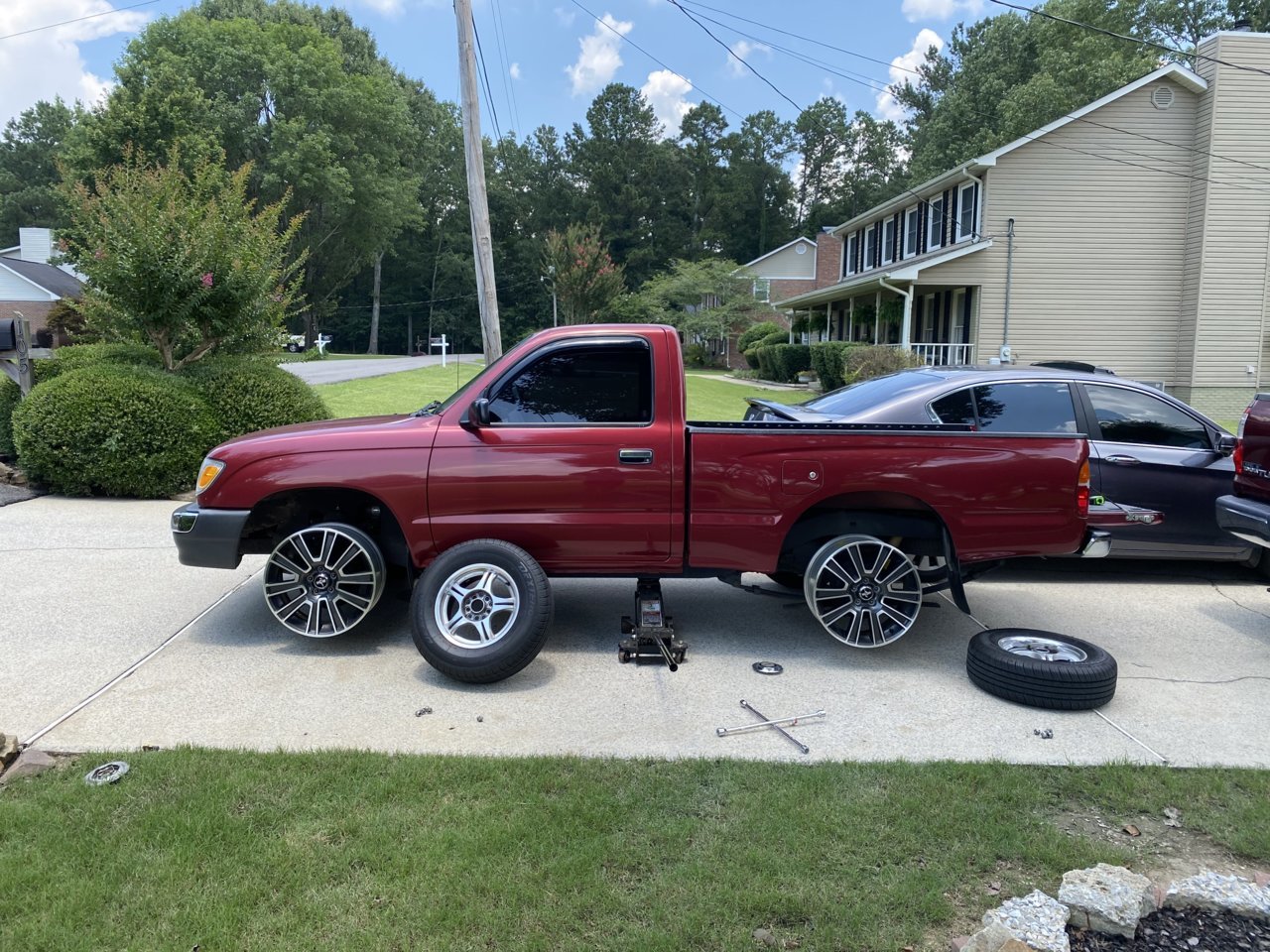

    BEAF6FF7-F9CB-4DEA-8875-5398AFAFDA1D.jpg 3D74DB71-DACB-4FDF-A350-E9217D9C9F89.jpg Hoping to get some help. I have a 99 single cab and I have came across a set of 19 x 8 1/2 Mustang wheels. I put them on yesterday and they seem to fit. The only thing I’m worried about his tire size. I’m thinking a 225/40r19. Does anyone have any experience with the size wheels or have any input? Thanks

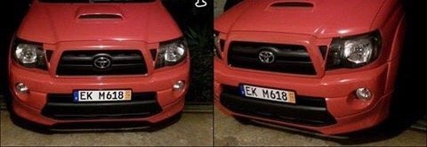

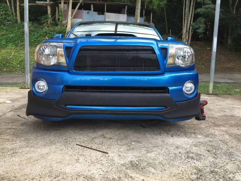

    @hemitruk do you know anything else about this front spoiler. The picture looks like one piece but is it just the two sides for the 12-14 xrunner?

    Dont know about redone but the blue one looks like the 12 to 15 one

    I know the guys in Puerto Rico make there own too .
    EDIT Looks like the red and the blue one are the same . I believe they make it out of fiberglass. Looks one piece on blue one . 2011 down lower grill different from 2012 up .
    pic you can see lower grill seperate from spoilers and angles out .
    If you wanted to add one you would have to use 2011 down one .

    I’m probably gonna keep my 2008 front spoiler and install a splitter underneath. The trick is make the stock front spoiler/air dam continuously flat all the way across for the splitter. So it looks like piece @hemitruk

    Yea forgot you put the xrunner kit on . Guy in Hawaii added the air dam on 2nd gen to 3rd gen conversion and he also did a 4dr prerunner with xrunner kit . On instagram digthistaco .
