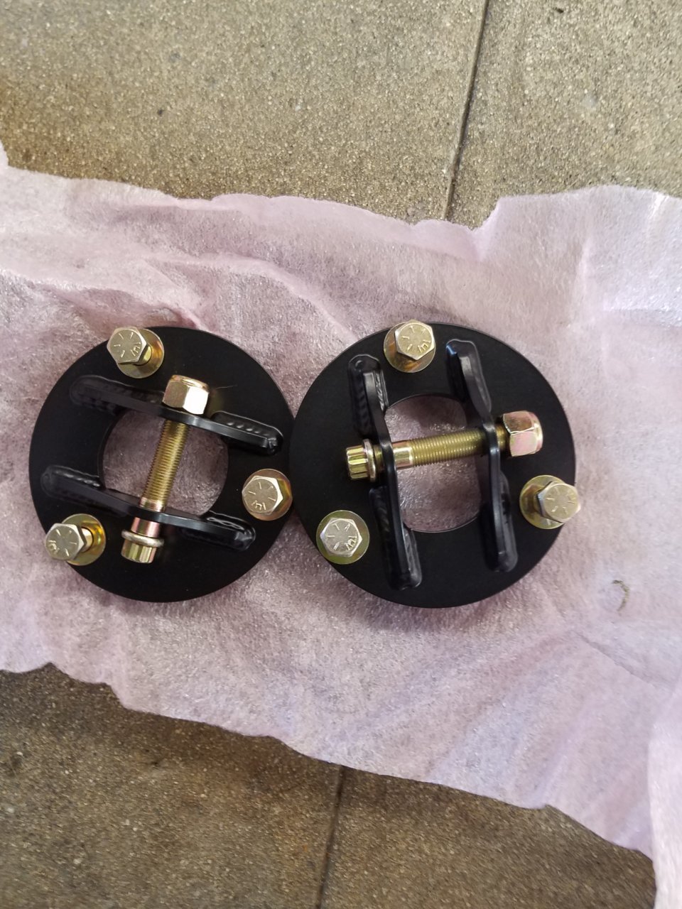

    So ordered dirt king mounts . Usps shipping to Hawaii $32 :facepalm:Thinking going with 19.85 extended 12.85 collapsed 1/2 in bearing mount top bottom Vikings . I measured 20 1/2 extended on mine .Springs going with 14 in 550 pound . Thoughts ? Will talk with Viking when mount comes in . 3 week lead time.

    You going to keep the TR lowering kit spacers installed for the sway bar? And are you anticipating a 1 inch drop lower than the TR kit with this set up or about same just more stiff

    I just looking for better ride quality with the adjustable coil overs . Looking for just 2 in drop like TR kit. If had chopped spindles might have gone for 3 in drop. As far as sway bar spacer just need to see how clearance is .Thinking of going with the 550# springs since stock ones 540# .With the 2 in drop and shorter bump stops I dont have problems with bottoming out .

    So talked to Fab Quest about the vikings and 19 in extended only come 350# max spring rate . So either need to go with the 19 in extended and need to find 2.5 id 14 in spring with up to 600 # rate or go with 17.85 that has springs rated up to 600#. 17.85 ones has 6 in of travel so thinking should be ok getting to height Im looking for .Need to get more info .
    Edit If going with 17.85 thing going to need 2 in extender :annoyed:

    PAC springs, I believe is the name.

    Maybe PAC Racing springs?

    Saw Eibach got 14in 2.5 id springs . Think going with 550 # springs since close to stock #s according to your chart . Got about 1 in gap at bump stop ,got shorter ones.

    Checked out . Its valve springs . Eibach got what I looking for . Thanks :thumbsup:

    When I was looking for springs for mine, they had higher ppi rated ones than Eibach. They are where I ordered my front springs though. Unless something changed and they no longer sell suspension springs.
