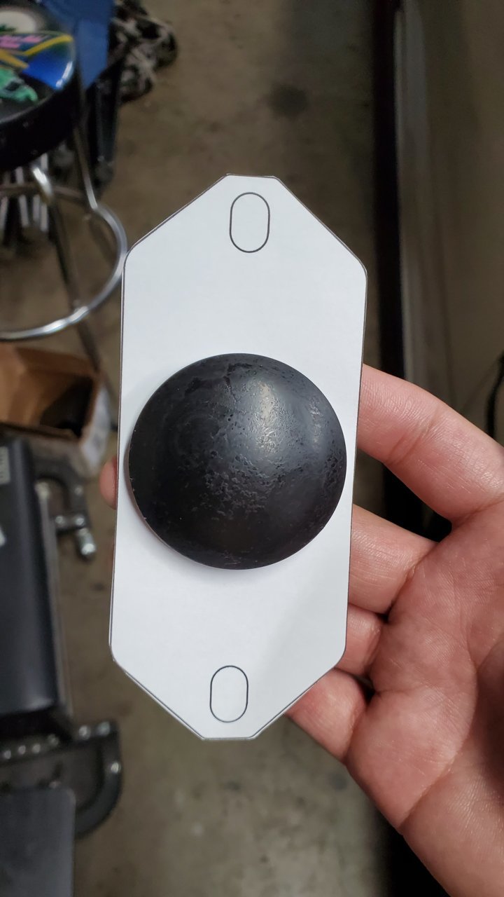

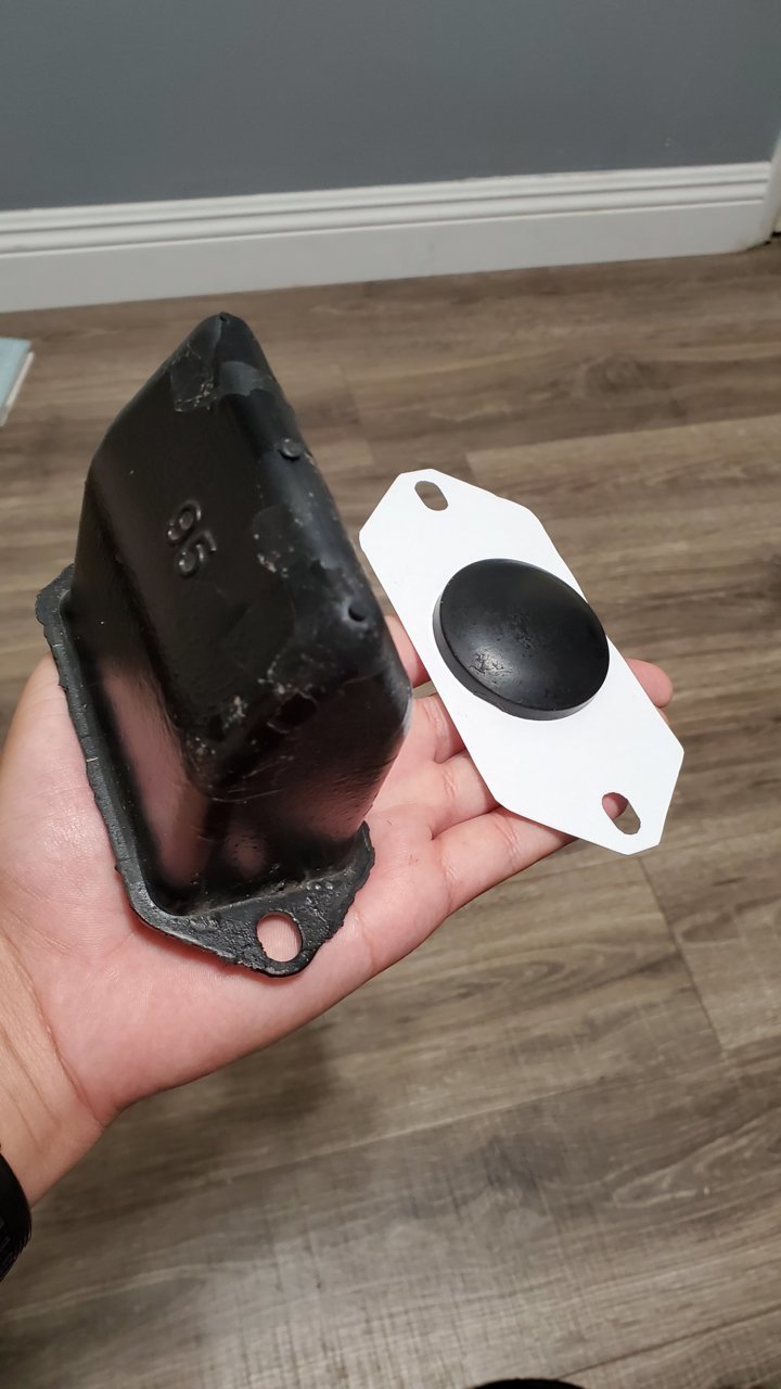

    Believe it or not, I finally have the date set with Deaver to de-arch my rear leaf springs for my drop coming up at last. I was wondering if you ever got those low profile bumps stops together by chance and want to sell any?

    PERFORMANCE Custom Turbo Setup FRONT SUSPENSION Drop Spindles by Aaron Carswell 01-04 Swaybar Endlinks Energy Suspension Endlink Bushings Cando Upper Control arms QA1 coilovers with 8" spring Custom 4 pot Brembo BBK Modified lower control arms with mjbfab qa1 mounting plates and Poly bushing sleeves REAR SUSPENSION Chasis Tech drop leafs QA1 adjustable shocks weld in drop notch Gas tank cross member bridge 3" angled blocks 2013 Double Cab Short Bed TRD Sport Eibach Pro Truck Shocks front and rear Lifted to the 3rd setting on the front shocks
    As a matter of fact I just finished the design. Just sent my files off to the laser cutters just waiting onna response so I should have some in stock with pricing in the next few weeks.

    These look very clean I like how the mimic the oem shape. Let me know when they will be ready please as I will need some hopefully around October 24th!

    Should have them by then I'll keep you posted

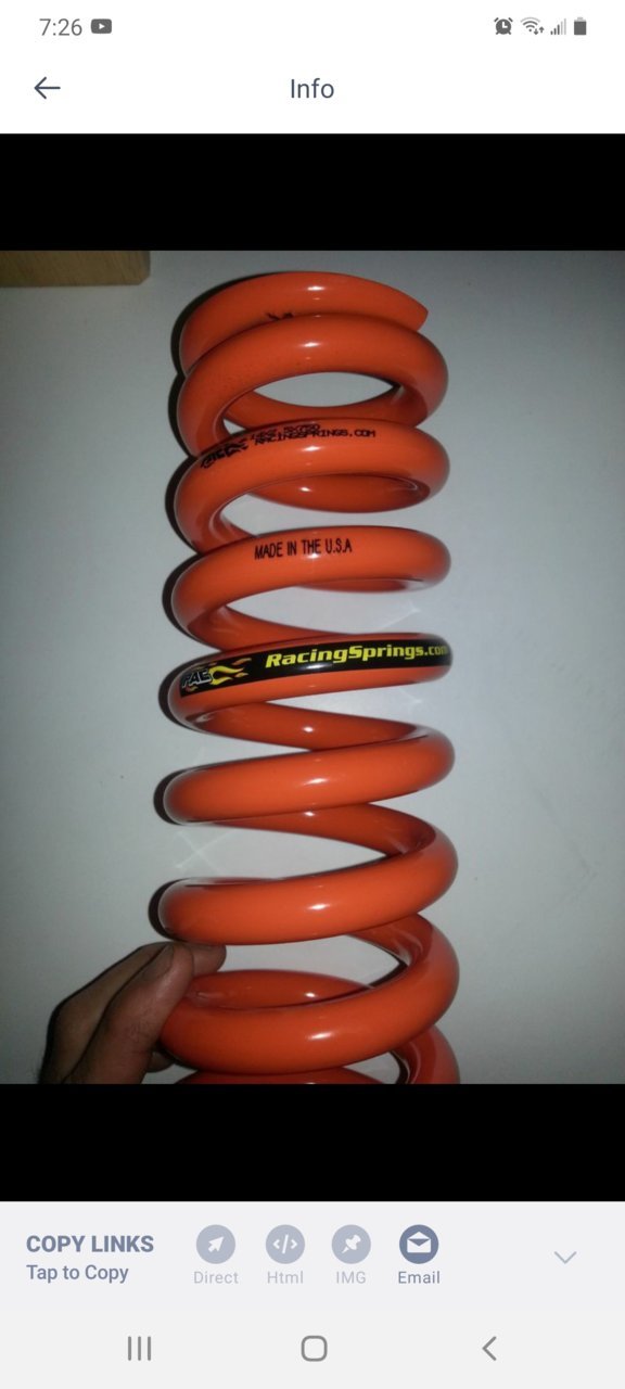

    So got coilovers from viking. Final piece of puzzle. @TRON can down load Viking coilover application chart . Got all specs on extended , compressed and ride height . Just saw this last night . Got the C219 about. 1/8 in less than my ride height put think should be ok . The C215 seems would have been better . Talked to guys at fabquest and said C219 should be good so ordered that .
    So those with 4wd axle clearance might be an issue

    So put coilovers on today . Love it . Rides a lot better . Now to play with adjustments Would have been easier to adjust inverted but preloaded 3 in was pretty much spot on
    Height was 32 5/8 rt and 32 3/8 lt side . Got it 32 in now . For 4wd guys more room for axles mounted this way . Still not sure if got enough clearance for axle .
    Going to look for viking dual adjustable for rear now .
    B212 ordered .
    Fab Quest
    coilover kit less springs $460 +$65 ship to Hawaii
    Dirt King Top hat mount $115 + $32 shipping
    Eibach coil springs $140 + $15 Fedex ground to Hawaii .Heaviest item ended up being cheapest to ship .Fedex yet lol
