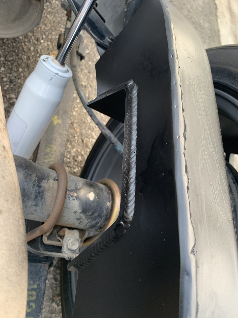

    Thanks, my buddy has a waterjet that made the cuts nice and clean once we drew the plan on the pc. First time using one of these for me..
    As soon as you told me that based on YOUR experience the frame will bottom out before the shocks I thought this sounded good enough to me and I took your word for it.. heck you are the originator of the "Lowered BS Thread" after all which makes you the current expert in the "world"!!
    If my shocks go out I am glad I have the mjbtaco guarantee to fall back on here!! :rofl:

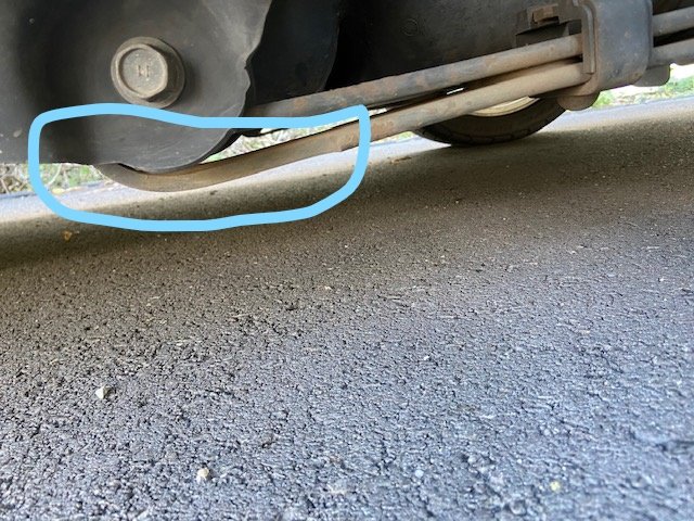

    Last, can anyone confirm that only the 2nd gen 4x4/prerunner leafs have the "floating end" on the middle leaf (see pic):
    The leafs have been coated so I can't see the part #s.
    Thanks in advance for your help!

    My truck is lowered. Adding the XR leaf springs, netted me a little lift ,over the original 4x4 springs, as well as a stiffer set of springs. Which also translated to less axle wrap.
    Pretty sure the XR leaf springs look the same.

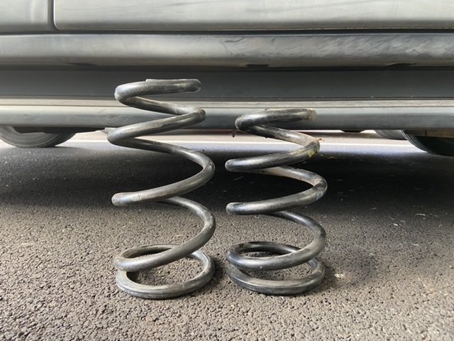

    I made some progress; haven’t seen this documented before so maybe it will be helpful.

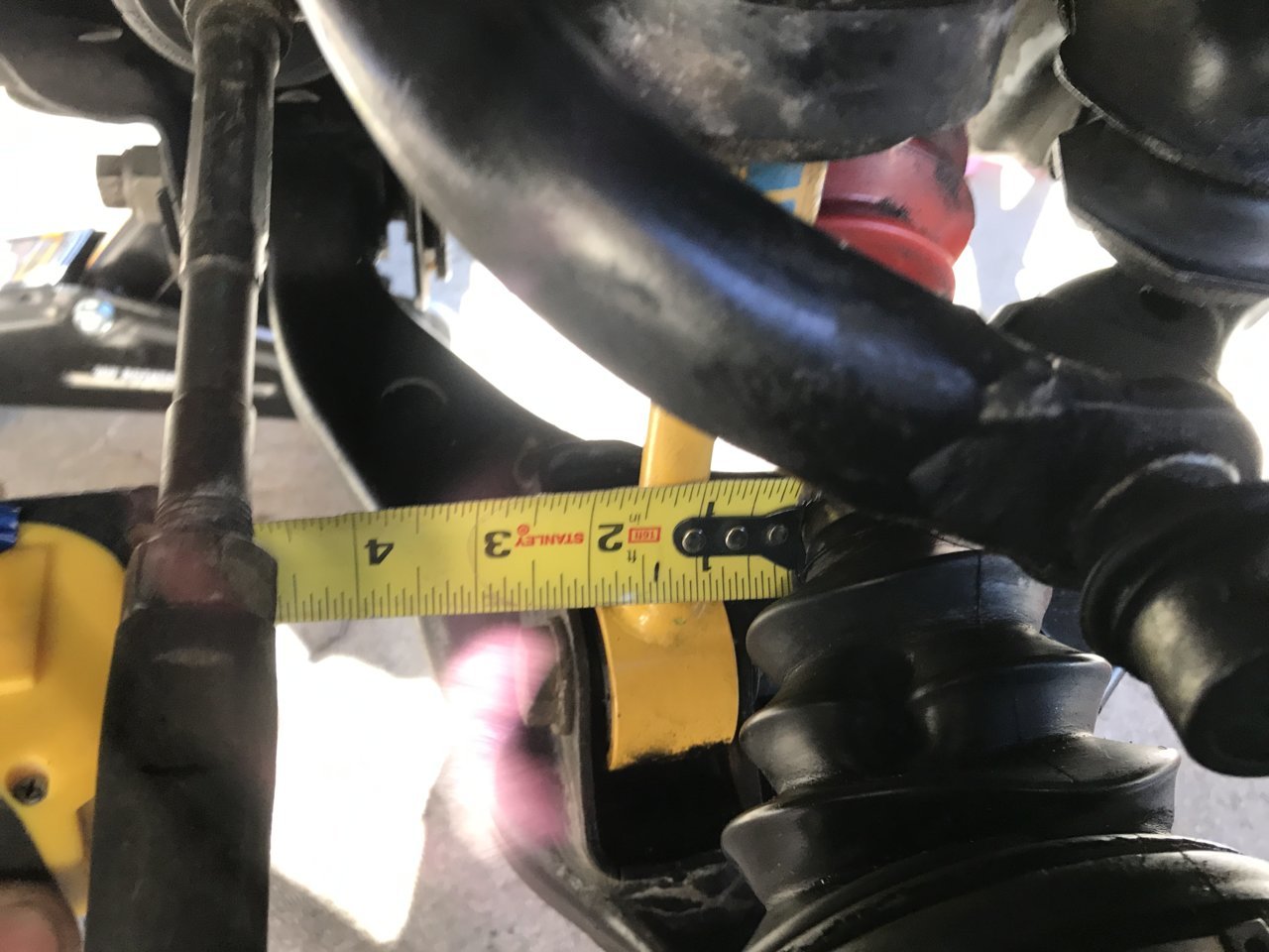

    Found some stock front springs for my base Tacoma, and made the swap. I forgot to take pics before getting started, but here is a pic of base (left) vs xrunner (right) front springs:
    Measured with a cheap caliper, they’re about 1 3/4” shorter, and Xrunner coil is slightly thicker. Used the same bilstein shock.
    Start: front was 15 1/4” axle to fender. End: axle to fender is now about 16 1/4”. I’m thinking it may settle some in the next few days so I’ll make note of there is any significant change. I also changed the bump stops on the Calmax control arms (one actually, the other I think is stripped and won’t unscrew) - a lot less banging around now :thumbsup:

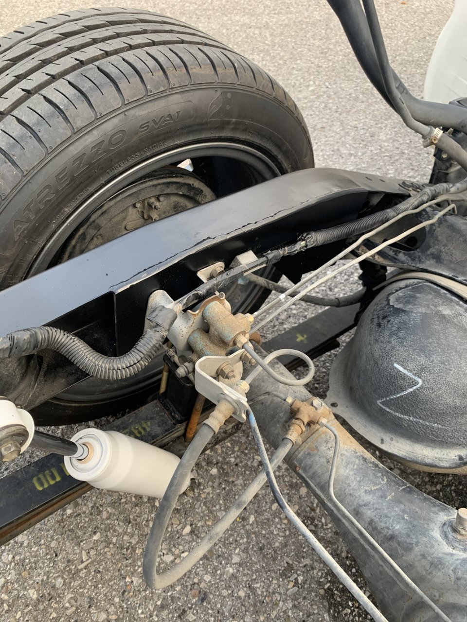

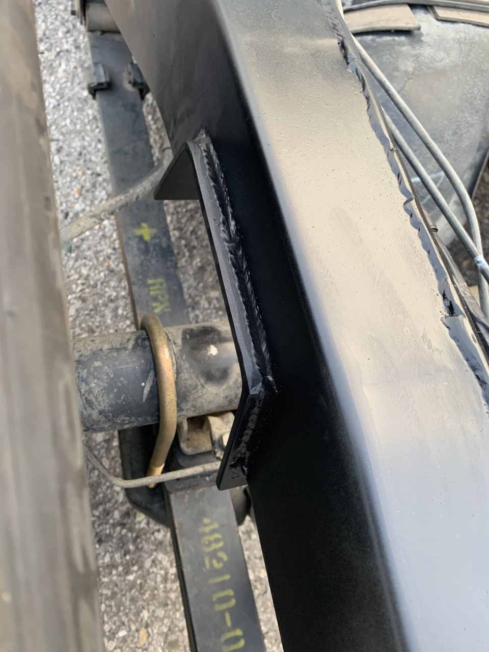

    finally got the rear c notched shit imma go lower

    thanks for your reference to rohde fabrications, that mini c-notch kit he sold was great

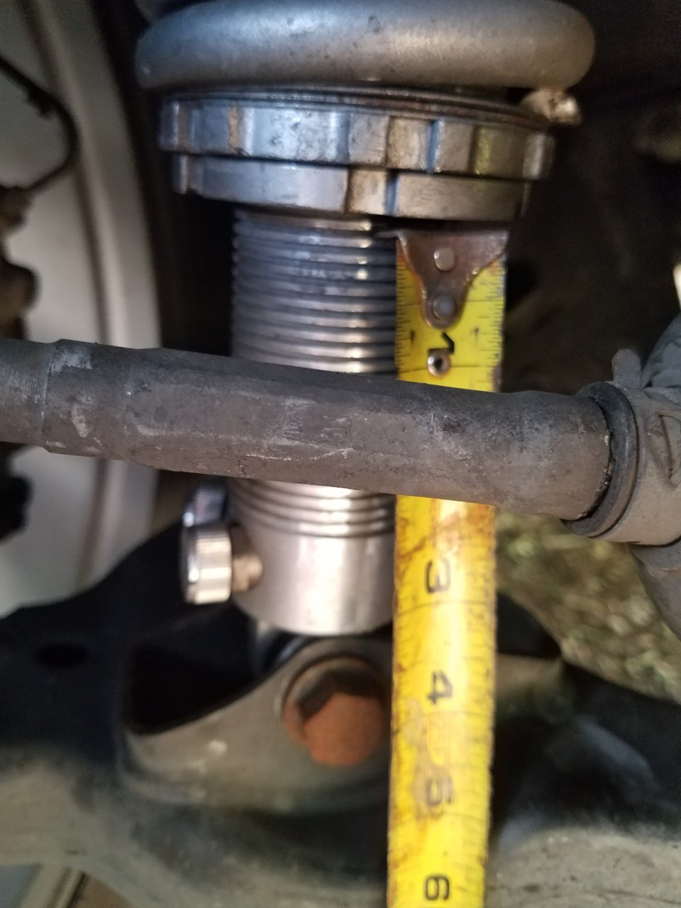

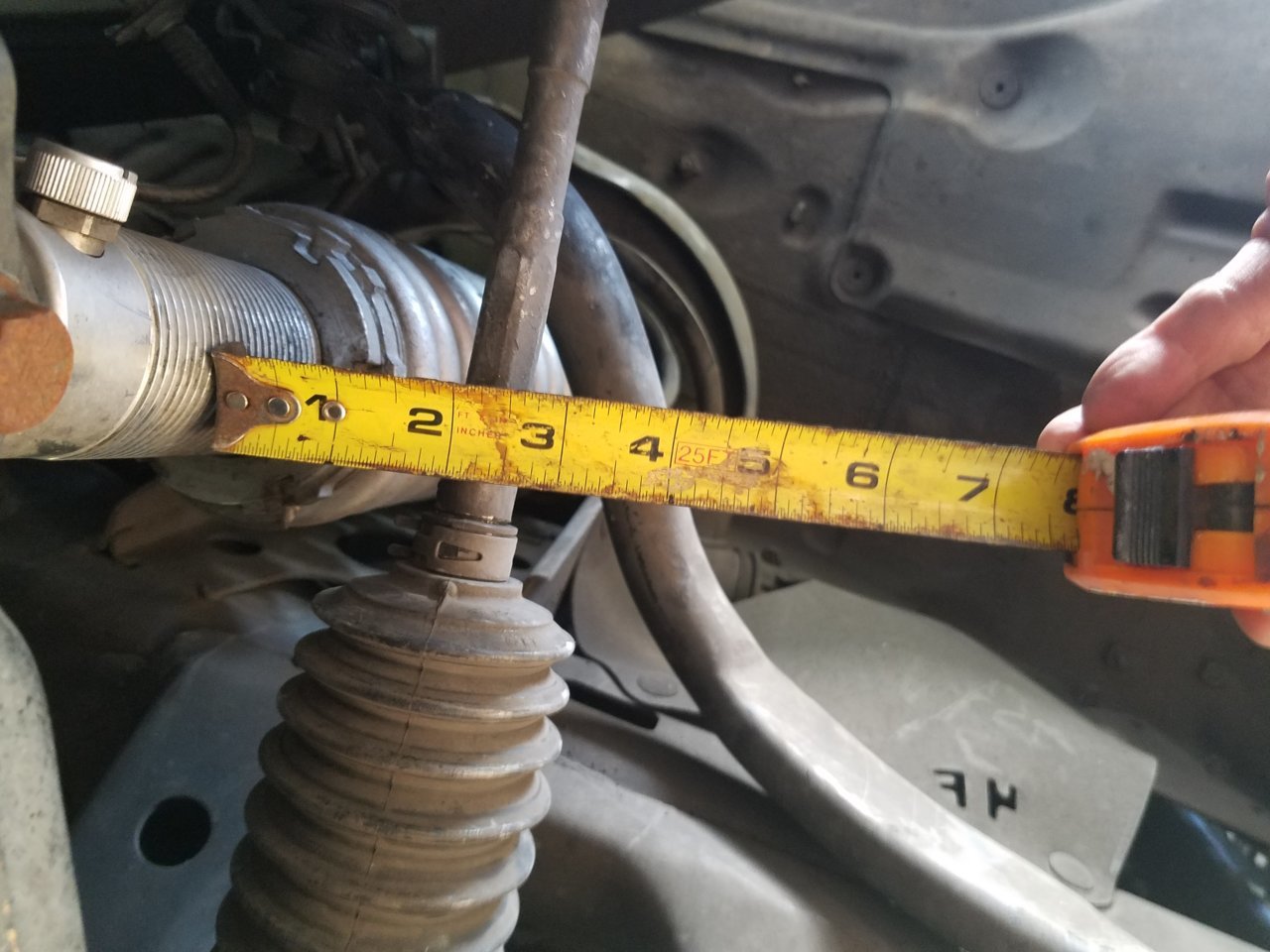

    Coilover diameter is 2 in iirc . So barely clears axle ? Also depending on adustment adjuster n
    So looks close hard to tell . So coilover is 2in od . Pretty much even with lower shock mount

    Pic off coilover to tierod maybe you can get a better idea were you at

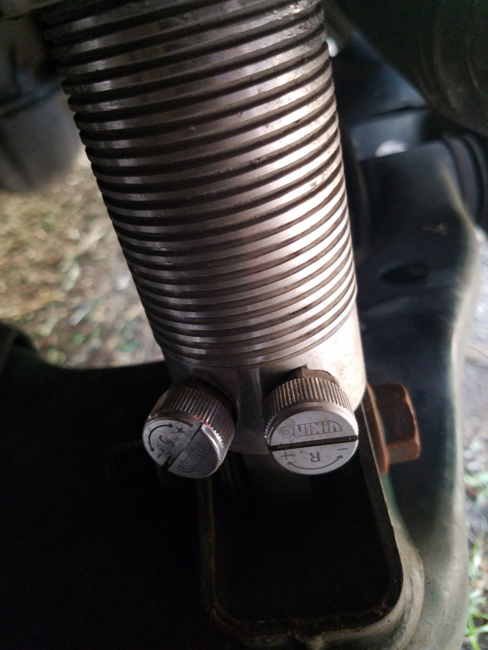

    And how far up adjusting nut is . This is about the sos kit height . I did have it 1/2 in lower but with my tires would barely scape a small section of fender liner over speed bumps so raised it to about the sos kit height .

    Thanks for the pics @hemitruk
    Looks like a tight fit. Curious how the axle changes distances if any when turning.
