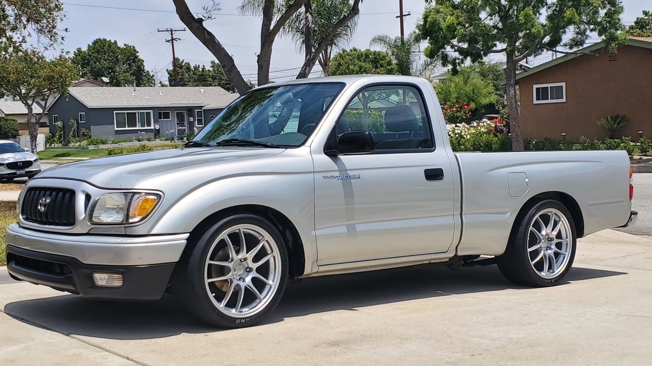

    Thanks a bunch for your feedback here @Rola2010!
    Gonna be interesting to see where I end up...

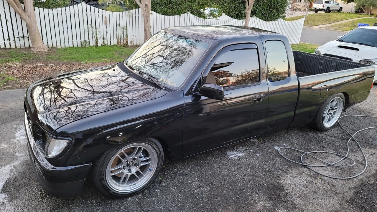

    PERFORMANCE Custom Turbo Setup FRONT SUSPENSION Drop Spindles by Aaron Carswell 01-04 Swaybar Endlinks Energy Suspension Endlink Bushings Cando Upper Control arms QA1 coilovers with 8" spring Custom 4 pot Brembo BBK Modified lower control arms with mjbfab qa1 mounting plates and Poly bushing sleeves REAR SUSPENSION Chasis Tech drop leafs QA1 adjustable shocks weld in drop notch Gas tank cross member bridge 3" angled blocks 2013 Double Cab Short Bed TRD Sport Eibach Pro Truck Shocks front and rear Lifted to the 3rd setting on the front shocks
    The truck and the next mod all finished up.

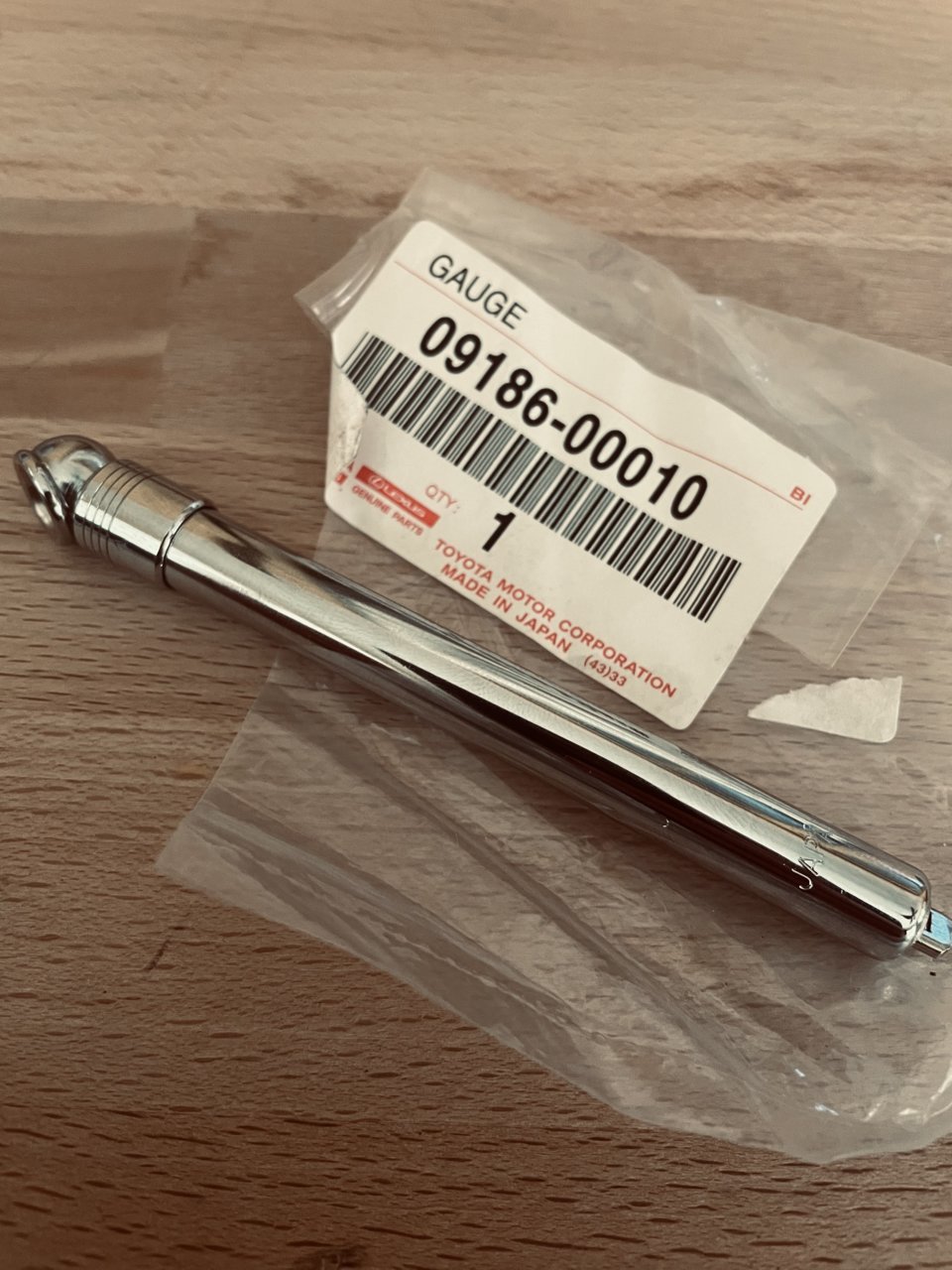

    I was looking for tire gauge and didn’t want the cheap auto zone version, came across this oem gauge, very nice quality. There is a couple on eBay but I got this one on cityracerhttps://www.cityracerllc.com/

    Dang, that’s a slick looking gauge. A bit spendy, but looks solid.

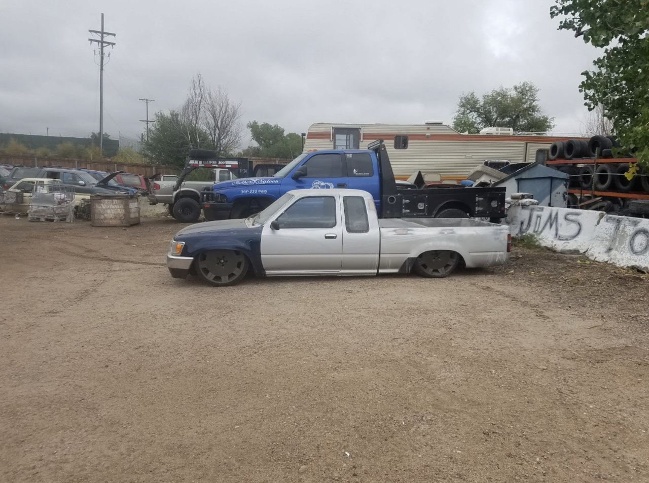

    Yota Jim’s in Denver

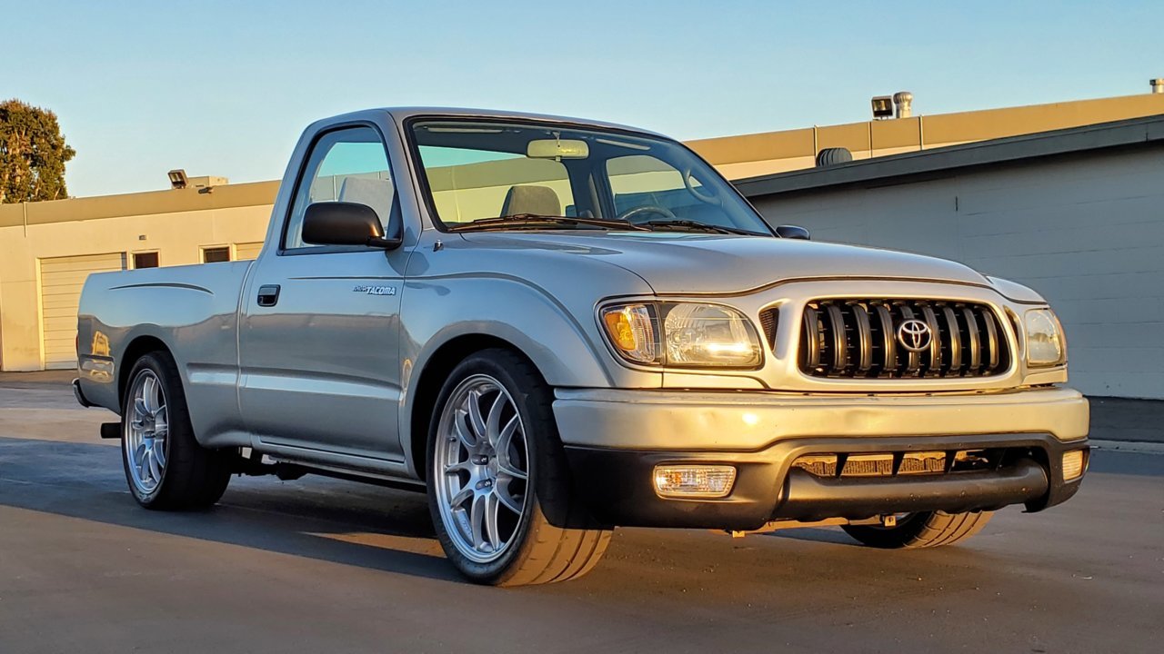

    Popped some 3mm wheel spacers on for just a dash of extra width..
    actually feels more stable!

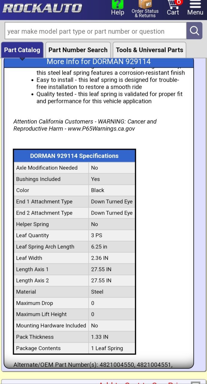

    Has anyone ever tried Chevy Tahoe leafs on a 2nd/3rd gen? They're very similar to Tacoma leafs, 5/8" shorter on each end with a 6.5" arch instead of 6". Belltech makes 3.5" lowering leafs. I'm thinking about trying it out to go back SOA and get rid of the SOS shackles in the rear. Spring load capacity is 1650lbs so they'll be a little firmer too, I couldn't find definitive info for the Tacoma but it looks like the spring capacity is somewhere between 1250-1450lbs, some HD leafs I found are 1650lbs.
    Any input is appreciated.
    ohcaltexscar and PrerunnerVsix like this.

    I have no idea if it will work, I was just scraping through models on Rock Auto trying to find an alternative spring that was flatter and I stumbled upon this. I'm considering it.
    Belltech 5960 for 2 door Tahoe https://www.belltech.com/belltech-3-5-quot-drop-rear-leaf-spring-each-5960.html
    Standard Tahoe leaf
    Standard Tacoma leaf
    ohcaltexscar likes this.

    Sounds like it’d be a pretty close match, the load capacity seems pretty close to some of the lift springs out there for the Tacoma. I’ll see if I can find the numbers for my Ironman4x4 pack.
    Depending on the makeup of that Tahoe pack you could always pull a leaf if you needed.
    Did Belltech have numbers listed for their lowering springs?

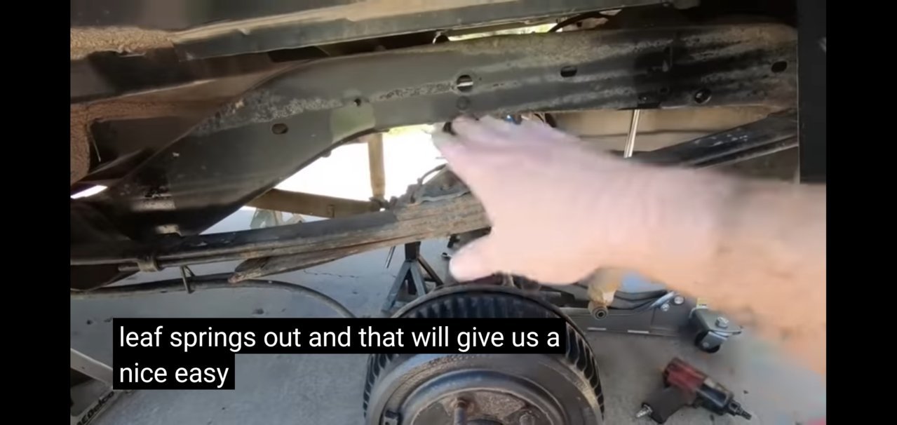

    Like most aftermarket springs, no they did not. They only state: Direct replacement and
    OEM spring rates. The only in use image/video I could find was this guy's video where he was removing them to do an SUA flip and C notch. Screenshot_20220612-103920_YouTube.jpg

    IDK but I think the most difficult part about the spring swap is going to be the width of the domestic spring versus the import spring width. Hope you can wedge domestic springs in the front bracket on the Tacoma. :notsure:
    Good luck!

    Was that guy’s video on a Tacoma?
    That’s a good point I hadn’t thought about. That may require modification to fit the wider eyelet.

    If I remember correctly the stock bushings are around 2.75" wide, I'll have to measure.
    The video is a Tahoe
