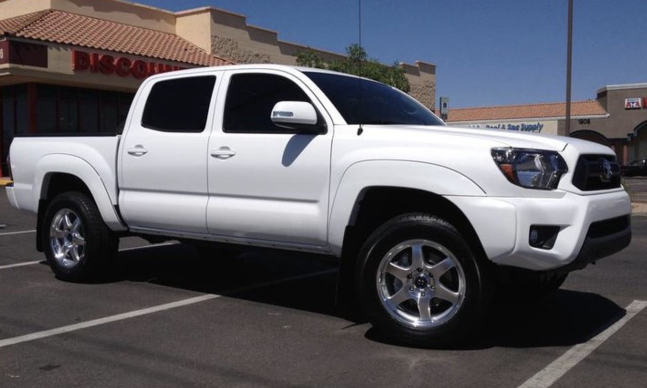

    We had these (Enkei’s ST6) in the 18’s with a 20 inset. They have a matte gray & 20’s but they are pretty wide @ 9.5”
    https://enkei.com/shop/wheels/truck-suv/st6/

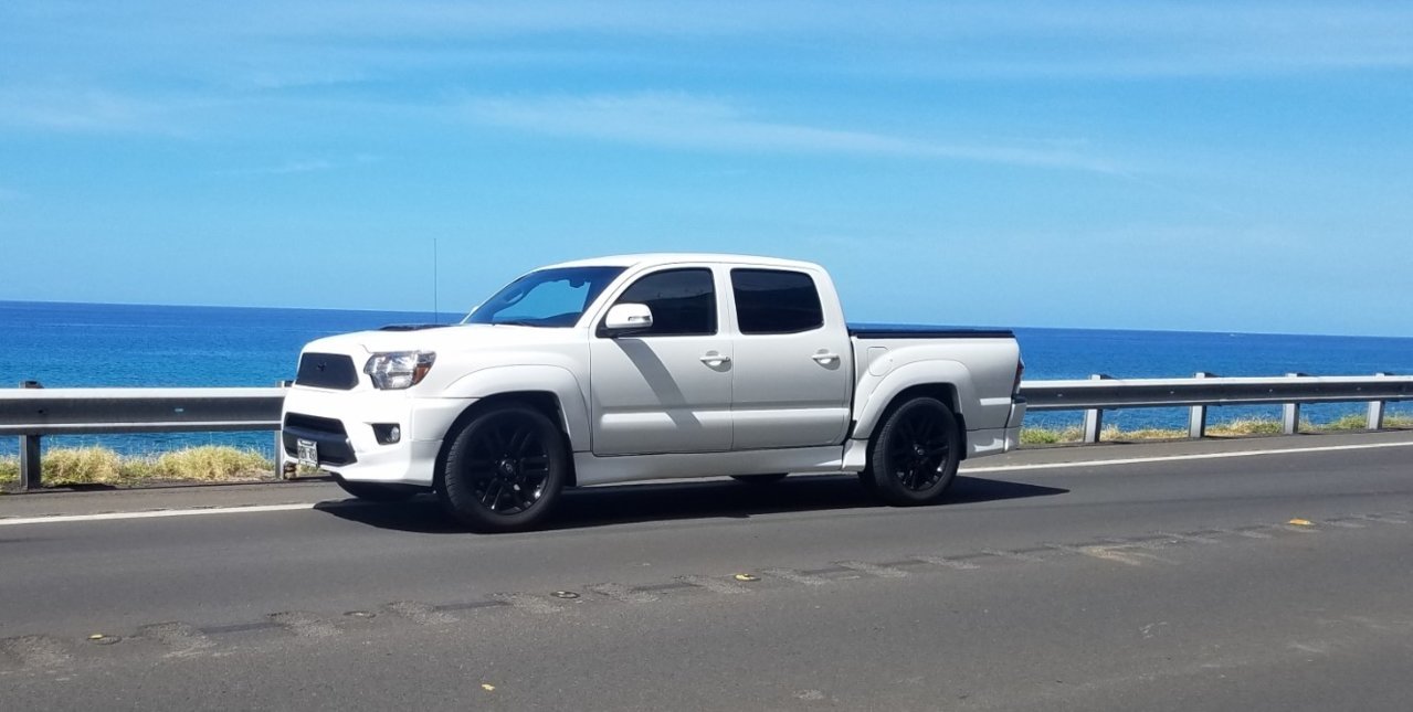

    Yea .I like it . 20 x 8.5 replicas black powder coated .

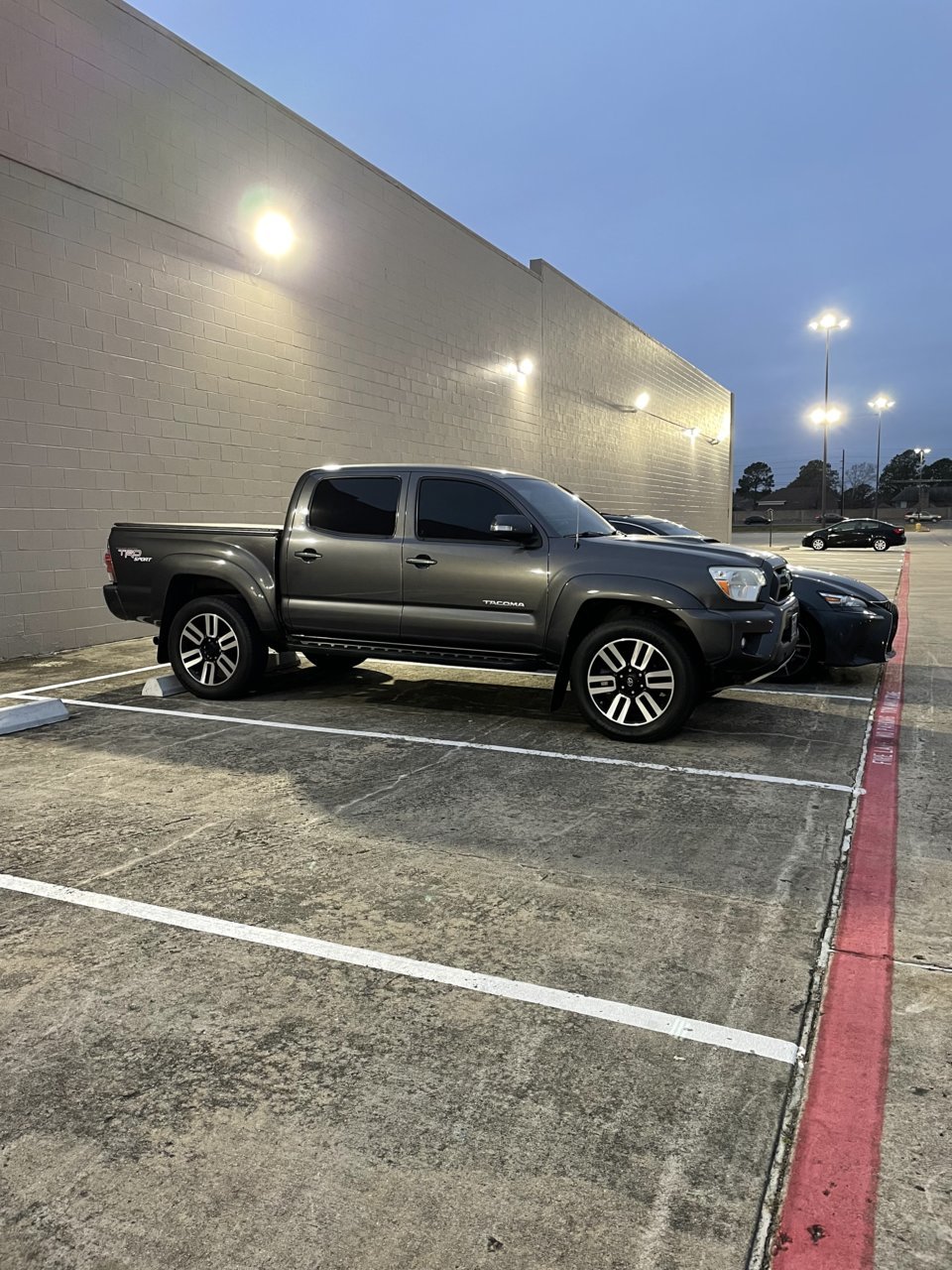

    The oem ones are pretty damn narrow I’ll admit but I don’t really mind since im running the stock tires too.

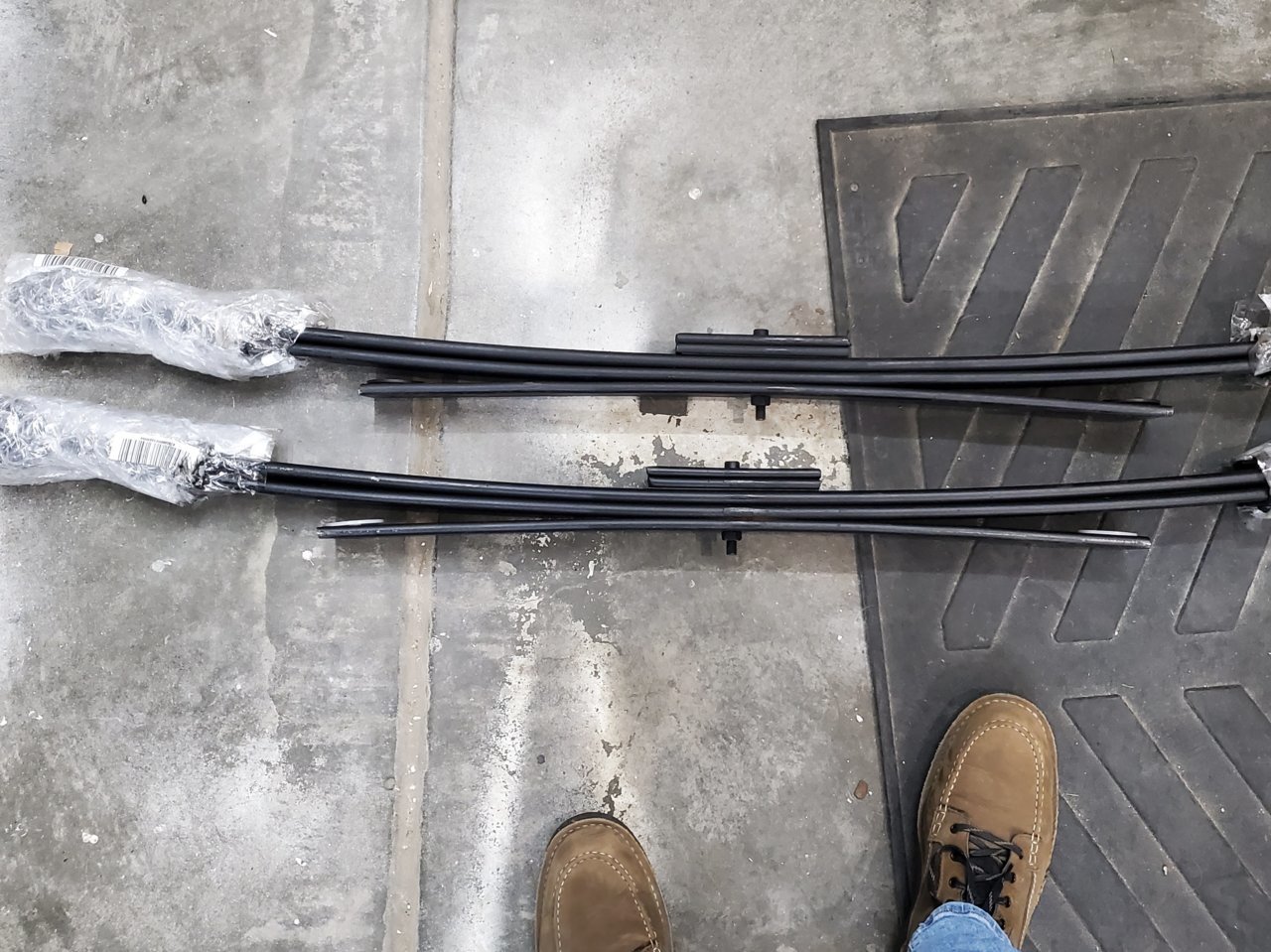

    Tahoe springs came in, probably won't do any testing for a while. If I confirm they fit in the hangers I'll need to get some bushings. Will also need to flip the leaf spring bolt. Anyone know what the short leafs on top are for? Almost seems like they are intended for SUA.

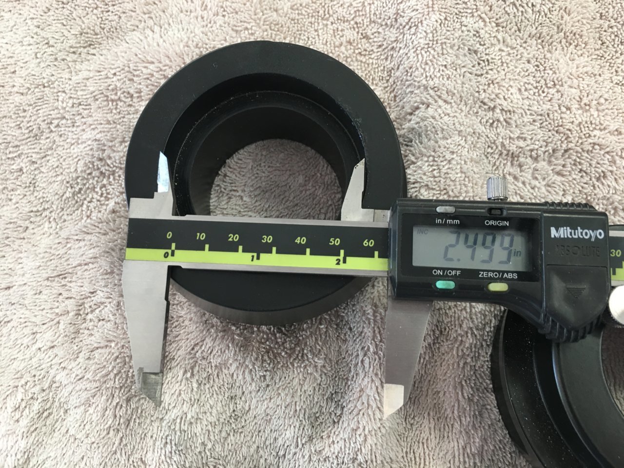

    The short leafs are the same as using a block with under mount leafs I’m guessing.

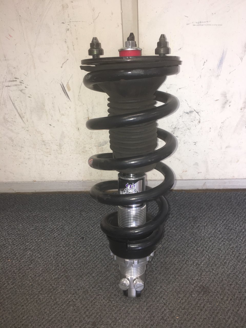

    Any 2nd Gen guys looking to do front coil-overs the easy & fairly cheap way?

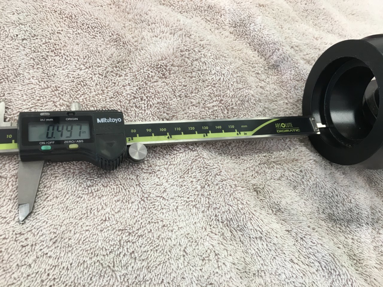

    The spring not loaded / adjusted in the photo just below. The part you need is at the bottom of the stock spring. It’s been machined to fit over the top adjusting collar then powder coated for corrosion protection. Also the way the aluminum spring perch is machined it adds a bit of spring rate, as it “coil binds” the bottom of the spring. Making the active spring shorter, there for stiffer. You will need to run spacers/ washers at the bottom shock mount. As the factory shock location is right at .250 wider than the QA1 or Viking shocks.
    Edit; Sorry guys the spring mount at the bottom of the spring is no longer available from me!!

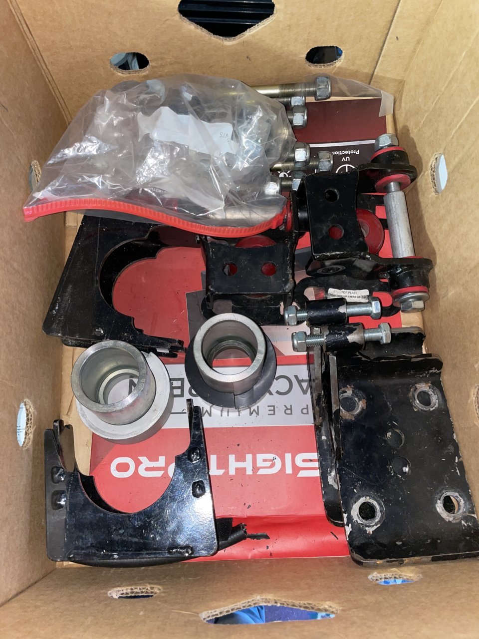

    What kit is that???

    Why 6 lug only?? I don't get it

    It’s for the 4x4 and prerunner trucks, it moves the axle from below the springs to on top.

    It doesn't do that for the 5 lug 2x4

    Yeah 5 lugs come factory spring under
